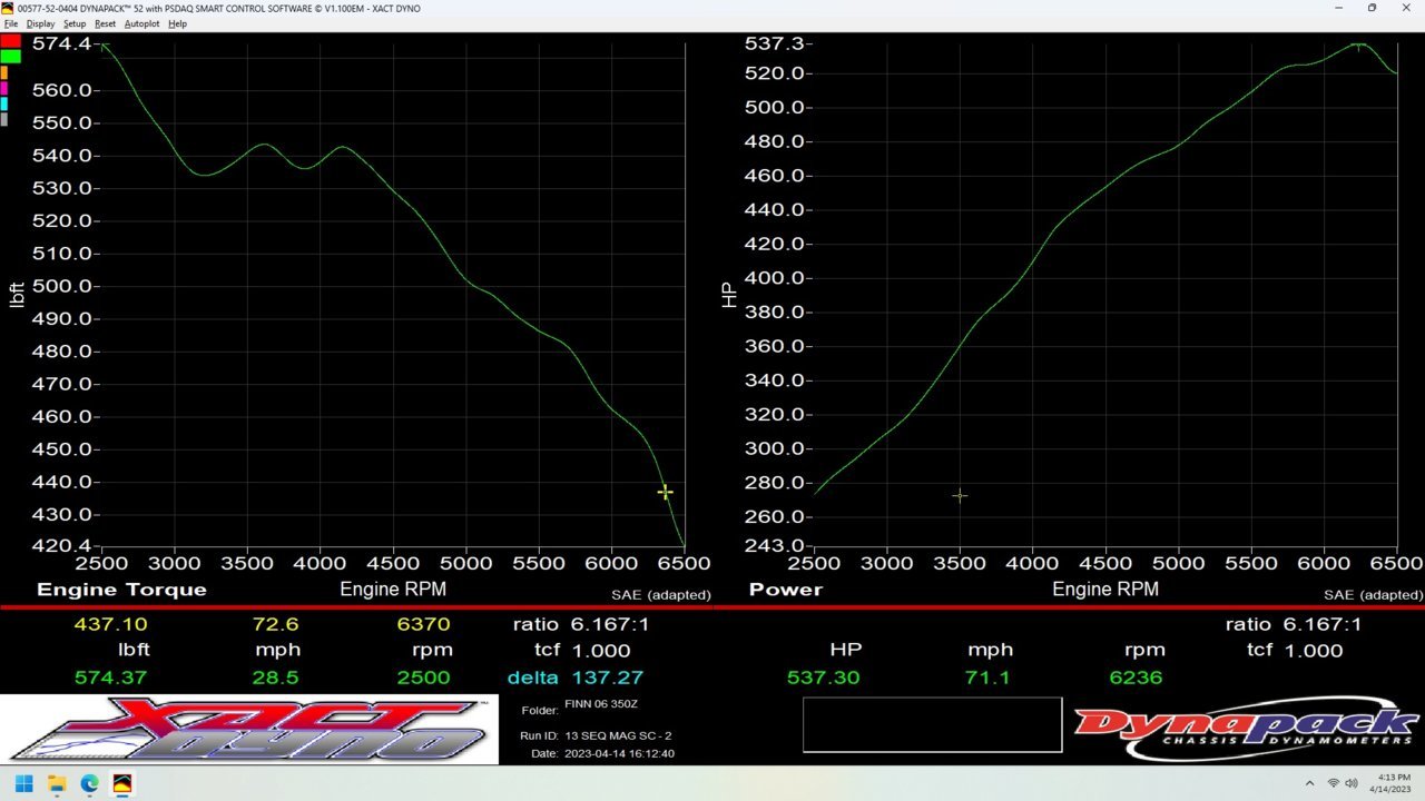

    Just got done!

    We will be starting the PS fuel system in my truck Monday morning. I will be setting the FPR to 60psi as they recommend in the instructions. I have 750 injectors and a 450 fuel pump, luckily no extended crank issues.

    Nice numbers!

    How was the a/f?

    Nice!! I'm jealous

    Hot damn, that 574lbft at 2500 rpm. Tires don’t stand a chance!

    Afr is 10-11. He said the belt was slipping. It could have been higher

    How is that determined, does it polish the ribbed side, or leave a bunch of belt dust? I wouldn't guess it would be audible with all the other noise going on.

    The boost graph showed as wavy at wot. He said it meant it was slipping. :dunno:

    I asked for the graph.

    Did you ever give installing the green belt another try? Wondering if that may help with the slip if you are still running the stock size belt.

    Nope, guess it needs to go on when I install the 2.2.

    Curious if there will be another dyno run after the 2.2 is installed.

    I've been planning on designing a bracket or something to add an additional idler pulley to increase the belt wrap and allow more belt options for the smaller pulleys. Sounds like I need to get on that sooner rather than later.

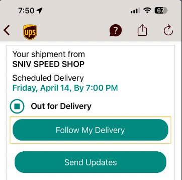

    He said I can go 2.2 no problem. We'll see. The pulley is still "out for delivery by 7pm" except it's 7:50.
    Lol
