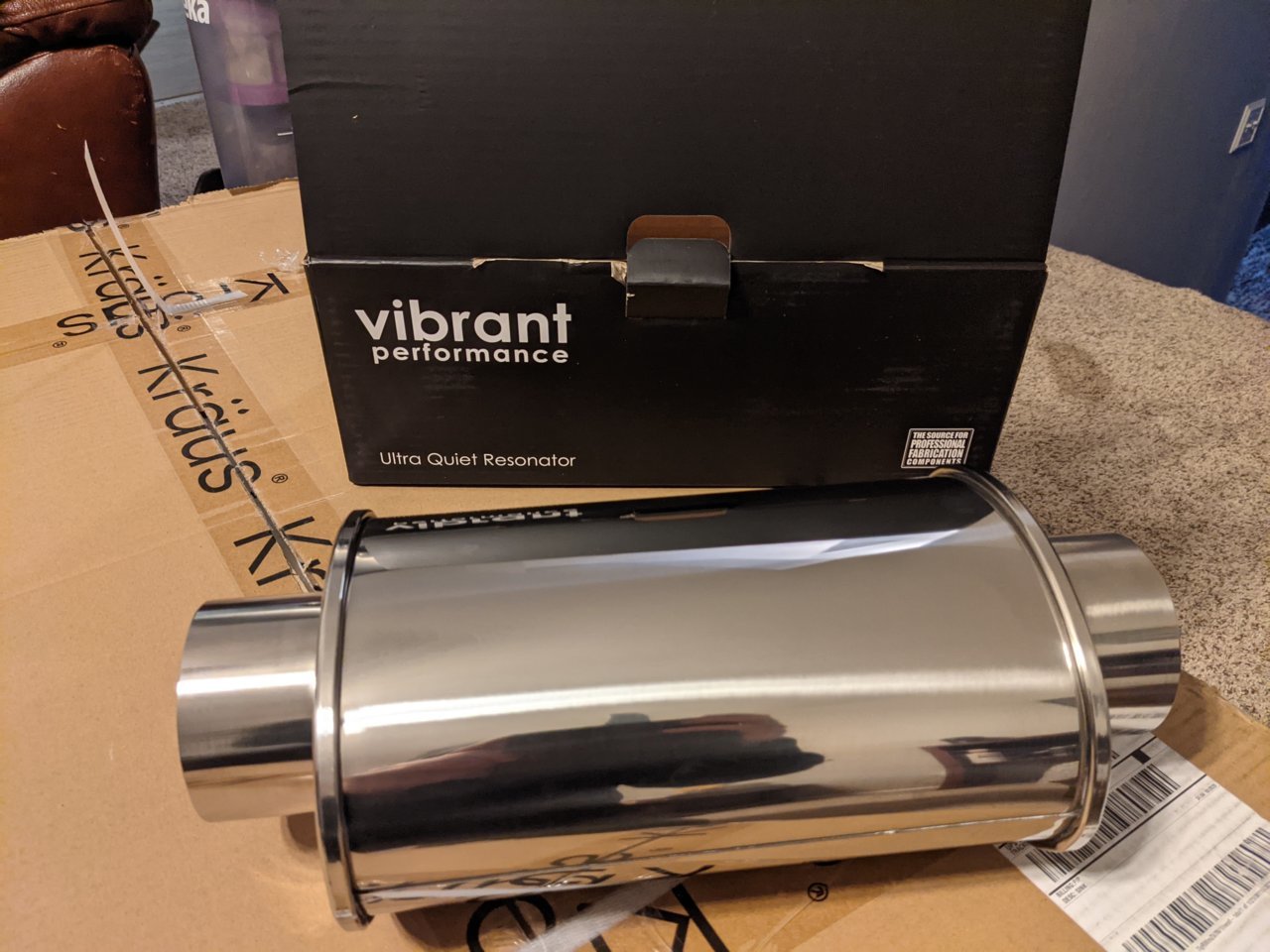

    I added this to my Tacoma, just before the muffler, when I went to long tube headers that deleted the primary cats. Kept the secondary cats. It made a pretty good difference in mellowing out the loudness
    https://vibrantperformance.com/ultra-quiet-resonators-v1249/
    Edit: it was pretty too!

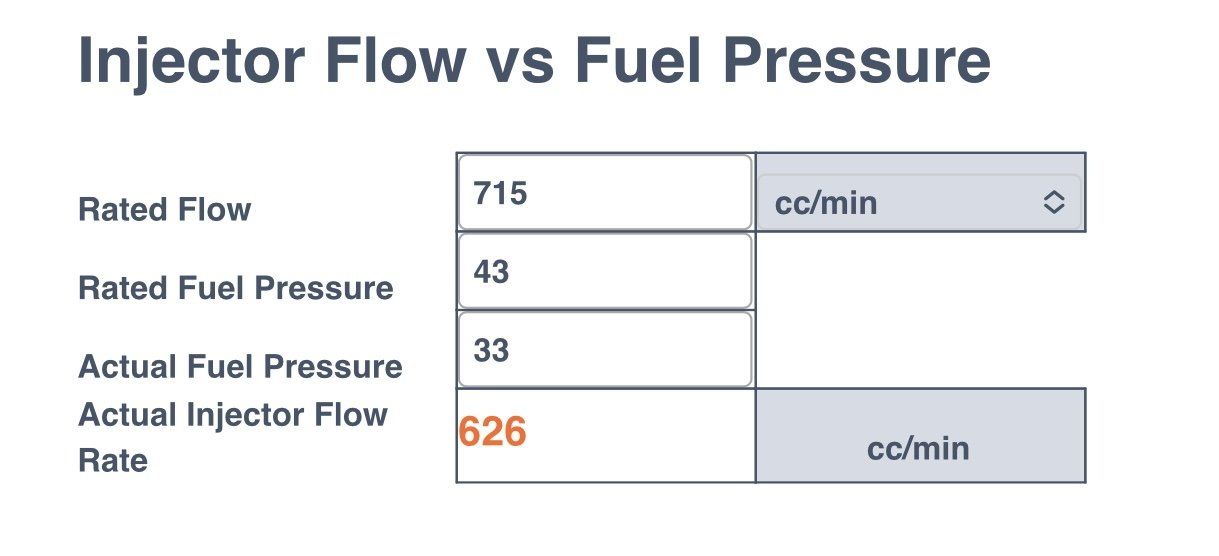

    But say that you had more than enough injector for it to be a non-issue. Would it be worth the time and effort to "fix a problem that doesn't exist"; exceeding the suggested threshold of 85% Inj DC? For example, I've yet to see an Inj DC above 65% with the 750s at WOT, starting issue aside (which I mention because I've made zero progress and have no ideas on sorting, just venting:rolleyes:). :monocle:

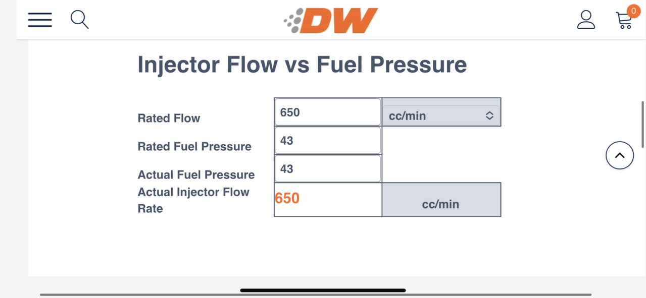

    Well that's my exact reason I've never boost referenced the regulator, if I did it wouldn't really change anything. The duty cycle would drop, but I only go over 80% when I go to low elevation and I've been fine with 95% duty cycle for those couple times a month the truck sees WOT down there. I'm lazy, I'd have to buy a tee and run more hose and retune the truck and at the end of the day nothing would really change besides the injectors being happier for about 30 seconds a month :D it'd be good to do, but as you say it's fixing a problem I don't really have since I have big enough injectors to make up for it.
    But I think the takeaway is 650s are fine for even "high boost" applications if they're boost referenced. Unreferenced 715+/referenced 650s can handle around 11psi (on a Magnuson), and if you push more than that you need boost referenced 715+.

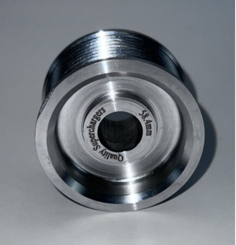

    What’s everyone seeing for boost on the smaller pulleys? Are we saying 10psi is probably the threshold
  12. Apr 13, 2023 at 8:16 AM
    #7542
    e30cabrio
    Oct 20, 2017
    #10410
    6,125
    West Valley, Phoenix, Az.
    Boosted 2013 Sequoia TRD FAUX

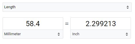

    I have seen 9.9 on the 2.3 without proper fueling. We'll see tomorrow on the dyno what I have.
    Actually, it's not 2.3...
    lol
