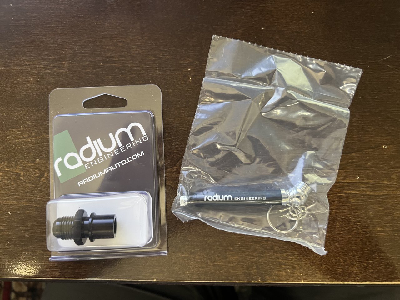

    These came, don't remember what the adapter is for. lol

    Converts fittings on top of fuel basket to -6AN, need one for feed, one for return if replacing the lines both ways.
