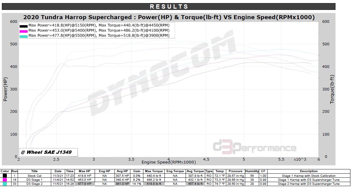

    as promised...notice TQ is moving higher @ lower RPM.

    Wow those low RPM gains are massive. That must feel like night and day from no tune.

    Stage one tune is necessary and worth it
    see my graphs
    you can live without it. I did. For a while
    And yes. You can revert
