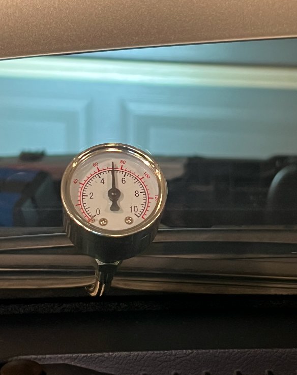

    I think it was coincidence. I erred (too bad for me) on the side of caution, not wanting to clamp down too hard & possibly cut the line on the hoseclamp at the pump. It slid off when I opened the basket so I can only hope that was it. I made sure it was all the way down & gave it more pressure. The full tank allowed a slew of gas out when I opened the hatch so after cleaning that up, reassembling the basket & dropping it in, I'm cleaning gas of me having some coffee then I'll go back out & see what is up. Hopefully, that is it, I ordered a foot of proper hose from Napa in case I need it for pickup when they open at 9, hoping not to need it, thieves are charging 50 bucks!

    Back to having pressure. I need to button it up. Hopefully for the last time.

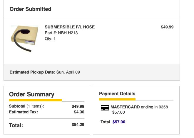

    Butond up, lost fuel sender GAAAAAAA. I know I connected it but apparently not tightly. Not pulling the tank again today, it is full, I'll fill it in 200 miles if I don't drop it again before.
    Going to pick up the 50.00 hose & see whats what.

    Went to Napa for the golden hose, the truck is amazing!
    It’s over 60lbs fuel pressure at all times, goes up in boost, went down to 8.7 (that I saw) afr & peak boost 9.4 It's not bogging, feels amazing and apparently I never really felt it the way it shoud be.
    0 & the fuel gauge decided to come back to life.

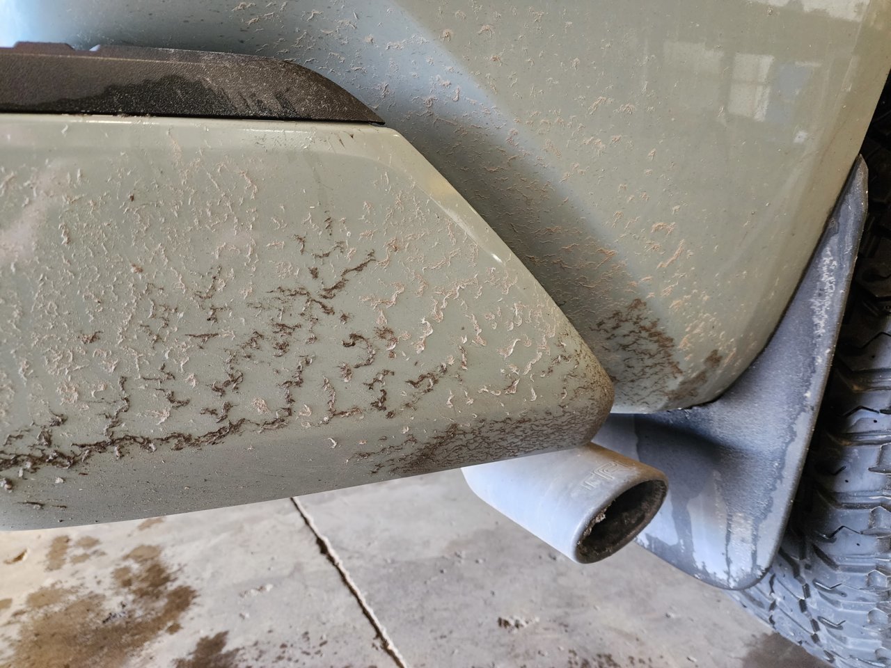

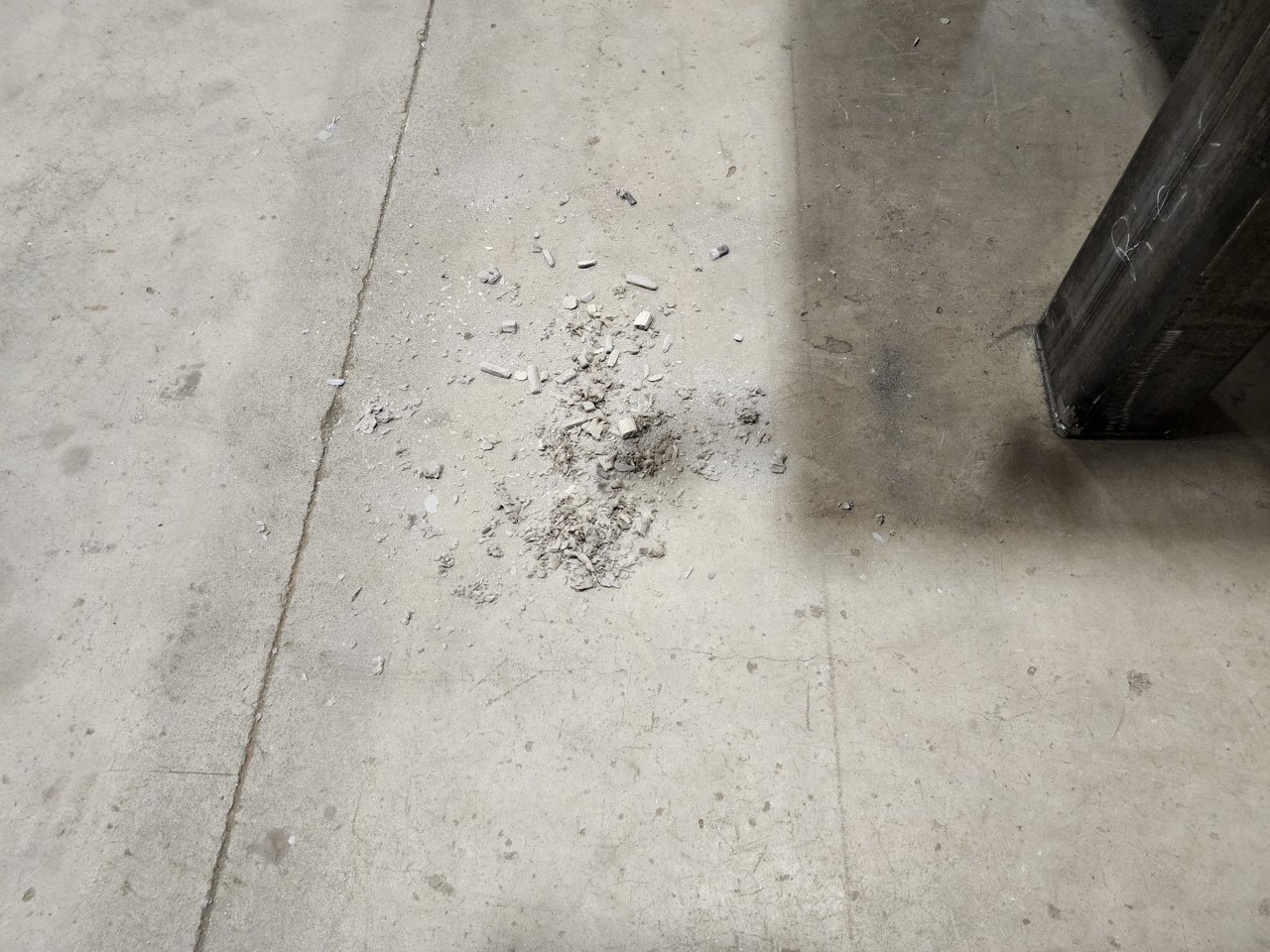

    Regarding symptoms I experienced..
    CEL came on after I hit it at a stop light and looked in the mirror to see a cloud of white smoke/dust. Proceeded to get on the freeway and the truck didn't accelerate when I gave it ~75% throttle. Got to work and I heard the fronts rattling followed by both my tail pipes almost clogged with the honeycomb shit

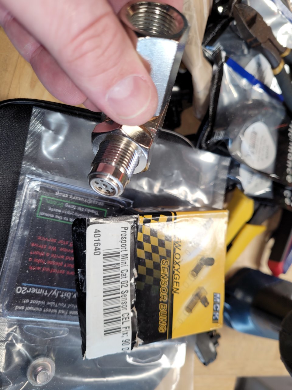

    O2 sensor spacers?!
  30. Apr 10, 2023 at 7:00 AM
    #7470
    armyoffoo
    armyoffoo Member
    Jun 4, 2018
    #15876
    1,474
    Cypress, TX
    2018 Black TRD Sport CrewMax
    Supercharged with all the trimmings
    Something like this, moves the sensor out of the exhaust stream, kind of tricks it to thinking the cats are still there by getting reduced readings:
