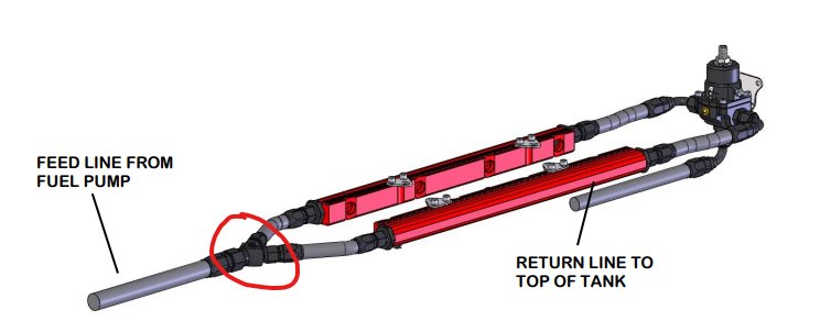

    It occurred to me I don't seem to have what I need to go from the basket. Which fittings do I need?

    Are you replacing the fuel lines from the basket to the rails, or only changing the engine-side to dual feed, dual return?

    I ordered the list from M3Tundra, that is just the rails? If so I'm done.

    I don't think I got everything on that Amazon list right, I'd try and go more off the ViktorG sheet that was posted instead. It's why I eventually returned all the custom stuff and just ordered the Prospeed kit
