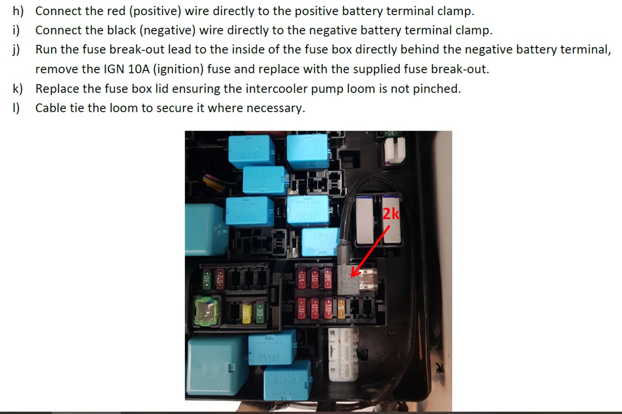

    This is from their instructions:
    e30cabrio[QUOTED] likes this.

    Cool except I have 2 taps there. The first is my 18+ Sequoia headlights. :p threes company!
    Lol
    armyoffoo likes this.

    Well, the good news is the voltage trigger for the relay doesn't draw much power, so you might be good....I haven't run into any issues yet...

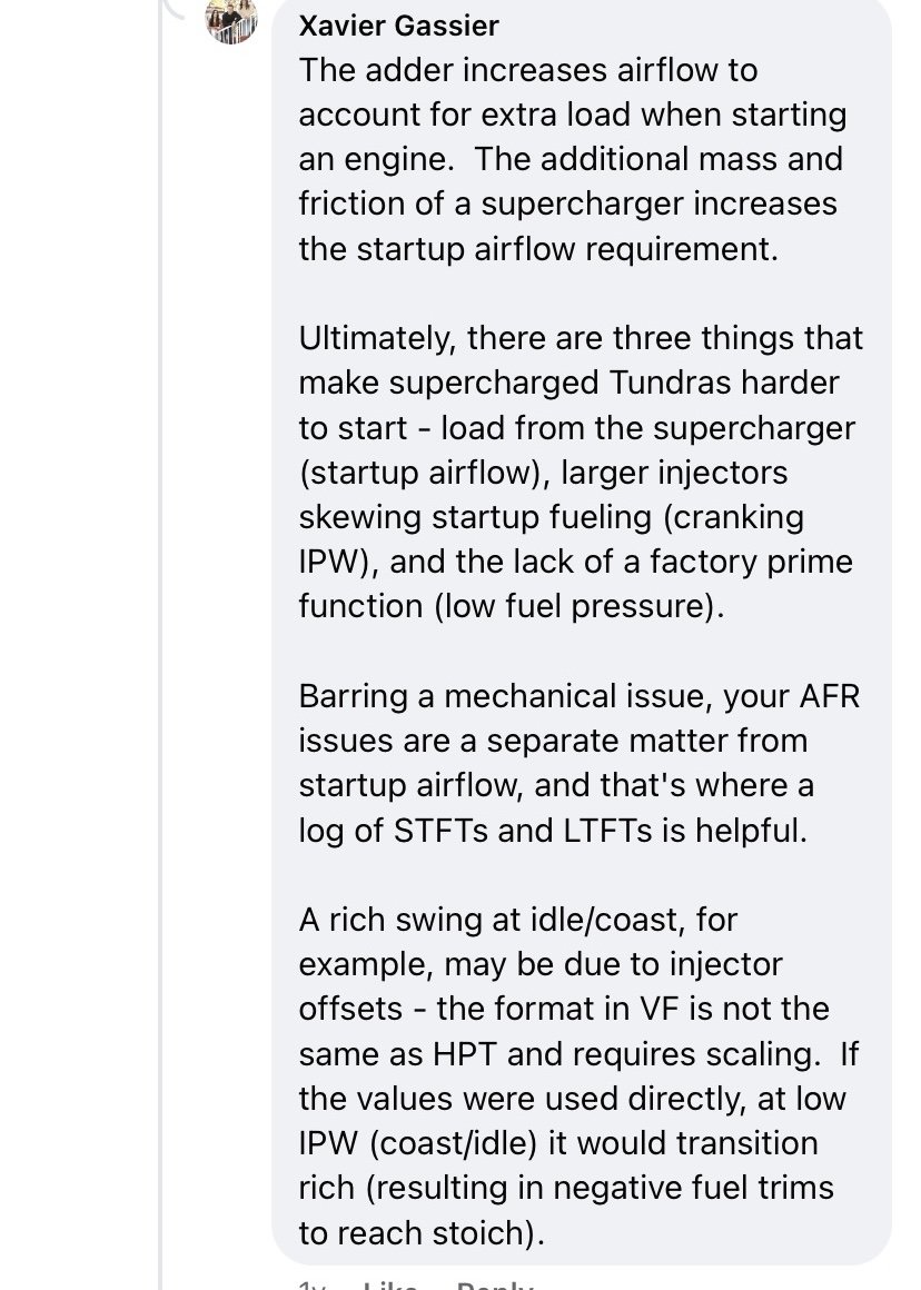

    This is kind of what got me to wondering if it's influencing the long crank times that I'm seeing. I'm wondering if a smaller value would result in less fuel during cranking, as it seems I'm seeing too much and getting blue smoke from the tailpipe when my truck does eventually fire. There's also a recommendation from one of the folks over at HPT forum to not calculate the injector constant, but rather to adjust it until you're seeing 2-5% rich (on the LTFTs I assume) and then adjust the MAF from there. I may give this a try this weekend to see if it gives me better starts. These long rich cranks have me kind of paranoid that I might be washing the cylinders walls with fuel. Could be unfounded though...
    snivilous[QUOTED][OP] likes this.

    That's what I was thinking. Adjust the constant, that would effectively change your cranking fueling which most of us can't adjust otherwise, then MAF to get LTFTs back in place.
    In regards to the forum post, that does make sense but I've never done that since I didn't adjust anything besides the injector constant when I upgraded and it was correct out of the gate using the scaling method. So I've never thought about it outside of that, but it would make sense.
    What I've wondered is when the MAF flow values get maxed out, can you decrease the MAF values and decrease the effective injector size (ie increase constant) at the same rate? Ignoring the potential cranking fueling limitations, would that allow the MAF to come back into range? Maybe scale the desired air load tables so air load, injector, and MAF values all stay proportionate to each other but can they move up and down without affecting other systems?
