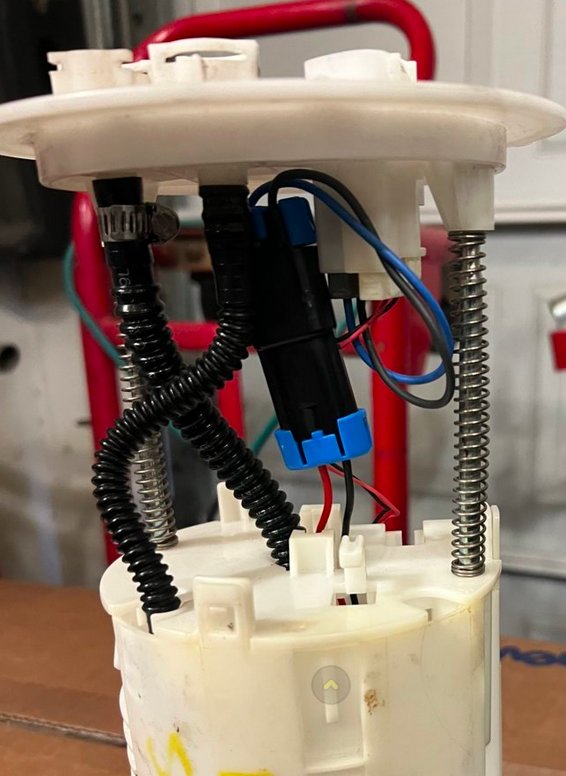

    No, you will have to drop to get access to the fuel basket wiring. You will also need a way to get the wiring into the basket to the pump. I would recommend bulkhead terminals, small hole to drill.

    I believe it gets plugged in before the fuel pump. My shop did it at the time of doing some other stuff. Totally fixed the issue for me.

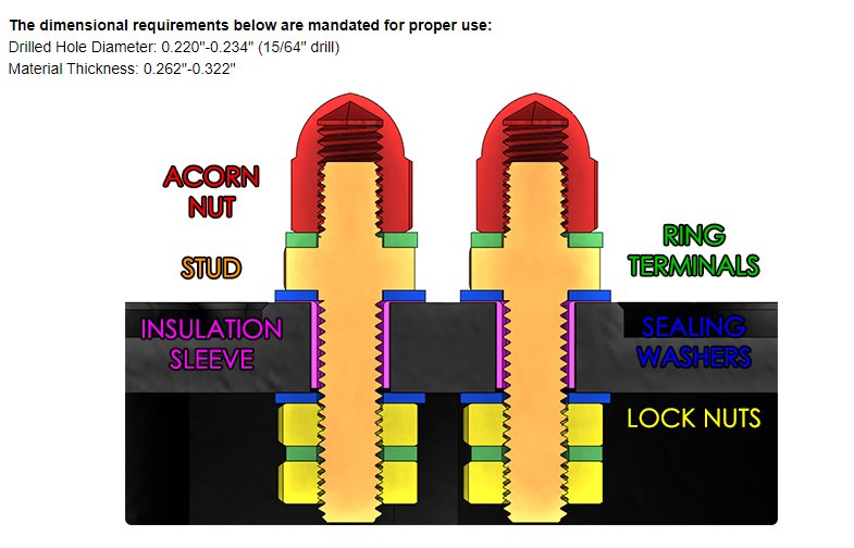

    Small hole in the top of the basket & splice into the harness?

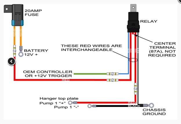

    85/86 power from fuse, power to pump
    "It is recommended to connect the “TRIGGER” wire to the ECU fuel pump
    relay output which has a fuel pump priming attribute and a safety feature
    which disables the output typically when engine speed is 0 RPM."

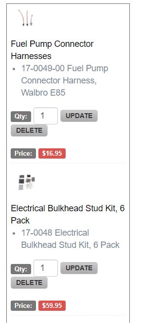

    Based on my pump part number this is the harness. Other than the bulkhead kit do I need anything else?

    Just a 15/64" drill bit for the holes. I would suggest drilling from the underside so you can be centered between the ribs and leave enough room for the washers/nuts/terminals to thread onto the studs.
    The insulation sleeve will be too thick to seal against the top hat of the fuel basket, so it will need to be cut. I lined mine up with the side of the top hat and cut flush with a razor blade.

    Thanks, ordering.
