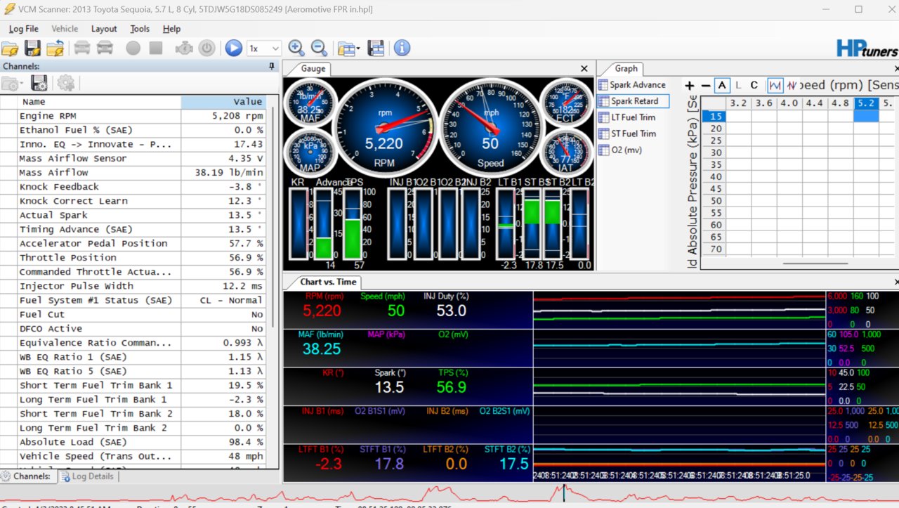

  2. Apr 3, 2023 at 9:05 AM
    #7172
    armyoffoo
    armyoffoo Member
    Jun 4, 2018
    #15876
    1,474
    Cypress, TX
    2018 Black TRD Sport CrewMax
    Supercharged with all the trimmings

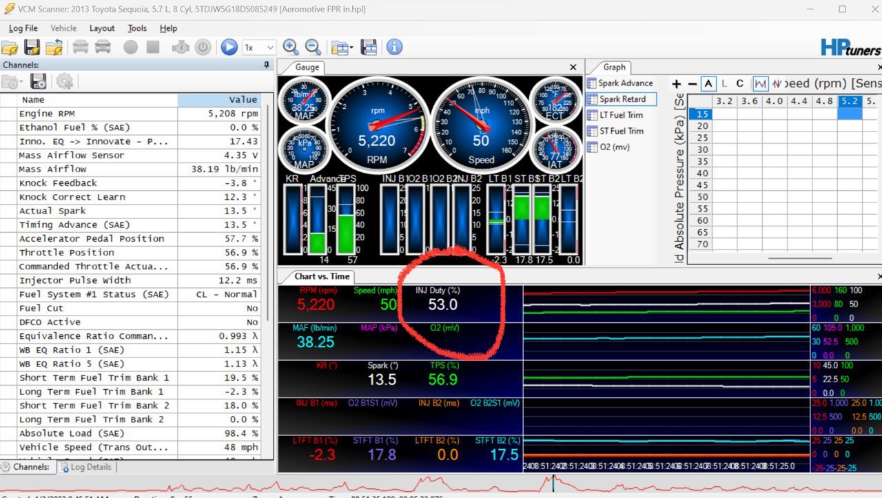

    What is your injector duty cycle at after replacing the FPR and bumping up the pressure to 60?

  4. Apr 3, 2023 at 9:15 AM
    #7174
    e30cabrio
    Oct 20, 2017
    #10410
    6,507
    West Valley, Phoenix, Az.
    Boosted 2013 Sequoia TRD FAUX
    I just did a drive I'm sending Tim. Where can I see that?

    Did you delete the FFV switching/control valve and that separate regulator entirely? I wonder if the higher pressure from that big pump is just pushing by the diverter valve and dropping your pressure off at the rails.

    Apparently, I'm dumber than a caveman, as that is scary obvious (injector duty) I was looking on the left :( thanks
    The relay is removed, do I still need to delete it? I can ask Tim if he did, I told him it was an "ex" FFV.
    Do you mean mechanically remove the FFV Valve? if so, yes, the hose is removed & only return & fuel hoses are connected, it is still electrically connected, I followed a thread here to accomplish that.

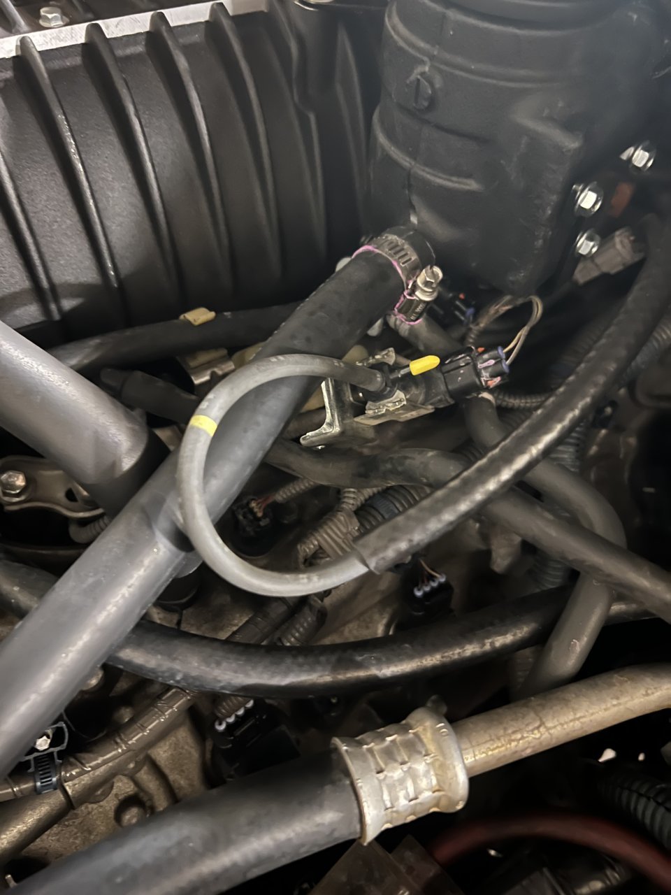

  18. Apr 3, 2023 at 11:27 AM
    #7188
    e30cabrio
    Oct 20, 2017
    #10410
    6,507

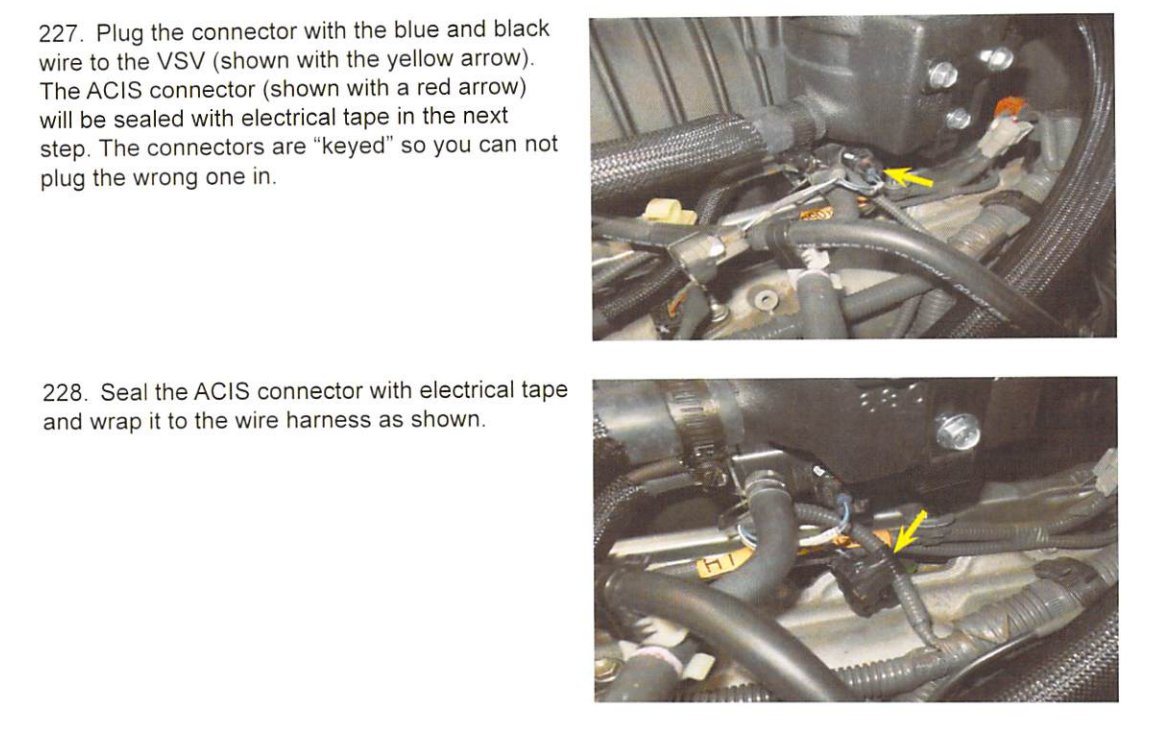

    The valve that actuated the plenum on the back of the OEM intake had nowhere to connect so was only electrically connected, I gave it vacuum from the intake & pressure stays over 45 & AFRs (revving in my driveway) stay under 15. (14.7 at redline, 14 sitting at 5500)
    HulkSmurf14, Silver17 and AZTundra like this.
  19. Apr 3, 2023 at 11:38 AM
    #7189
    armyoffoo
    armyoffoo Member
    Jun 4, 2018
    #15876
    1,474
    Cypress, TX
    Ahh, so you had a vacuum leak all along...that explains it. I'm not sure about the Magnusson, but that's the ACIS and is eliminated on the Harrop.

  20. Apr 3, 2023 at 1:19 PM
    #7190
    e30cabrio
    Oct 20, 2017
    #10410
    6,507

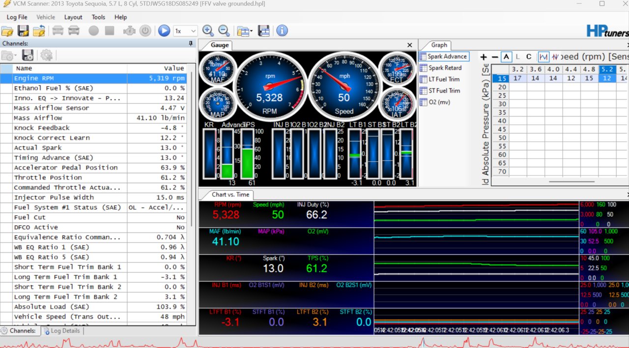

    No leak, just nowhere to connect (no mention in my instructions I saw) I connected it electrically. I'm just trying to weed out any possibilities so gave it vacuum.
    I just sent Tim a new file after these changes.
    This is with the Flex pump relay grounded & the loose plenum switch getting vacuum. Fuel pressure is not going under 40.
    M3Tundra-JK likes this.

    Oh, I see, it was plugged in but no hoses attached? So there was no leak, but also no vacuum signal? Also, that is not needed for a supercharged system, so you can remove and tape the electrical connection.

    Yes, I reviewed the Magnusson installation instructions and it's not used.

    Thanks, yup, no mention I saw but as I had no clue I left it. I figured they would have said dump it if that was the deal.

    No Problem, they jump around a bunch in the instructions...they have you remove the VSV from the Stock intake and attach to the reservoir bracket, but then have you connect all the coolant hoses before plugging it in:
    ...And then 80 steps later...

    I'm hanging my head in shame, unfortunately the issue is not resolved.

    Ask your tuner at what rpm the ecu switches over to power enrichment. Stock is 70%, I think. Mine is tuned to go into PE at 35%. If yours is set at 50 you may not be into the throttle enough to make it switch. Revving it is not going to be enough, you need a load on it to check the fuel supply. Injectors and pump are plenty big enough. It is difficult to mash the throttle more when the AFRs are lean. I know that from my Harrop and the stock tune. It was lean as hell until I really got on it, until I had it tuned. FWIW I am running the stock FFV pump, Stage II pulley with LTH and mine stays at 10-10.5 up to redline. I don't even have a FP gauge but I did change to the boost referenced regulator that came with the Harrop. Just thinking.....Best of luck.

    He sent this response from my read this afternoon.
    in the last log it was still in closed loop so ecu was keeping afr at 14.7 takes 60% throttle to get open loop. which i'll probably lower to 50
