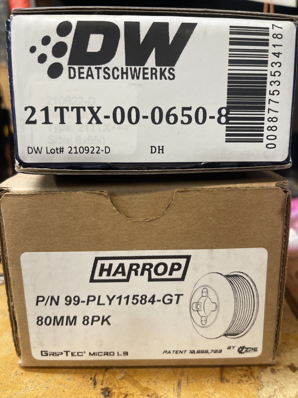

    these are the injectors (top) pulley (Bottom)

    dyno graphs on Monday
    ~9psi avg for stage 2

    those new injectors seem to be standard fare for off-road Tundra folks.
