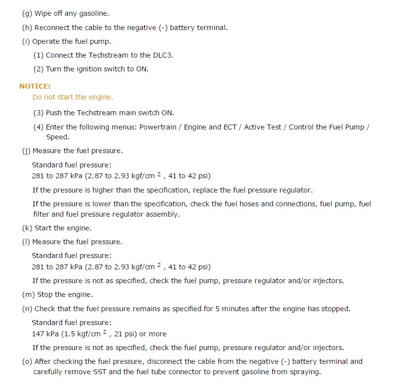

    Thanks for the feedback, that's how it's supposed to behave. Mine drops to 0 instantly. Some googling seems to suggest that the FPR diaphragm may be bad, or going bad, which would also impact fuel pressure at higher RPMs. Other people on car forums with instant pressure drops are reporting the same extended cranking as well, since the fuel rail isn't at pressure and the pump takes a few seconds to get it pressurized.
    Mine has done the drop to 0 since the day I installed it. I assumed it was a result of replacing the stock FPR/rails/pump/lines with ProSpeed's fuel package, but my high RPM fuel pressure issue might have been the FPR all along...

    Stock behavior for reference, should maintain half pressure for at least 5 min after engine off:
    e30cabrio and M3Tundra-JK like this.

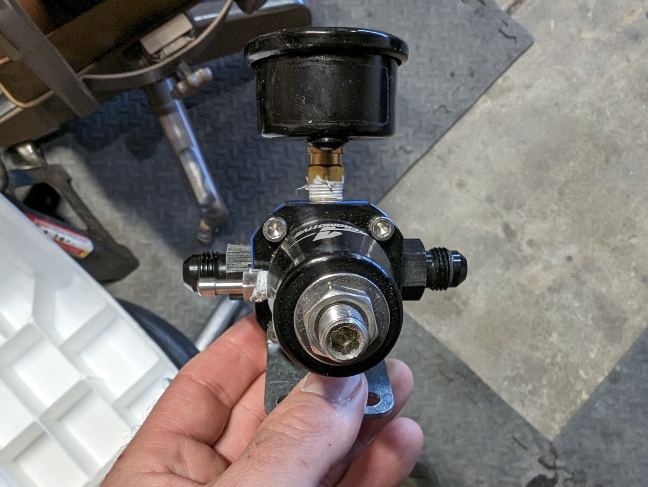

    I don't know how it reacted on first install, but when I was troubleshooting I did take apart the AEM FPR and then reassemble. It seemed like the rubber gasket was originally hanging over the edge of the body of the FPR. in theory meaning it was seated too tight and didn't leave any room for the diaphragm to move appropriately. When I reassembled it, I made sure to get all edges of the diaphragm even with the body of the FPR.
    Idk if that was/wasn't even an issue, but the FPR seems to be stupid simple inside
    armyoffoo[QUOTED] likes this.
  9. Apr 2, 2023 at 10:13 AM
    #7149
    M3Tundra-JK
    M3Tundra-JK New Member
    May 3, 2022
    #77930
    2,759
    Scott
    2005 GX470
    You can kinda see the blue diaphragm sticking out the side a little. I just tried to make sure it was as even as possible
    e30cabrio and armyoffoo like this.
  10. Apr 2, 2023 at 10:48 AM
    #7150
    armyoffoo
    armyoffoo Member
    Jun 4, 2018
    #15876
    1,408
    Cypress, TX
    2018 Black TRD Sport CrewMax
    Supercharged with all the trimmings
    Yeah, there really isn't much to them, I need to yank mine out and take a look at it.
