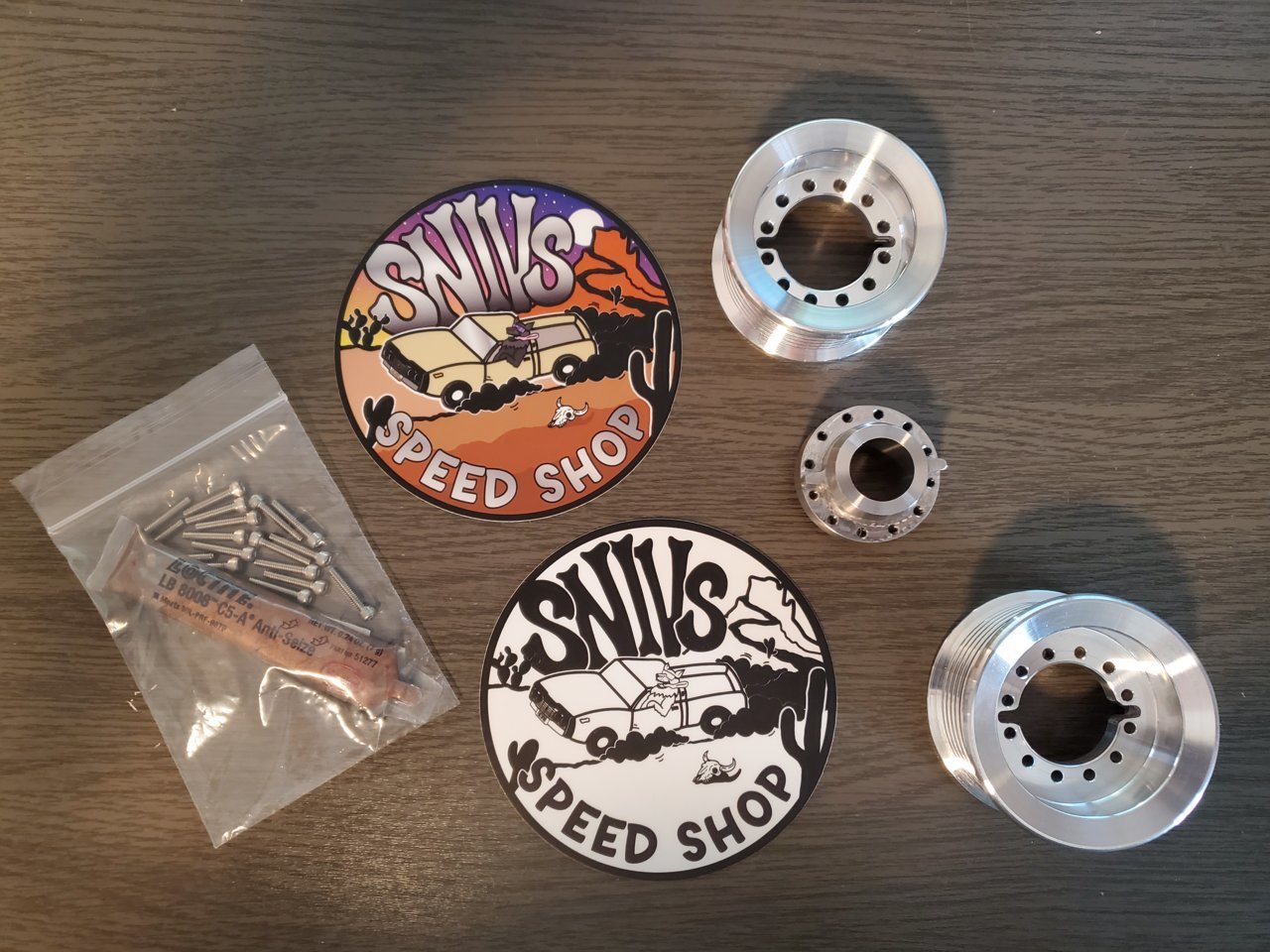

  30. Mar 30, 2023 at 4:15 PM
    #7050
    AZTundra
    Feb 13, 2018
    #12894
    4,473
    Paul
    Phoenix, AZ
    Last of the goodies arrived today. Thanks @snivilous everything looks great! I'll still take a 2.2 from the next batch whenever they are available. Now just need to wait out my install date which is set for 4/10.
