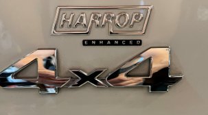

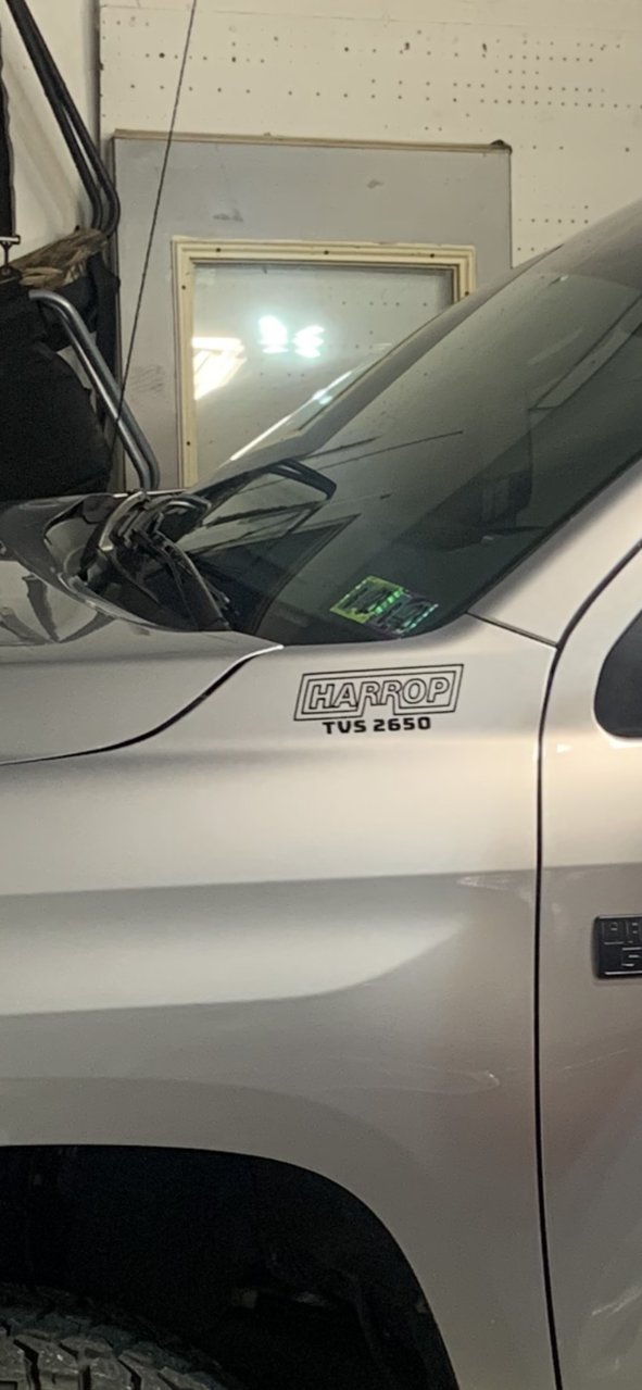

    I don’t have a dyno on site to validate, but I’m thinking this added at least 10 horsepower... Not a big sticker on the truck guy, but this seems modest enough to me and only means something to someone who knows. :spy:
    Tempted to remove all the other badging however.

    red letters add 10hp
    black adds 5hp

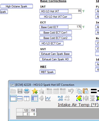

    My thought was to tap directly into the intake runner on the blower an inch or two above the head.
    What's interesting also, is I've seen zero evidence that the truck actually does anything with the IAT temperature. In HPT there is a IAT spark correction table but in every file I've seen it's set at 0 across the board (and across the board, there are only two values at 122F and 158F). The Harrop may give accurate intake temperatures but it makes no difference it appears. With that said that table can be updated to actually do something, and I know VFT had said before they incorporated temperature retard features.

    My understanding is the ECM is looking at IAT, but the changes it’s making in regards to timing and such are not tables we have available to see or manipulate on HPtuners.

    Well this table seems to be exactly that, but alas I am a novice at this.

    I think the tables are there in a rudimentary form, but how much data and points that can be viewed and changed in the tables on HP is another story. I don’t see how they wouldn’t be a rather critical reference point the ECM looks at. I think the other brands like the GM stuff there is a lot more available there for tuners to manipulate. This is speculation but hopefully mziggy can tell us what the scoop is at least on VFT.

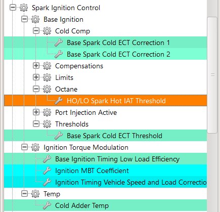

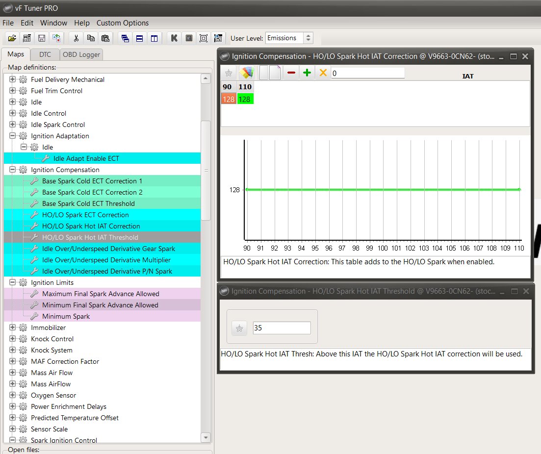

    It's entirely possible that tables like that exist and aren't accessible for that reason. Toyota is well known for tucking away tables behind safety systems separate from the main ECU.
    That question may be better directed to VFTuner/Mat (OVTune) because I don't know what I don't know (what I do not have access to). A table could not exist or just not be accessible and I wouldn't know from just being in the software.
    There are several tables that utilize ECT, across more than just spark advance. It's a pretty common theme I've seen across several Toyota models within VFT.
    If HPT offers IAT v IGN, while VFT does not, it's entirely possible that HPT developed and provides a custom patch/table for use by developers.
    There's a couple spark correction factor tables, which get used above a set IAT, but if there's more I haven't seen it.

    Lol I was skimming since I was tagged, and now that I'm going back and catching up on comments, yeah this is basically what's in VFT.

    these primarily use ECT, there's only a few that reference IAT and like I said, they're basically thresholds and correction factors
