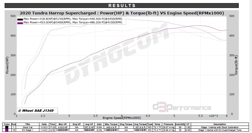

  3. Nov 5, 2021 at 3:08 AM
    #663
    nobodyintexas
    nobodyintexas What?
    Jun 22, 2020
    #48303
    6,923
    South of Houston
    S/C'd 2020 White 1794 Tundra
    for all the data fiends...
    here is Stage 1 and the difference a good tune makes vs. stock calibration
    hello mid-range torque.
  4. Nov 5, 2021 at 3:30 AM
    #664
    nobodyintexas
    nobodyintexas What?
    Jun 22, 2020
    #48303
    6,923
    South of Houston
    I asked for a Stage 2 video.
    exciting stuff.
    For all the fuelies....Tuner said they have seen no issues with Costco gas. consistently good 93 octane.
    Silver17 and sd172 like this.
  5. Nov 5, 2021 at 4:08 AM
    #665
    Silver17
    Oct 3, 2021
    #68847
    3,737
    Eastern PA
    2017 TRD 4x4 Harrop SC
    That dyno sheet is looking good. The average horsepower and torque increase is impressive as well, not just the peaks. And the max torque is at a lower RPM.
  6. Nov 5, 2021 at 4:15 AM
    #666
    nobodyintexas
    nobodyintexas What?
    Jun 22, 2020
    #48303
    6,923
    South of Houston
    let the record show...I am giddy.
    I asked them to beef up - as much as possible - power under 4k rpms. I just don't go that fast.
    apparently the boost comes on a tick faster with the smaller pulley - which is right in my lane.
    sd172, Saltyhero13, omgboost and 2 others like this.

  10. Nov 5, 2021 at 6:18 AM
    #670
    nobodyintexas
    nobodyintexas What?
    Jun 22, 2020
    #48303
    6,923
    South of Houston
    I'll expound on the stock tune.
    When we looked at the graph it showed that lots of timing was getting pulled under throttle. The stock tune was pulling power throughout the power band. no knock, but serious pulling of power. safe A/Fr's tho
    who was the fella that called that out a few pages back? @snivilous? <hat tip>
    it's not hurting the motor, it's just not letting the blower do it's thing...as the stage 1 tune showed.
    now if we look back @ Harrop's white paper....it is accurate. as they say no discernible knock. true, however the motor is pulling power. again, not bad as we have safe A/F r's the motor is staying in the safety zone. This safety zone is built into the stock ECU tune.
    now that we have more air going in & more fuel via larger injectors - we need to build out the safety zone. D3 is doing a fine job.
    This is about the horizon of my motor knowledge...I'll learn more later today when I pick it up.
    I'll see if I can get a/f Ratio data on the pulls.
