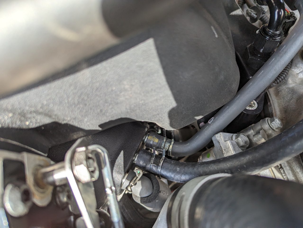

    #77930
    2,841
    Scott

  3. Mar 22, 2023 at 11:45 AM
    #6813

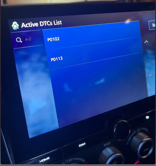

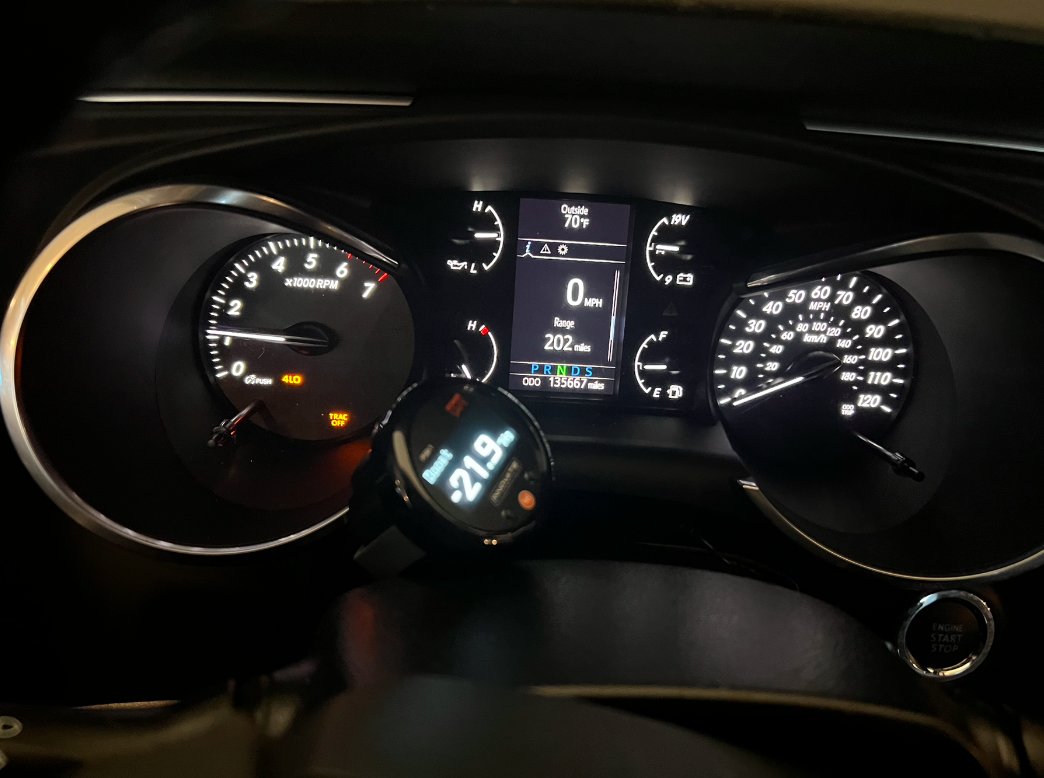

    #379
    5,702
    Rockies

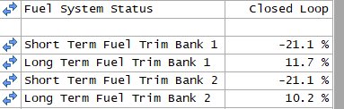

    This log is from earlier this morning at idle. I gotta do another 30 second log after turning pressure down to 43.5 and let them know where it's at after.

    Those are kind of up there, I would think that low to mid single digit percentages either side of zero would be an acceptable goal. Post a graph of what your LTFTs are over the rev range of a particular log. You don't have to go out and run through the entire rev range, just maybe like a highway merge without transitioning hard into Open Loop.

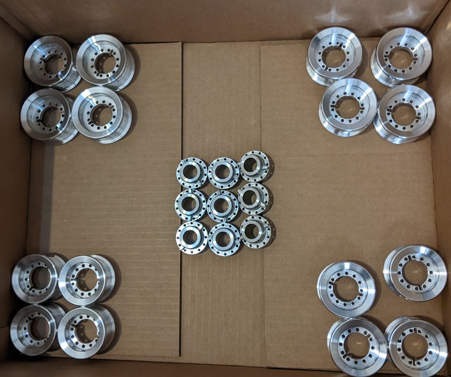

    Got my first production run of pulleys in for the Magnuson guys! If you want to buy some they're for sale on www.snivspeedshop.com and as you can see I have very limited quantities.

    That's at idle? You sure you don't have a vacuum leak? Those are pretty large values...ideally you would want them to be +-5% or lower.

    OTT also asked this. I looked and looked but didn't see any. Gonna do another thorough review tonight

    Try using carb cleaner, or another flammable spray to test silicone joiners, throttle body, injector isolators, supercharger base, anything post-maf that was disconnected or loosened. Spray the connection and listen for a change in idle...don't go crazy with the spray...a little mist will be enough to change the idle if there's a leak.
