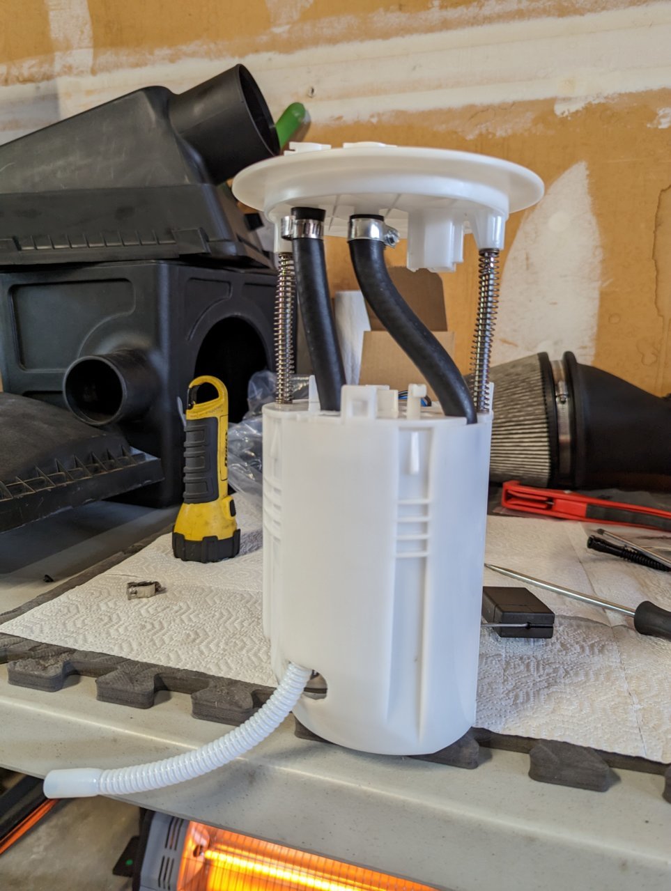

    The Radium Venturi instructions say to remove the stock venturi. Did others do that & if so where is it?

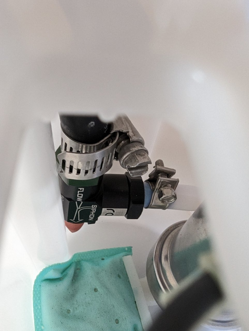

    It's the black tube going from the stock fuel pump out of the basket to the blue fitting, should be removed with the stock fuel pump as it causes a restriction.

    Thanks, I posted and immediately realized that was most likely it.

    That's the green orifice?

    Yes, looks like it
