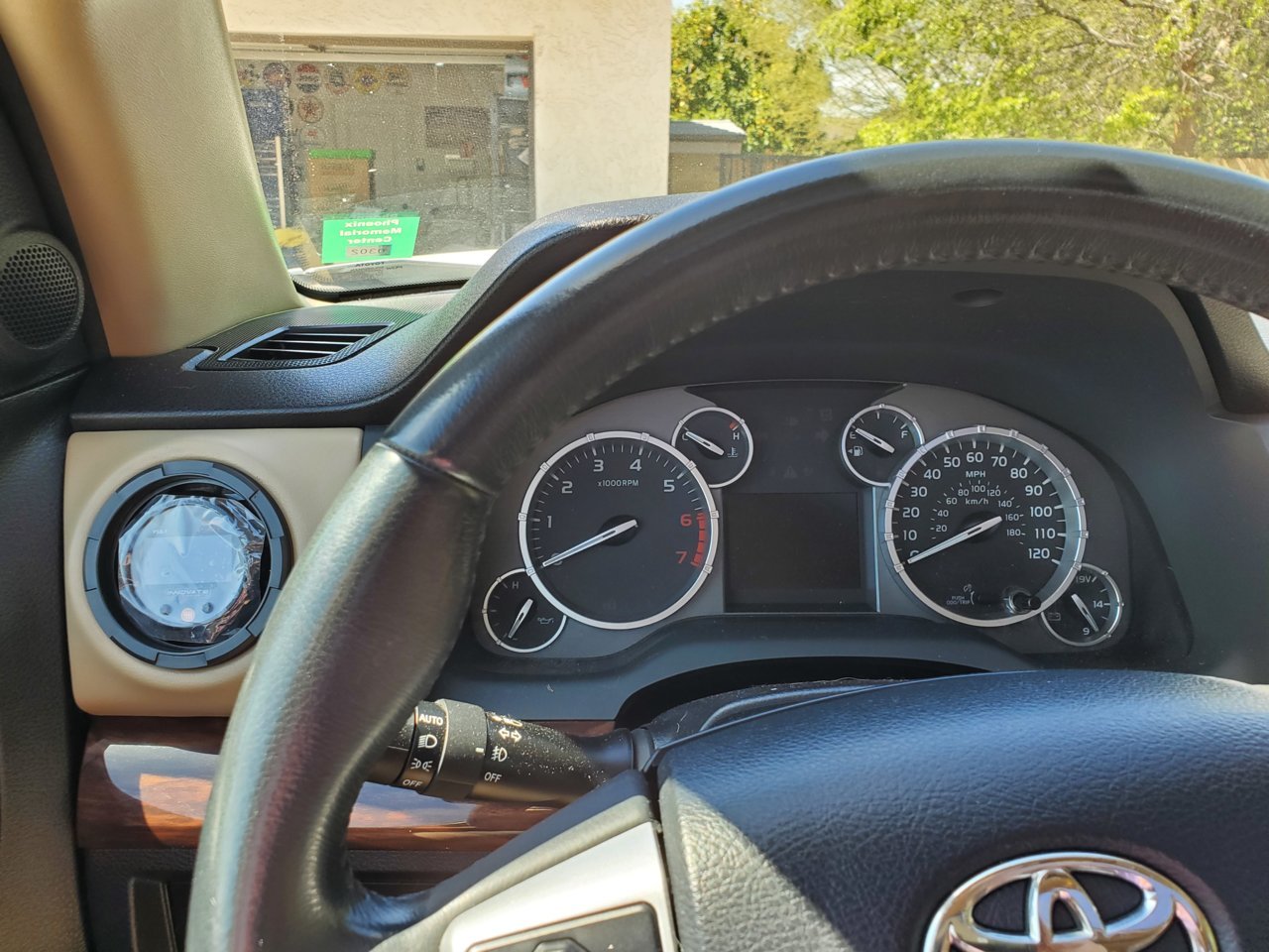

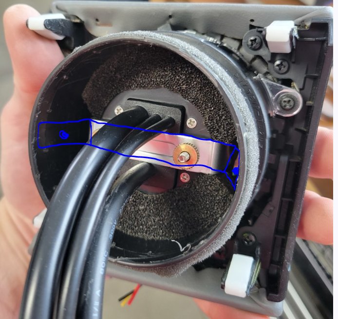

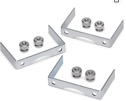

    Gauge mounted today, but I think I might try to come up with another way to mount the gauge inside the vent. There is a little play in there with the 1" foam and I'd like it to be nice and solid. Just ordered some Auto Meter 2225 gauge brackets. I'm going to try and install one backwards on top of the current bracket hammered flat and then bend the tips and put a screw through the vent tube into the bracket.

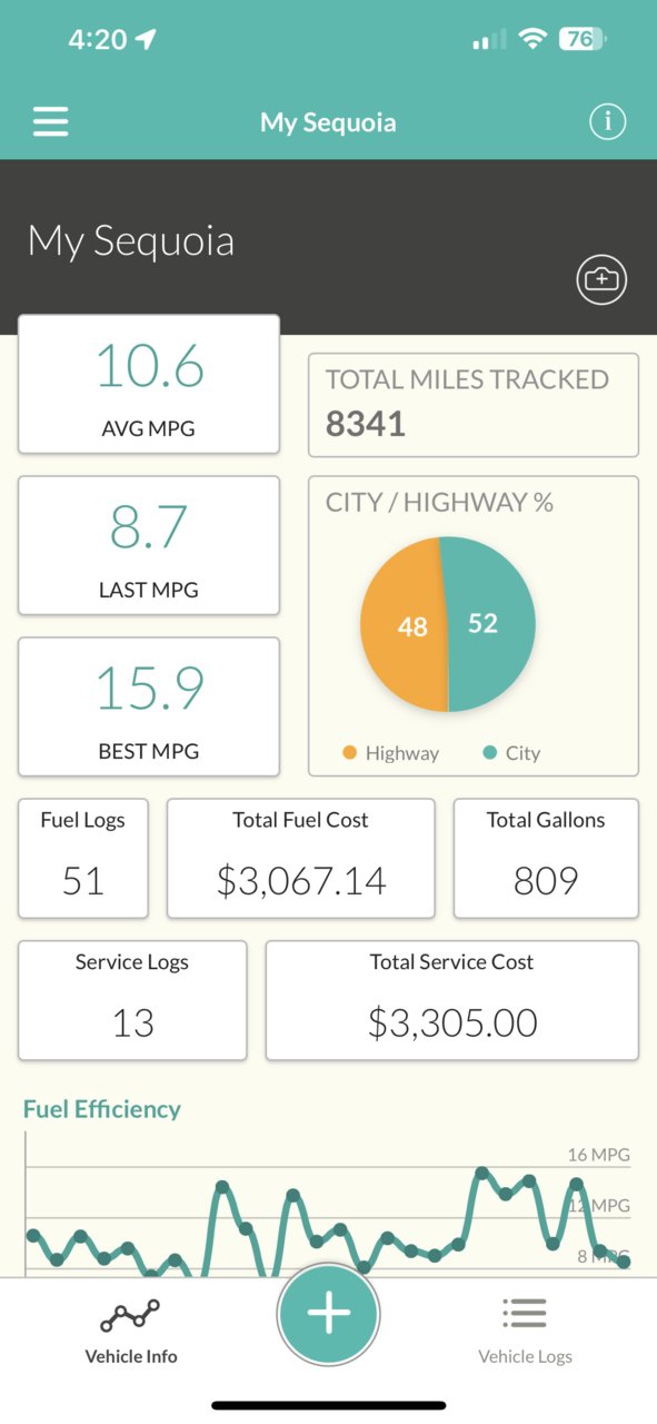

    Nope, these are actual use numbers.
