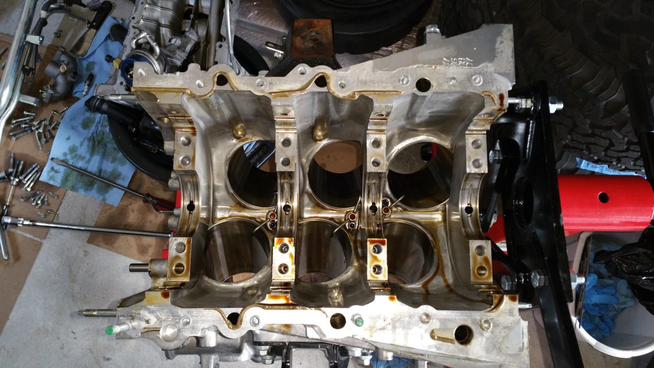

    You'll have to take the block out of the truck to do the rings, or at the very least take the heads off and the oil pan off, the pistons have to go in from the top...no way to compress the rings and insert from the bottom.

    This is from my Tacoma...but similar setup on the 5.7, mains are in the way preventing insertion from bottom.

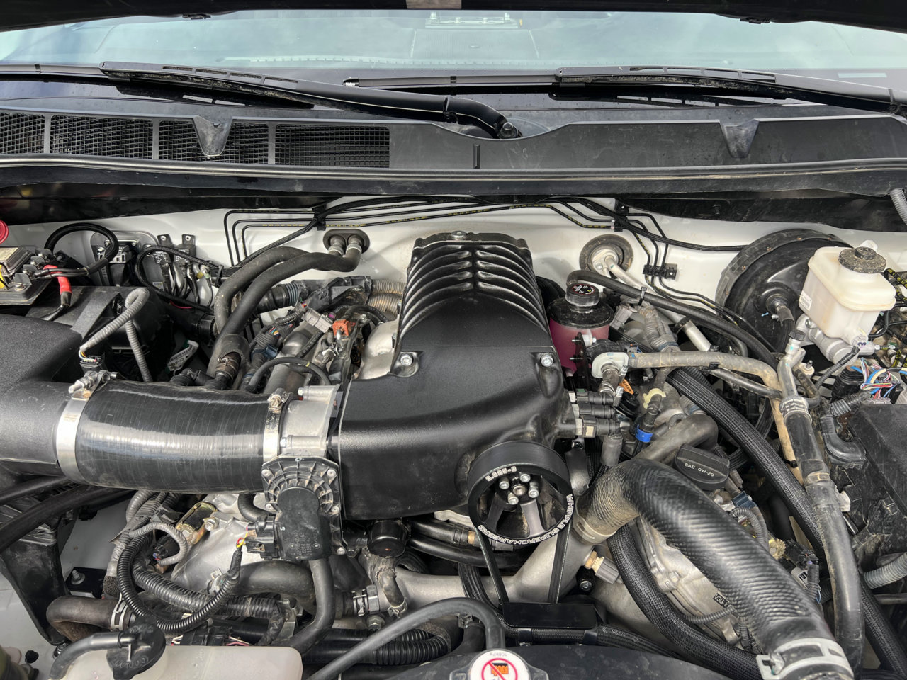

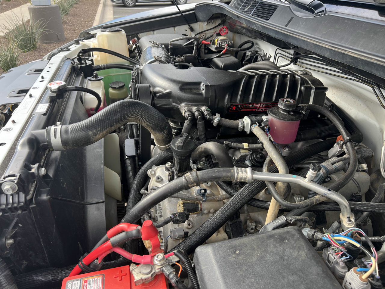

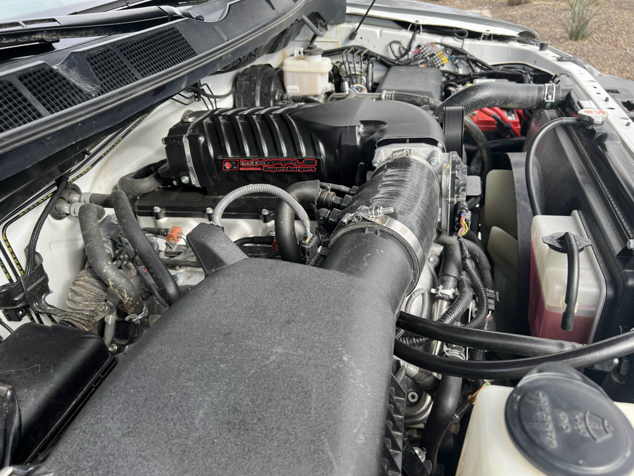

    Some whipple pics and vented hood pics for everyone. He's getting the tune checked before the trip to pick up the trailer. After that we'll begin the smaller pulley,injector and custom intake box work.

    I haven’t seen anyone stretch the Whipple provided intake tube over the magnuson lid MAF housing yet. I wonder if it’s doable or if a different tube will be needed.
  12. Mar 9, 2023 at 9:12 AM

    I like the clear intercooler fluid reservoir.

    Don't think it'll fit but we think the maggy tube will fit in that tubes place. We'll find out soon.

    With the Whipple to me it looks like a cleaner install!! They fit in there nicely!!! Don’t forget the video of that thing going off!!

    It's def easier to access things over the maggy with the smaller foot print. I told him to send me some videos.

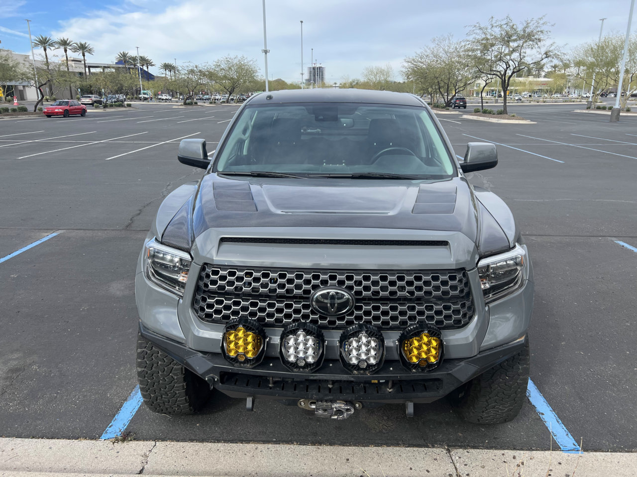

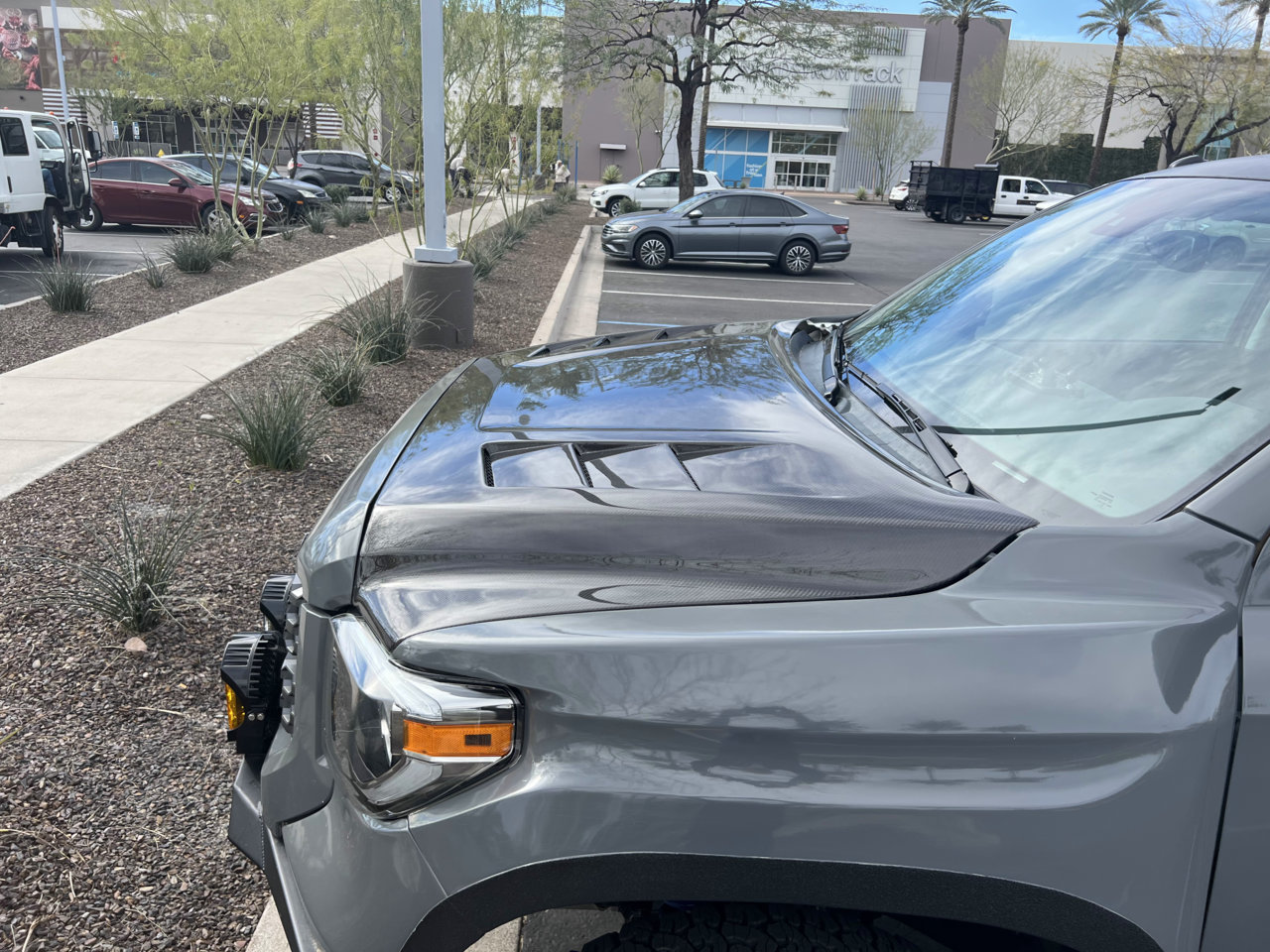

    That looks clean...makes me wish I waited for the Whipple. Did they have any issues fitting the hood? How are the gaps when closed?

    Nope no issues and we used the factory latch and hood struts. Added clear ppf just incase to prevent the clear coat from yellowing etc. Side pic attached

    Do you think it will need hood pins, or is it pretty solid at speed?

    Nope no hood pins needed.

    Oh yeah...I guess with the vents you don't have to worry about it lifting. Thanks for the feedback.

    You can run them if you want but our contact at seibon said it’s all good and no need.

    Hood looks very nice! If I keep the truck longer term I'll definitely consider it. The bare carbon fiber would match up to the MGM paint nicely
