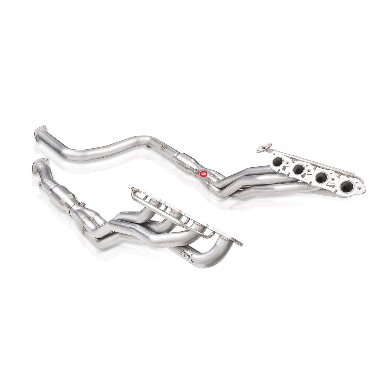

    Work bonus coming in next week is unexpectedly larger that usual. Looking into full exhaust setup. Asked SW if they could just add the bung for me before shipping. Guessing this would be the best location to have it installed? Gonna call Dirty Deeds next week, looking at an x-pipe before the muffler system that they previously had said would be np to build for me.

    Yes, that'd be a great spot...it's a bit tighter on the DS but should work fine...just be sure to throw your more sensitive wideband o2 sensor in front of the OE location...essentially swap OE narrowband behind the wideband for optimal results

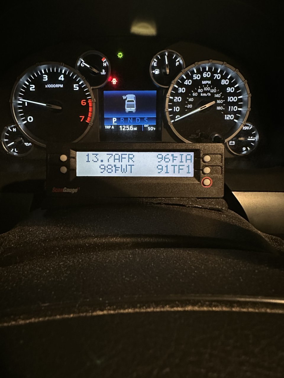

    Please do share your changes that will “tune it out”. I’m still dealing with intermittent extended crank also.

    He definitely did something to make it happen randomly rather than every time after sitting for 20 mins+. I've been paying attention to if the trucks at an incline/decline or level and that doesn't change anything.

    Have you tried tweaking any of the parameters I suggested that helped mine by chance? I don’t expect the exact same changes to be the fix for your truck vs mine but I’m curious if it’s the same general issue.

    Yes, @snivilous made those exact changes you sent over from your post. It did get better but yesterday I had very extended cranks again so I think it would need some minor changes to those same values for ECT and IAT.
    I took a pic of my temps right when it happened yesterday. Damn 50 degree day just like your scenario.
    Do you know what the 0.08, 0.55, 2.23, 1.99 mean? Are those units seconds in time? Or multipliers for something?

    The units being changed is L/S which I’m assuming is liters per second, alternatively expressed as cubic centimeters per minute. If I had to guess I think it’s purpose is to add or subtract air at startup via the throttle body opening based on the IATs and Engine coolant temp. I think mine was overly rich at startup. I think I remember smelling how rich it was, and blurping the throttle as it cranked added air into the cylinders to evaporate some of the excess fuel and it would start easier.

    Looking in HPT, I see why your tuner went with 0.55 and 1.99. They are both averages of the higher and lower temp values. You have any idea which way to go for revisions in ECT and IAT?
