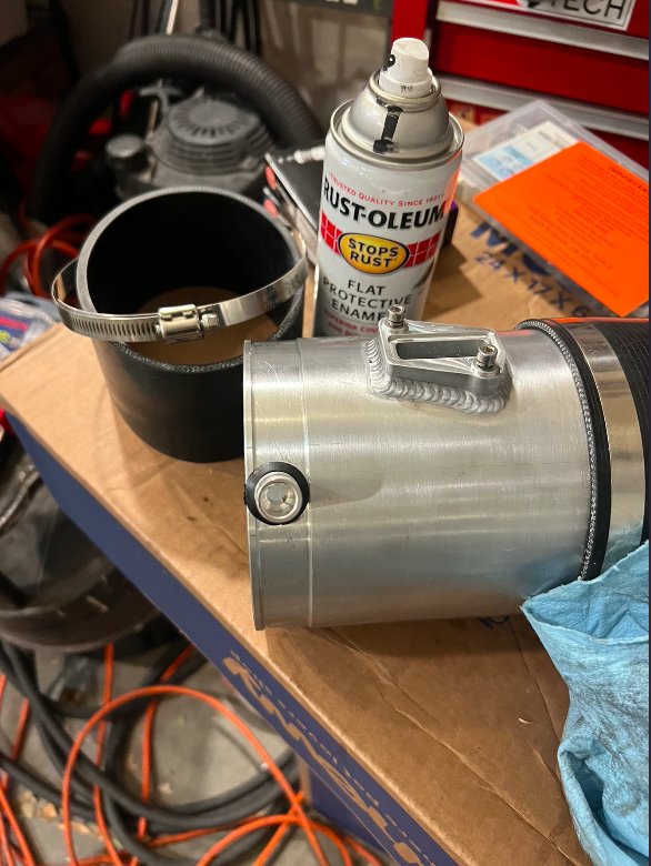

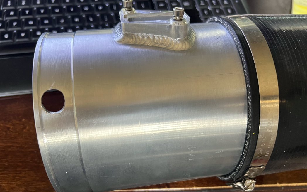

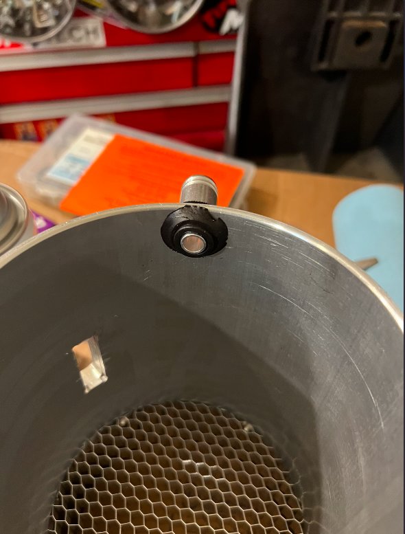

    Fitting is in, it was interesting.
    lol
    reywcms likes this.

    How are you getting the silicone coupler on?
  16. Mar 7, 2023 at 4:42 PM
    #6376
    e30cabrio
    Oct 20, 2017
    #10410
    6,566
    West Valley, Phoenix, Az.
    Boosted 2013 Sequoia TRD FAUX
    I'm going to drill a hole in it, I ordered one that is longer so I can clamp it ahead of the fitting.
    M3Tundra-JK and Saltyhero13 like this.

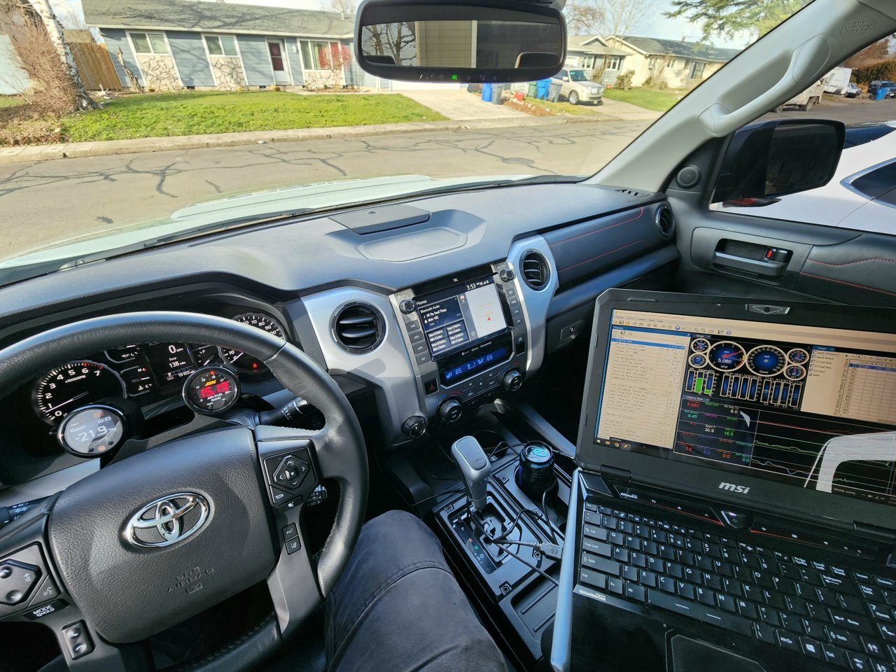

    Continuing to get dialed in via remote tune. Touching base on tuning out the extended crank.. I lied. It's intermittent now and Chris @ PS is playing around with attempting to "tune it out"

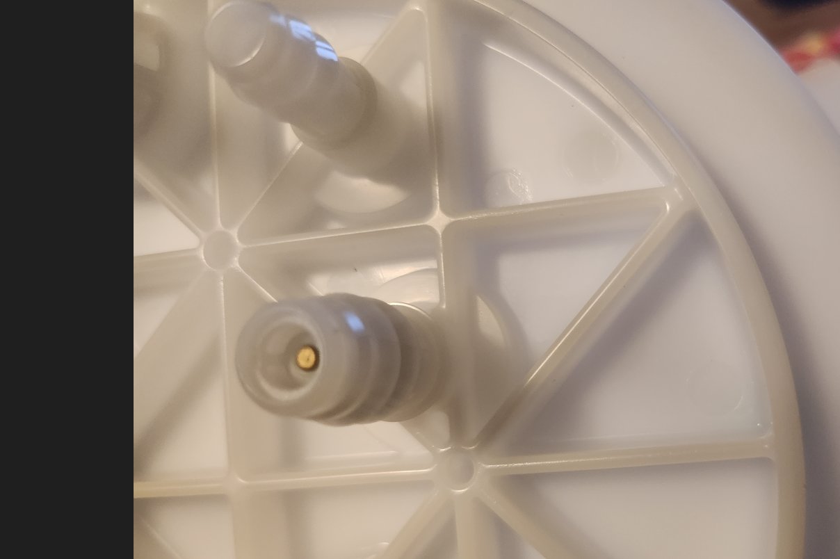

    As an aside, I've noticed that with the PS fuel rails, I've only been getting the extended crank after the line blows.
  25. Mar 8, 2023 at 6:57 AM
    #6385
    armyoffoo
    armyoffoo Member
    Jun 4, 2018
    #15876
    1,479
    Cypress, TX
    2018 Black TRD Sport CrewMax
    Supercharged with all the trimmings
    I confirmed there is a check valve built in to the fuel basket pressure barb, I have removed that as part of my modifications...so that's what caused the cranking issue for me. Not sure what would be the fix for anyone with a stock fuel pump basket, as they should still have fuel in the pressure line to the rails, not full pressure, but enough to start the truck until the fuel pump kicks on.
