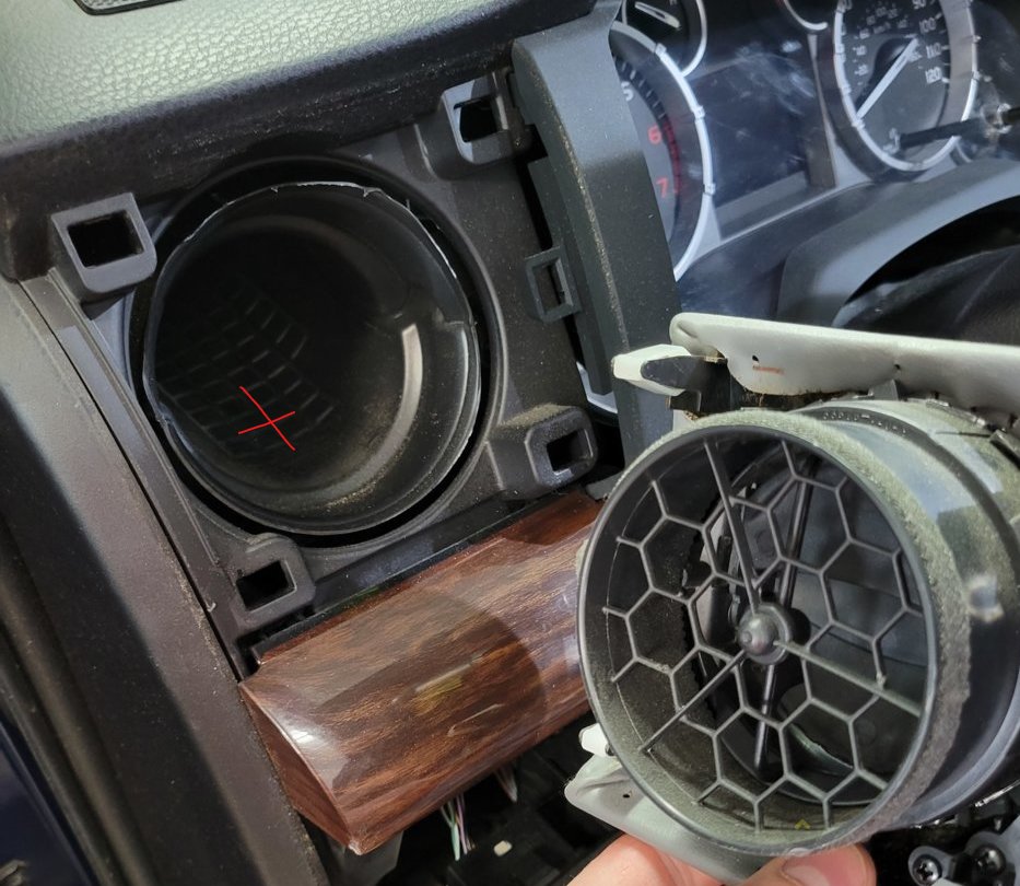

    A friendly suggestion, use the vent to the right of the steering wheel...or the vent upper lefthand side of headunit...less glare, easier viewing, etc. Same install, just a couple more clips to pull out below...I may end up moving mine but for now, I'm okay with where it's at...

    Thanks for the tip. I assume you're just drilling a hole through the ducting then to feed the wiring?

    yes, mostly, I just sliced a cross in the ducting to squeeze the wiring through...I wish I had a photo of it...but yes, easy once you see it...er...try this:

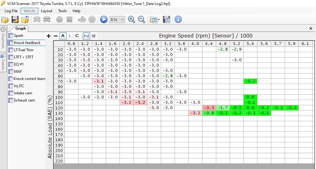

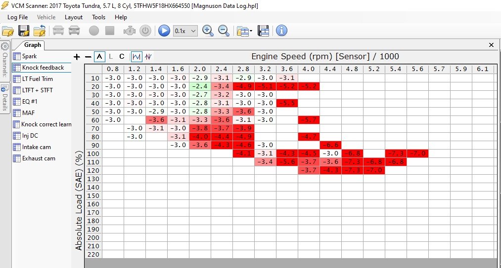

    I used the original Mag tune for almost 30K miles before getting a remote tune done. I can't really say I gained more hp/tq with the remote tune since I didn't do any before/after dyno runs. What I can say is that the Mag tune produced a good amount of engine knock that was eliminated by doing a good remote tune. That alone is worth getting a better tune in my opinion.
    Not sure if you came across the other threads, but below is my Mag tune knock feedback graph and underneath that is my remote tune. You can see the canned Mag tune leaves a lot to be desired. I don't have as much knowledge as others on here, but go get yourself a custom tune to ensure your truck is running as it should. If you have any hp/tq gains that will be the cherry on top.

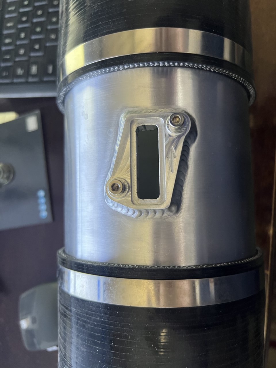

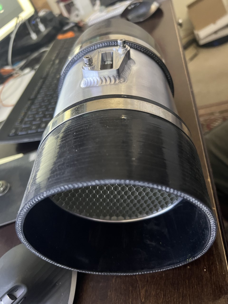

    On the subject of intakes, where do I need to drill the vacuum hose hole? & is the arrow air flow into the TB?

    Yup arrow in the direction of flow. The vacuum hose has to go in after the MAF sensor. If you don’t have the real estate on that intake tube maybe you can make a good connection into the silicone tube somehow (like drill a hole smaller than the fitting and force it in). Not sure if that would work but that’s the principle of how it connects to the Harrop tube.

    Based on what I see on my current tube, it looks like it needs to be a bit under the maf on the TB side.

    I’m seeing on the maggy setup all vacuum is post maf so I would keep it that way.

    I remember seeing adapters for silicone hoses if you can't find real estate on the tube. What I originally did was used a second coupler pipe to host the fitting but I don't recommend doing that. You are better off with one piece for your intake.
