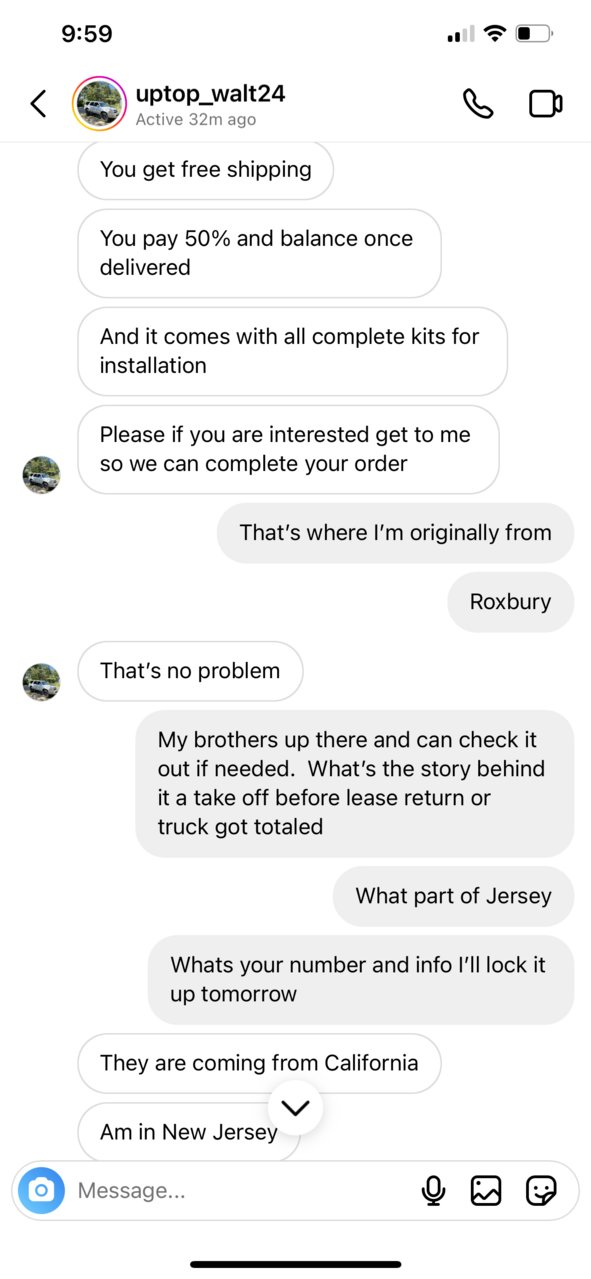

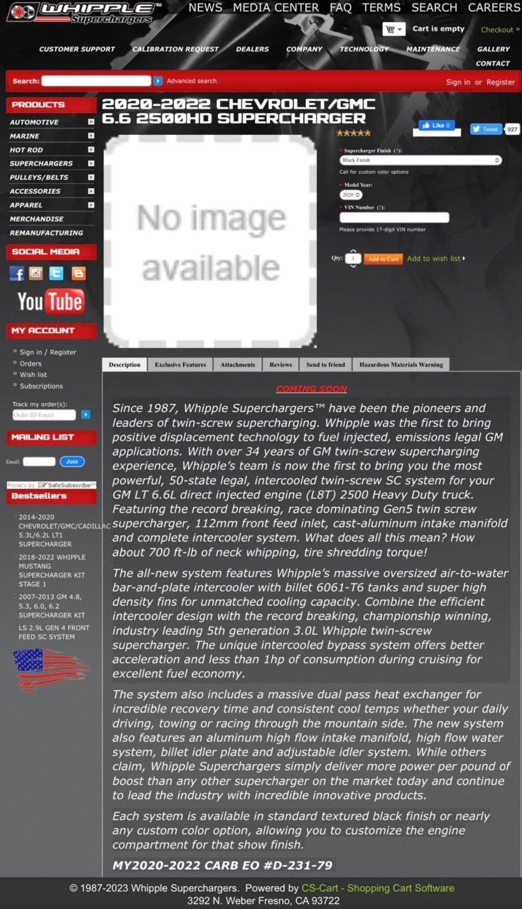

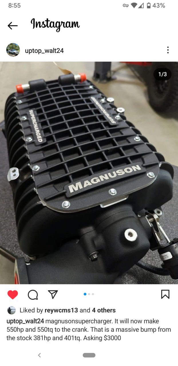

    Hey guys not to interrupt the whipple convo but the Maggie that’s for sale on Instagram…. Any concerns with used magnuson? I can get a new one for 2018 flex fuel but this is a good deal if legit. Other concern is the guy is an FB marketer that lists items on his page for others. So basically a 3rd party. Most of the pics I’ve seen are when the SC was new. My BS radar is going off. Only cause why go through trouble of removing an SC cause youre selling the truck? Most people will pay more for an SC truck and if you remove and use a 3rd party to sell then more fees and deducts. I have a hard time believing someone in California can’t sell a Magnuson supercharger for $3k.

    You'd have to post which one. The one listed a few days back for $3k is a scam.

    That is correct I missed the scam part but the one posted a couple days ago

    Seemed like BS. I’m in Nj but the sc in Cali send half and then when you get it send the other half. Guys got 500 followers on IG

    Thanks for confirming Snivilous I could smell the BS right off the bat

    Idk which one you're referring to, this one is a scam for certain.
    I'd be very wary if you find one for $3k. They're out there, but I'd have someone you know physically look at it (and buy it ideally). Even talking to someone on the phone wouldn't sell me. $3k is right in the believable range people want to jump on.

    That’s the one. Up top Walt. The grammar in my conversation with them alone shows me it’s BS.

    At first he says he’s in NJ and when I say I got someone to check it out he immediately says he’s selling for someone in California.

    Who in their right mind would let you pay half now and half after delivery? If I was selling my supercharger, I would want 100 percent before it left my possession. But that’s just me.

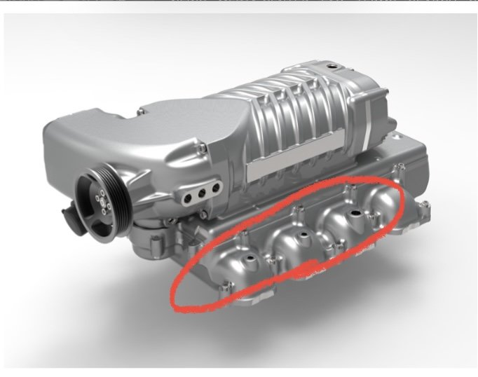

    Pops whipple update. Think we've found the issue. The bypass valve is stuck open due to the wrong bolt being used on the blower base plate. The arm that moves is stuck on the bolt in the open position ... So changing that out or adjust the arm bracket and see how she does. More to come.

    @nobodyintexas nailed it.
