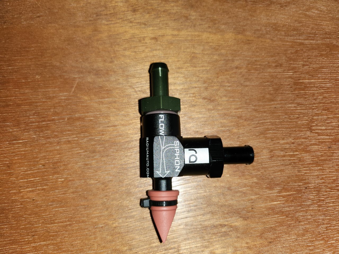

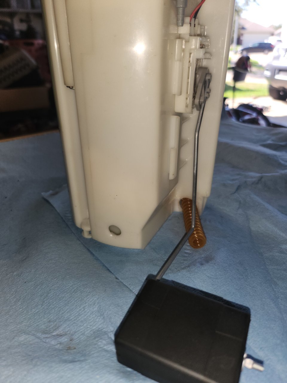

    I got the fuel venturi jet pump installed, but had to hold off on the 8AN upgrade, the fittings are too large to fit in the same spots that the 6AN fittings are in, so I will modify the other fuel basket top I have and clean up the wiring while I'm at it.
    Radium auto fuel venturi, goes on return line and uses pressure to draw in from the side barb and out the bottom...the eraser-looking thing (duckbill valve) is a special attachment that's supposed to reduce aeration, without it they recommend at least 8" of line on that barb....the basket's already packed with stuff so I chose to go this route.
    Here you can see the ptfe tubing I have on the siphon-side that will siphon fuel from the bottom of the tank back into the basket
