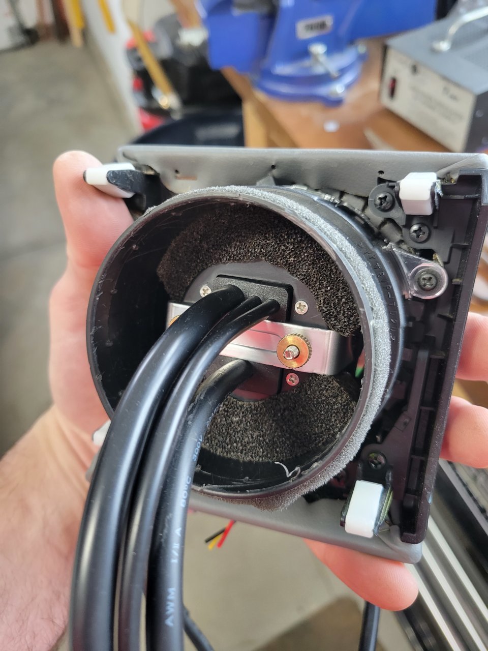

    Gauge vent install...this vent is easiest but not ideal...life's a journey:
    >Pop off trim by prying door-side edge of trim out...pull from there.
    >Pop off chrome vent ring at the x3 clasps.
    >Pull trim apart by unscrewing x3 small philipshead screws. Separate the parts and put the original vents away.
    >Cut out grill inside vented trim piece. I used a pair of dykes/wire trimmers and made it smooth with a chisel.
    >Slide GlowShift gauge cradle (https://www.amazon.com/gp/aw/d/B083YVT188?ref=ppx_pop_mob_b_asin_title )over your PSB-1 and prepare your hold downs to size...I removed approximately 3/16" from each end to fit...
    >Measure and cut 1" thick window seal (from any Hardware store) around to fit inbetween the aluminum hold down.
    I'm leaving the plastic on gauge face until I next get it all hooked up...next up is getting the bung welded in...after that, a continuation of this saga...
    **edit, no I'm not on plastic wrapped gauge face...this looks better! There is still airflow as I didn't completely wrap in the gauge's entirety...I'd say you get the air flowing through 25% of the opening now...which is adequate.
    This idea is courtesy of @ssmokedz!
