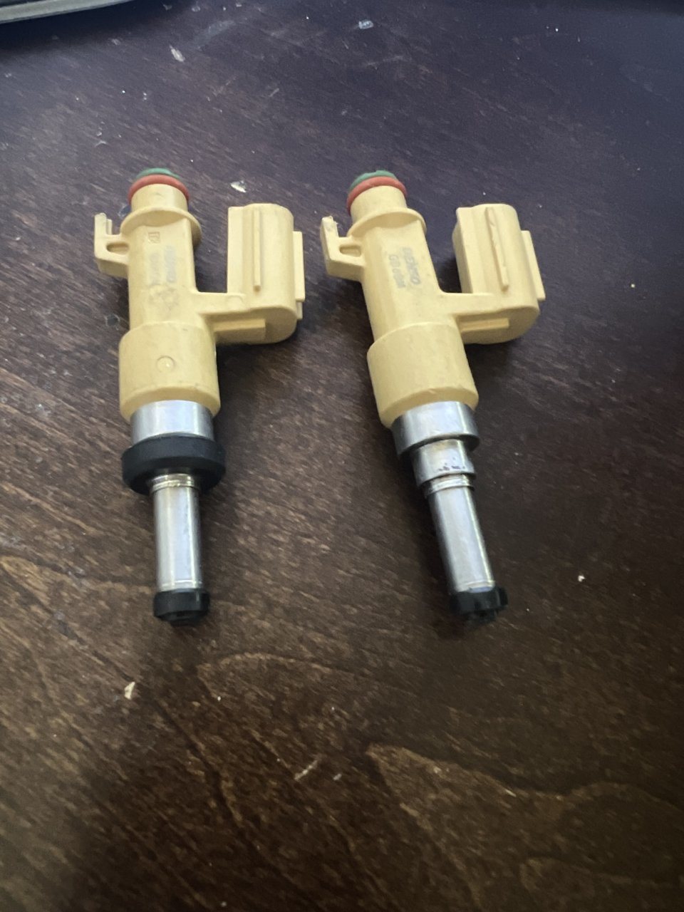

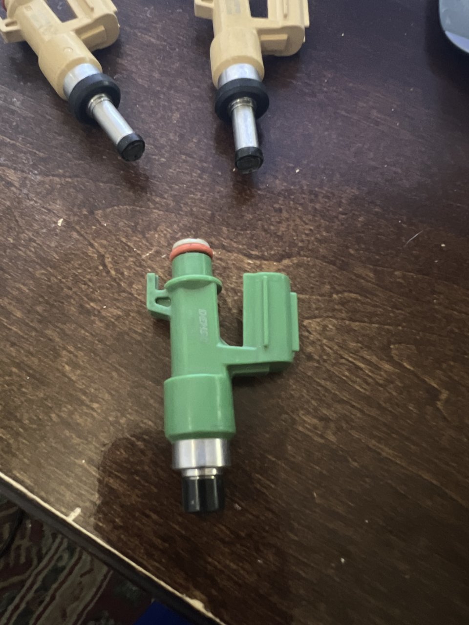

    So you received the green ones and then bought the Five-O ones? Or one of those are the ones that came off your truck?
    I tried looking for a picture I thought I had taken, on my truck at least the OEM injector is tan and long and the Magnuson supplied are short and green. The Five-O ones Ive seen appear to have a stock (tan) looking body but obviously flow more.

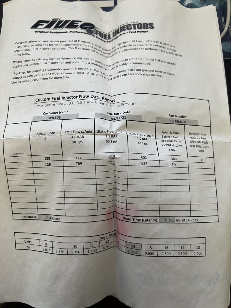

    The green came with the SC, I bought the Gold 5-0s
    They came with these sheets:

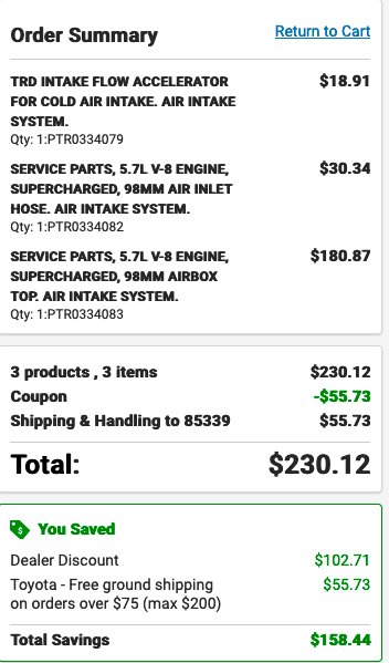

    Got the base ordered. Was $57 after shipping

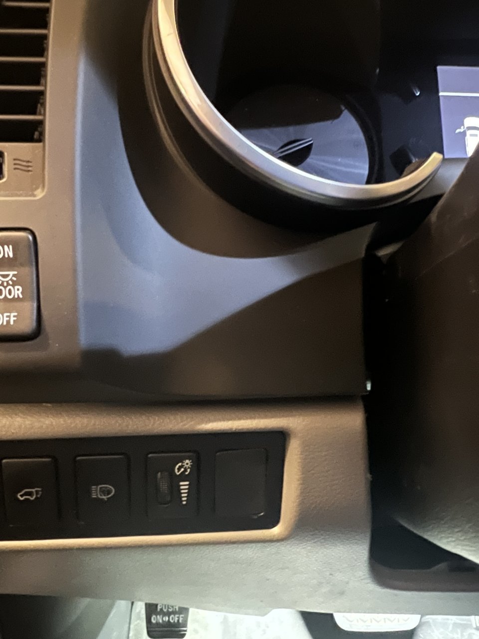

    Sorry I did not respond to the AFR gauge placement. I'm thinking here if it has room behind to fit.

    Here's where mine is for the 07-13 guys who don't use the stock brake controller:

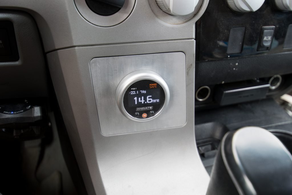

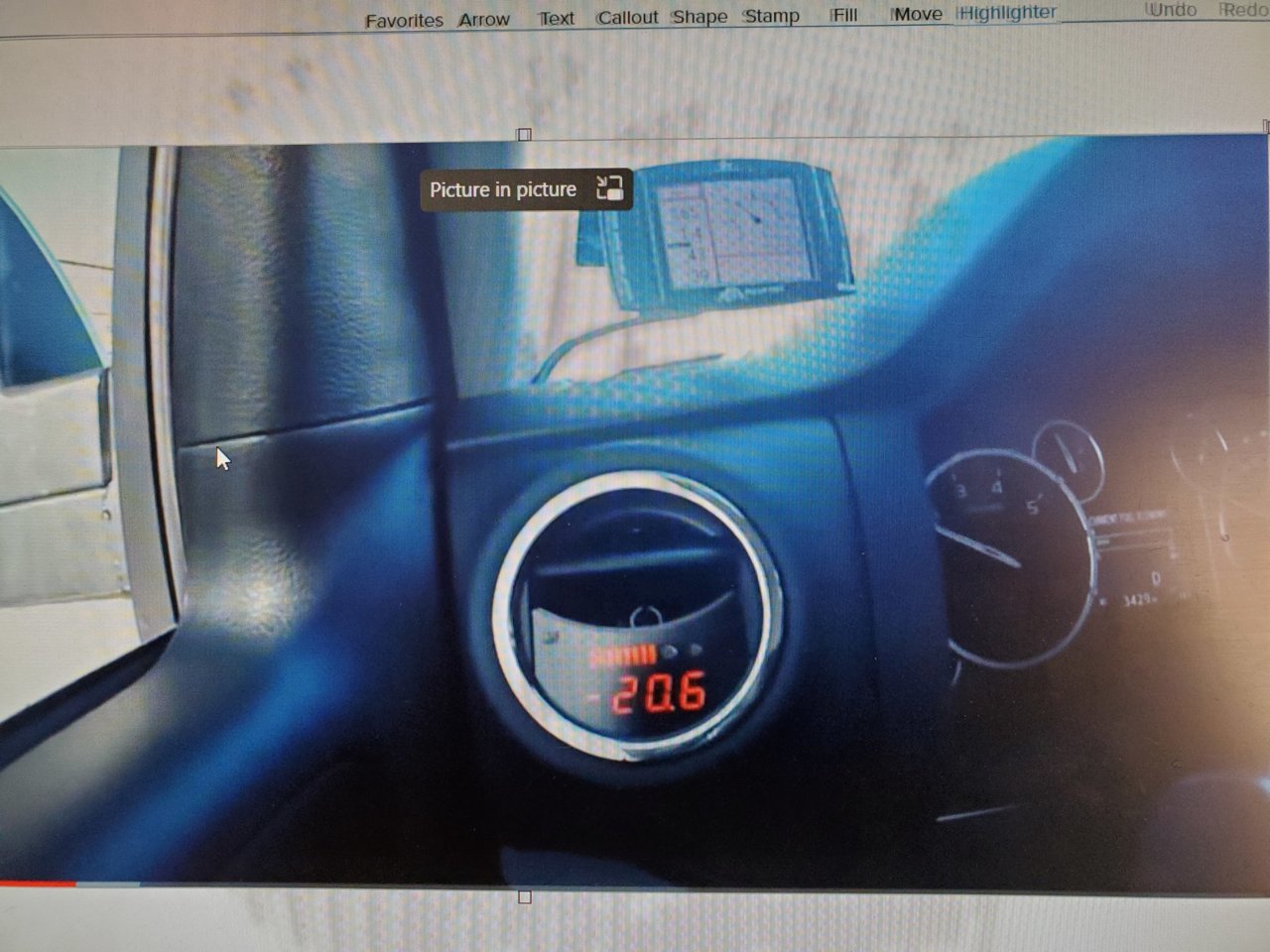

    Sweet. I believe that's the mount I'm going with as well, but will likely do the Innovate PSB-1 gauge. I did see another mount on a Youtube video of a supercharged Tundra where the gauge was mounted inside the ac vent on the left side of the dash. Been trying to find that video again to see what mount was used, but no luck finding it so far. I'll post up a picture if I can find it and maybe someone will know what mount that is.
  18. Mar 3, 2023 at 8:24 AM
    #6228
    Wynnded
    Wynnded What MPG...
    #379
    5,702
    Rockies
    Souped up truck

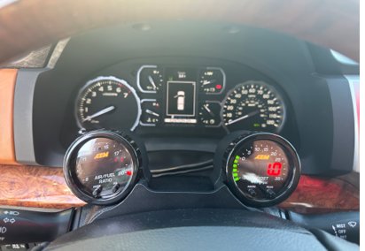

    This is what I did as well. With the combination gauge I only used the one pod, mounting it on the left hand side. The only indicators that it obscures are the left turn signal, and the Check Engine Light. A slight tip of the head brings them back into sight though.

    I like the cravenspeed mount. Looking at those gauges in my face makes me feel like I’m about to stop into Harry's and order 3 t66 turbo's with NOS and a Motec System exhaust as I drive along.

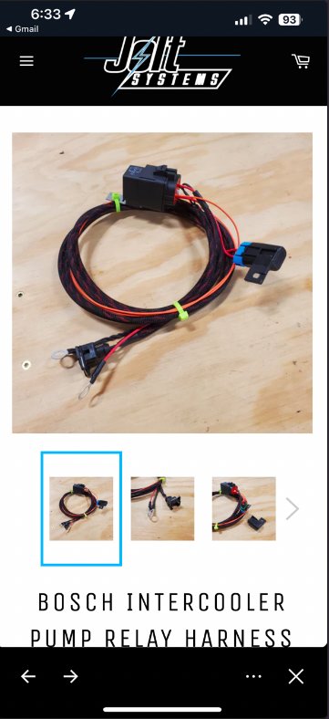

    IC coolant pump harness, reservoir & spark plugs came, all that is outstanding are the gaskets for the TB & coolant crossover & SC hose kit, all from Toyota supposed to come next week.
    I wired up the harness & tested the pump, it runs!
