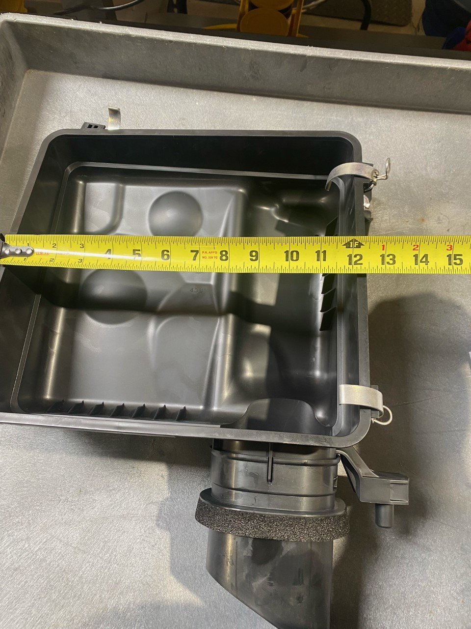

    I just ordered:
    TRD 98mm airbox top for $172 - PTR03-34083
    TRD Airflow inlet for $18 - PTR03-34079
    TRD intake tube is $31 - PTR03-34082
    I need to call SCOL to order the lower air filter housing

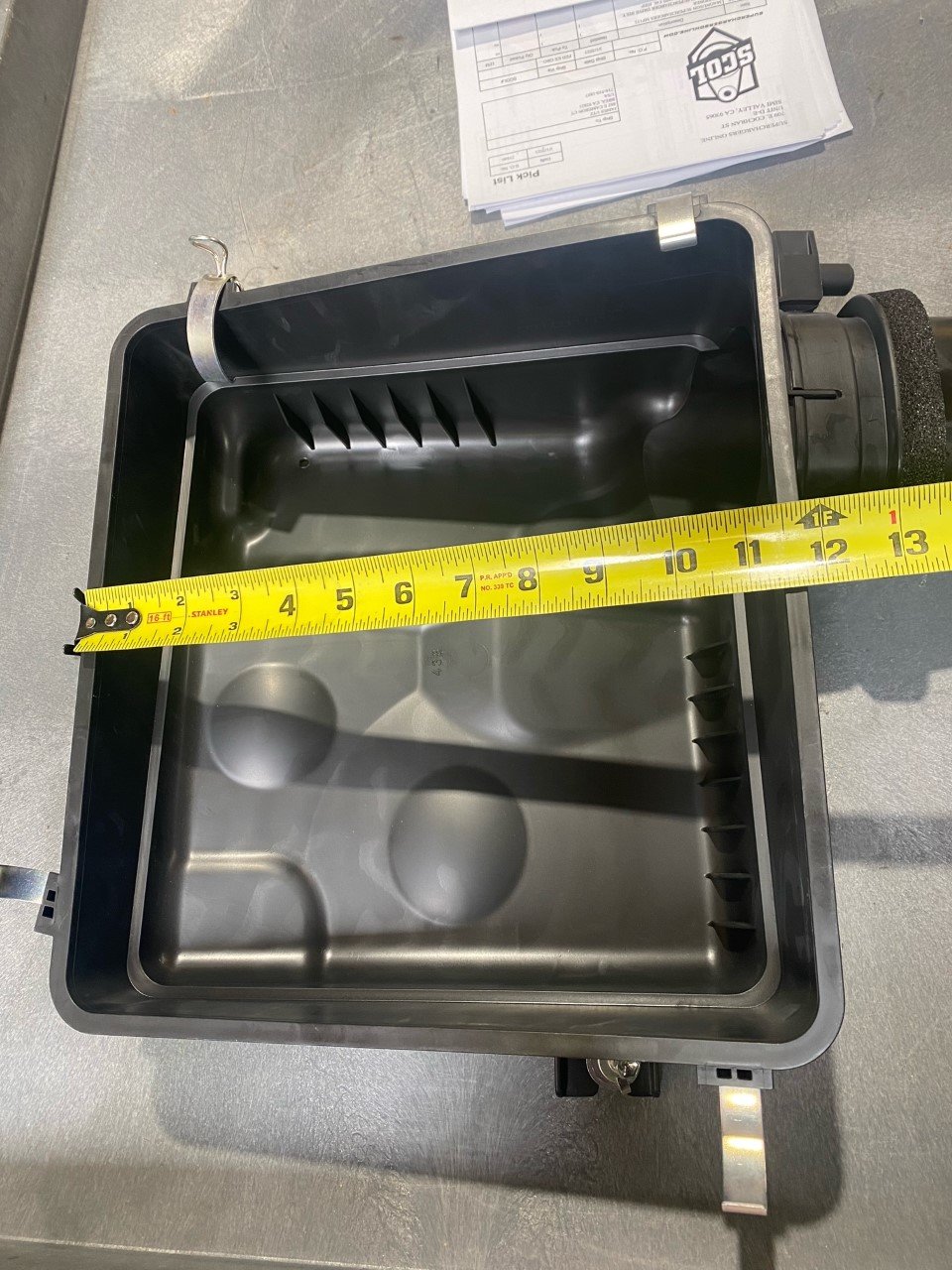

    I would imagine so. In January 2022 I was in contact with Nergal at SCOL about ordering one new. The prices at that time were as follows:
    The Airbox Base is $45.00
    The Lid is $155.00
    Shipping $22.00 - $25.00

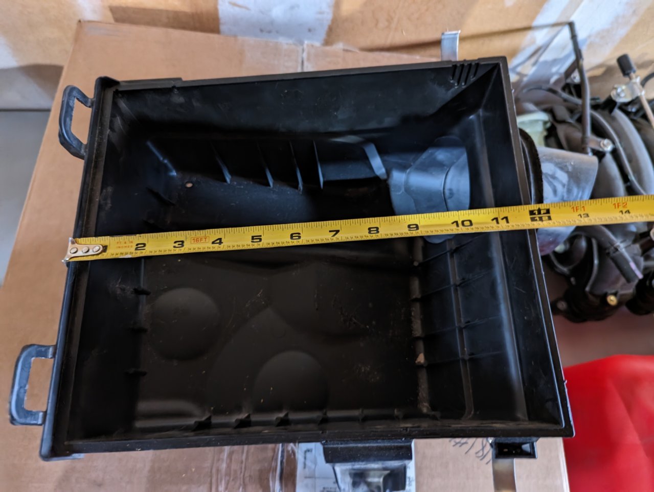

    Also, I emailed SCOL about the lower air box. He said he'd never heard of the 2007-2013 lower box being larger than the top part. When I look through both Toyota 2014- and Magnusun instructions, it only has you changing out the lid. He's gonna go grab the dimensions off the lower box so I can compare against my 2021

    That filter is the largest AFE filter I could find that would fit in the Stillen airbox. Folks would need to run a 4.5" to 6" adapter to use it. Sorry for any confusion.

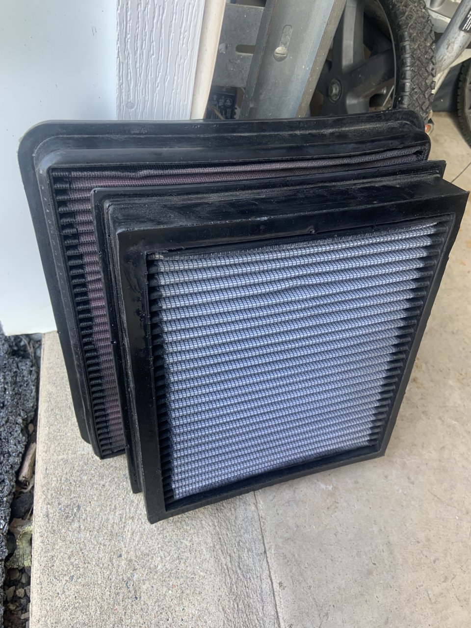

    Here is the difference between an 07-13/magnuson filter and the smaller 2014+ filter.

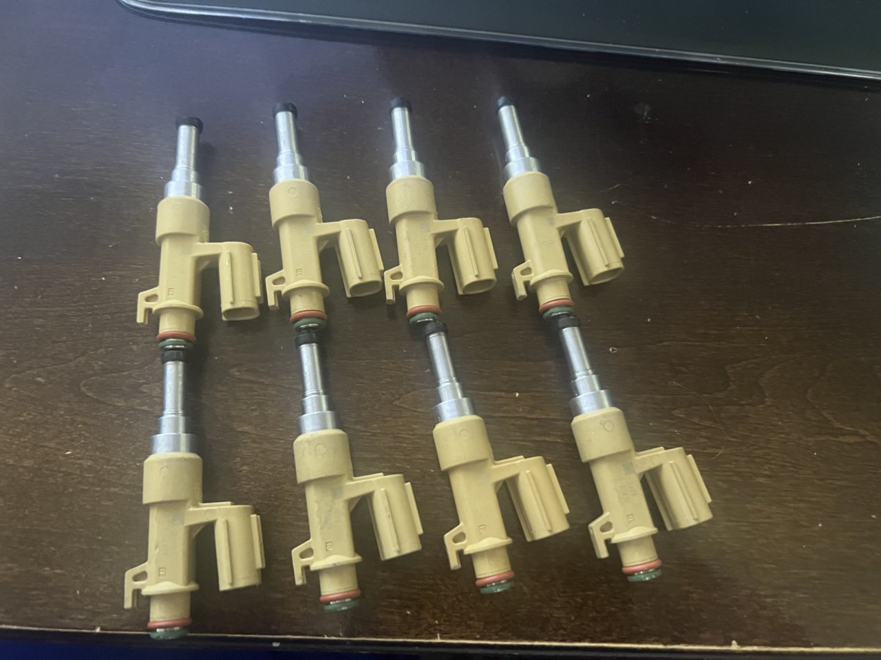

    Injectors!!!
    Why are they totally different from the Magnusons?

    They look identical to the stock ones. Question is why are the Magnusons different from stock.

    I am missing 6 of the doughnut O rings so interacted with FIVE 0 to get all the O rings, he said the green one was OEM. :dunno:
    This is my first interaction with Tundra injectors. :D
