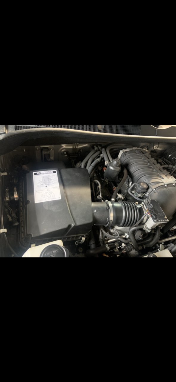

    Whipple update pops picking the truck up Saturday. We’ll be doing a revised intake/maf and smaller pulley lol

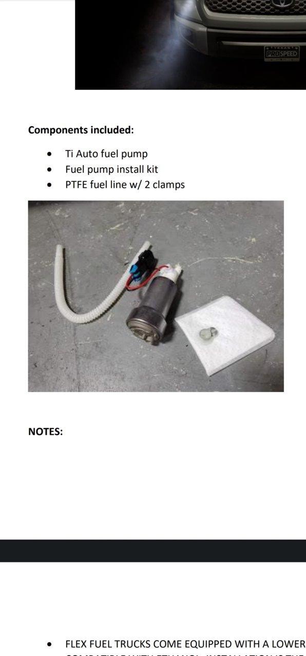

    Anyone know how long the line is that PS includes? looks like $20 for a hose, but need to know length
    https://cj-motorsports.com/products/ptfe-tube

    All I could find was this picture that doesn't help much. Screenshot_20230228_092116_Drive.jpg

    I didn't measure, but it's around 4-4.5", just long enough to put pressure on the pump forcing it to the bottom of the basket. Installation is tougher with these, they don't expand as easily as rubber, so some force is required. I put Vaseline on the inside of the tube at both ends to help the barb slide in, I didn't use heat.

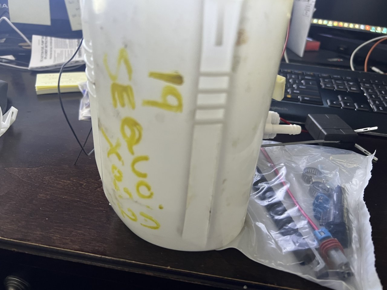

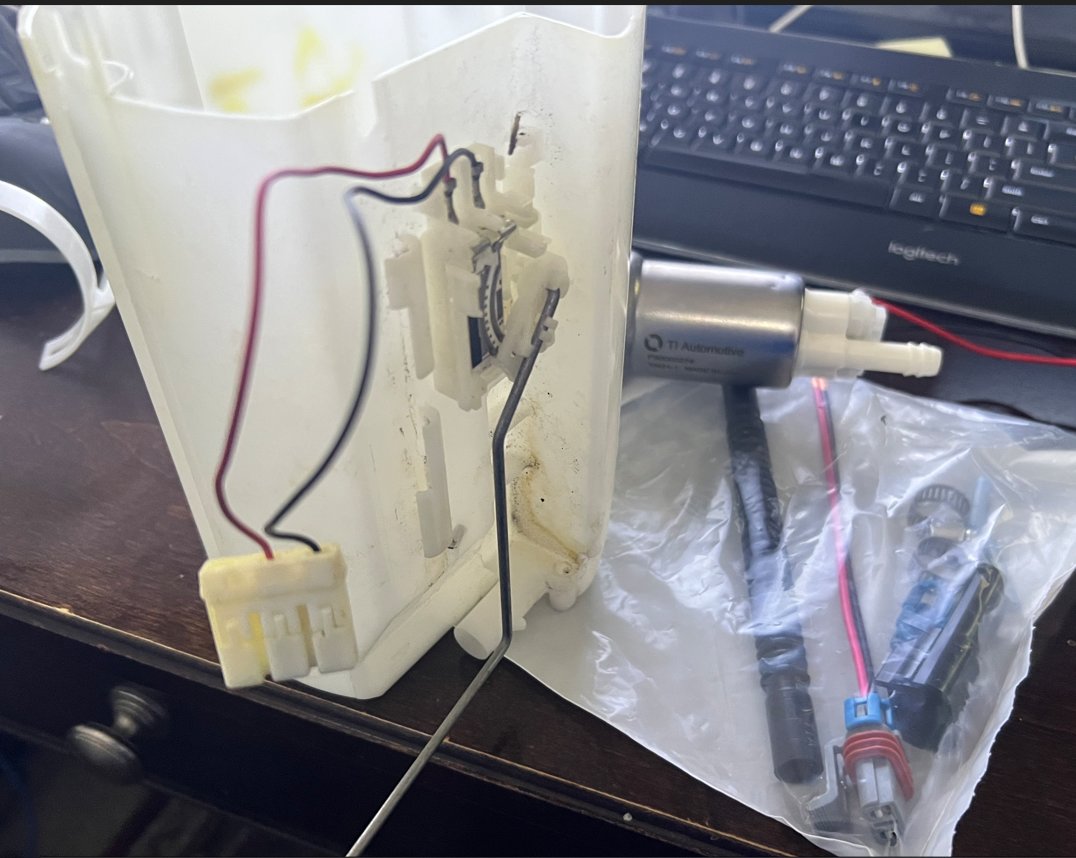

    So I want to use this hose that came with my pump? Is this clamp it also came with ok? Where am I putting the holes? lol

    I thought for a hot minute whether I should dig that stock ptfe hose out of storage and clamp it. But i decided I was too lazy lol. But i was also concerned with how I used a razor blade to cut it to remove originally.
    the holes go on the sidewall towards the bottom. Probably 1/2" off the base.

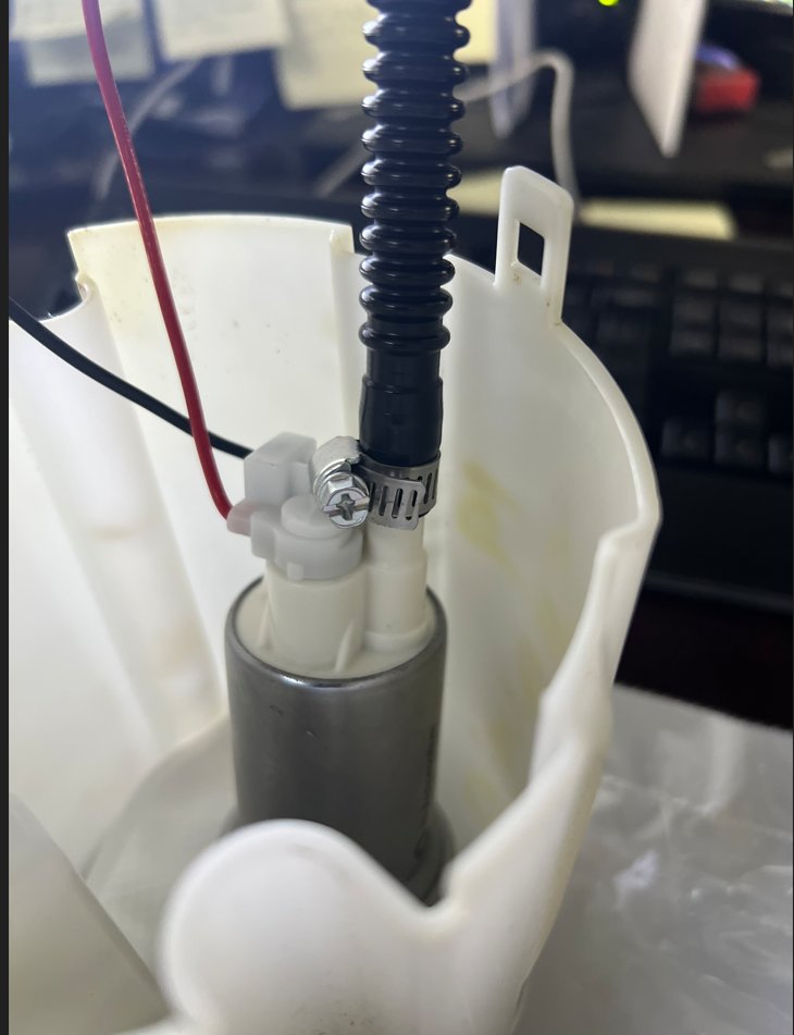

    I am putting my pump together & as I do not want to drop the tank ONCE let alone again, want to be sure it looks ok.
    Red to blue & black to black on the oem harness right?

  29. Mar 1, 2023 at 7:08 AM
    #6179
    HulkSmurf14
    Aug 9, 2019
    #34377
    2,798
    2014 Tundra Limited
    Tastefully enhanced...
    I assume the fender liner area?
  30. Mar 1, 2023 at 7:13 AM
    #6180
    armyoffoo
    armyoffoo Member
    Jun 4, 2018
    #15876
    1,475
    Cypress, TX
    2018 Black TRD Sport CrewMax
    Supercharged with all the trimmings
    That's correct, yes.
