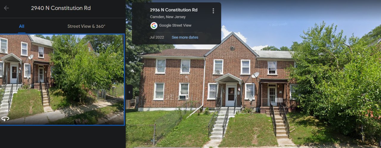

    Ok good @snivilous fish didn’t pull the trigger lol
  9. Feb 27, 2023 at 1:44 PM
    #6099
    snivilous
    snivilous [OP] snivspeedshop.com
    Apr 16, 2019
    #29192
    4,987
    SW UT
    300k+ Supercharged 2008
    Oh really? Well that's good! I texted him an hour ago and he had said then he sent $1000. Was he able to get it back or cancel it?

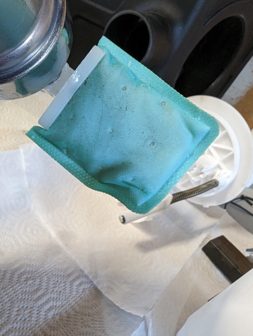

    Unless it's a faulty fuel pump, everything looks fine. Gonna see if I can wire up the pump outside of the tank to check
  22. Feb 27, 2023 at 2:46 PM
    #6112
    V10Ace
    V10Ace New Member
    Jul 6, 2018
    #16793
    559
    Salem, Oregon
    '21 TRD PRO
    Harrop w/ Prospeed goods & Kooks LTs
    What were the e3's gapped at? Did you gap the new ones?
  23. Feb 27, 2023 at 2:49 PM
    #6113
    M3Tundra-JK
    M3Tundra-JK New Member
    May 3, 2022
    #77930
    2,841
    Scott
    2005 GX470

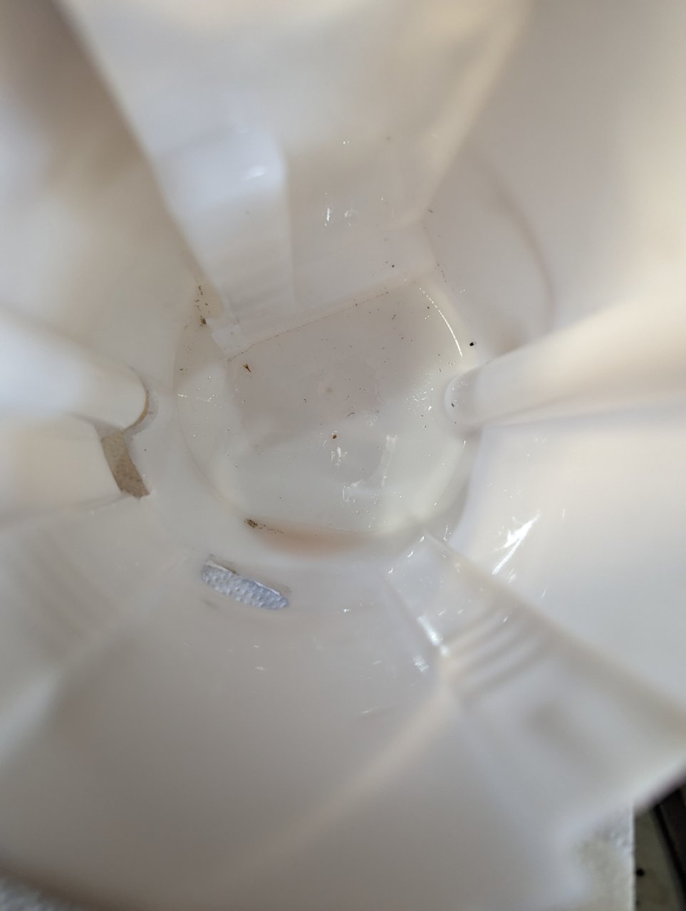

    There is some sediment in the housing but I don't think that'd be enough to clog a filter?

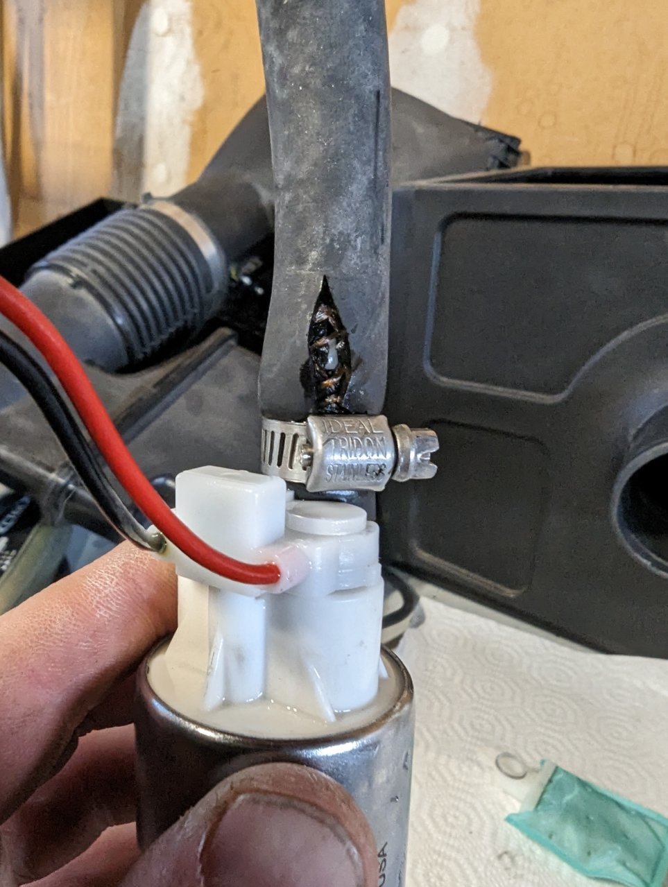

    My first pump I installed was brand new and faulty. It was an aeromotive unit. Swapped in the 450 and boom no issues

    That could be a problem

    Man that sucks, sorry you had to drop the tank again.
    What do you think caused that?

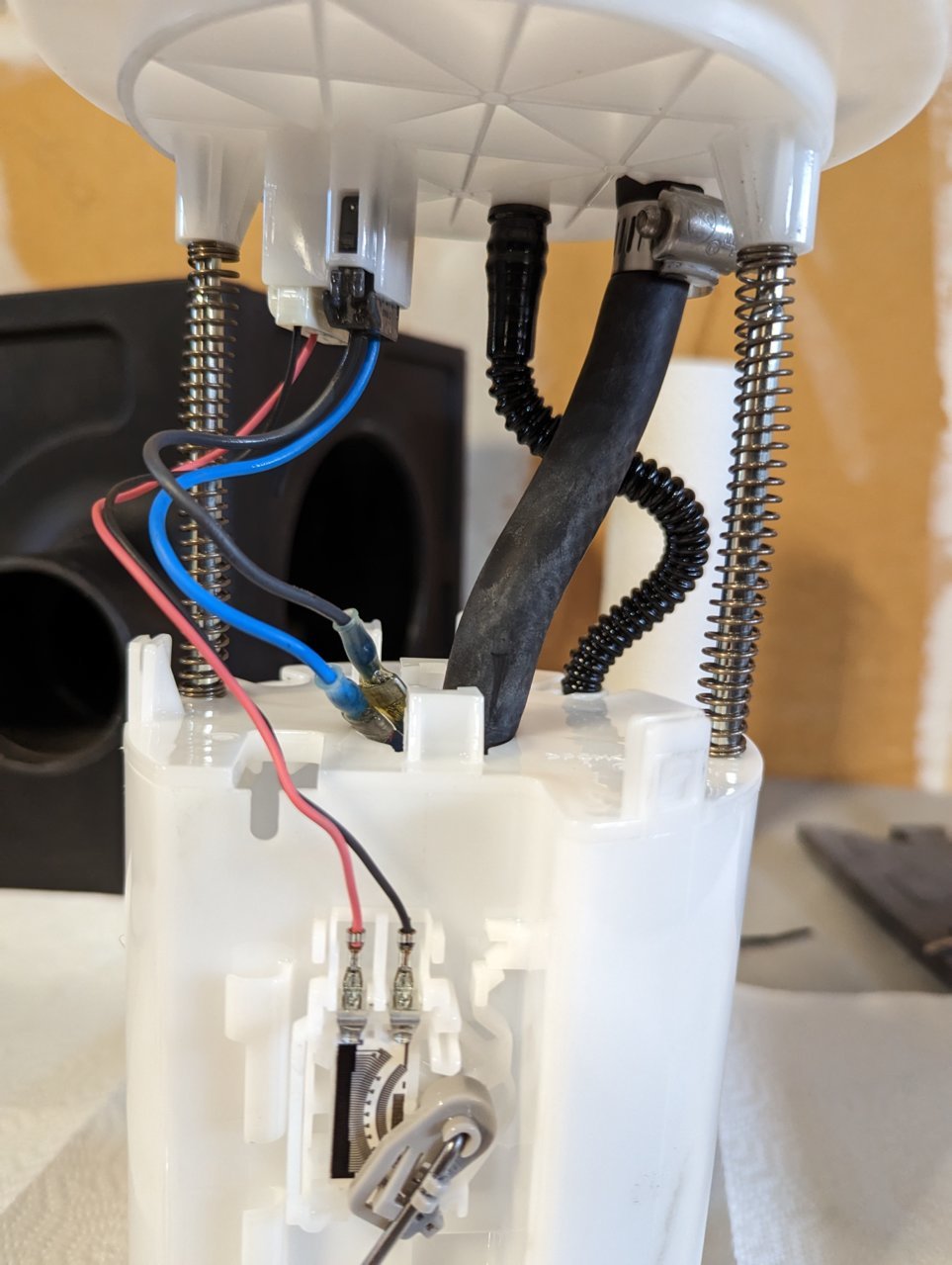

    So here's a tip for anyone changing out the pump and using the thicker rubber fuel lines they sell at the auto store. Make sure that the compressed length of the tube doesn't have any kinks! I thought I had made sure there weren't any to begin with, but it could have happened, the hose clamp could also have cut into the tube.
    So this time I cut out some of the lid so that the hose is more in line with the connection point. Also measured the depth of the tank, 10" and then compressed the lid pump housing to make sure there were no kinks. Uncompressed height of fuel pump housing is around 11". I'm also going to remove the hose clamp I have around the base of the fuel pump holding it in place against the housing. Should allow the pump to move a little instead of kinking the hose also.
    In last pic you can see how hose can kink if too long

    Also make sure it's high pressure rated line. I had a line burst the exact same way on my FJ40 efi conversion, I grabbed some generic fuel line laying around but it was meant for a carburetor and not for 50psi through it.
