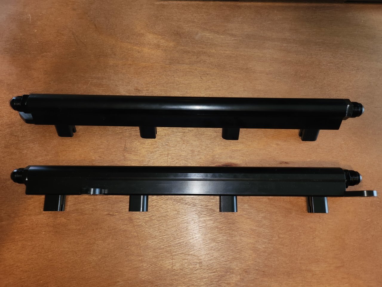

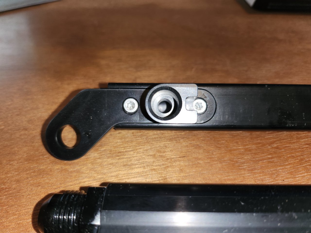

    armyoffoo Member
    Jun 4, 2018
    #15876
    1,474
    Cypress, TX
    2018 Black TRD Sport CrewMax
    Supercharged with all the trimmings
    XAT rails came in and they are beautiful! Fittings were loose, so I'm going to remove and reinstall and check torque on the fasteners as well. I couldn't get a good shot of the inside, but it's so smooth it doesn't look like there are any holes to feed down to the injectors, but they are there and inlet is large as well.
    Fuel rail inner diameter is 3/4", but fittings reduce the diameter.
