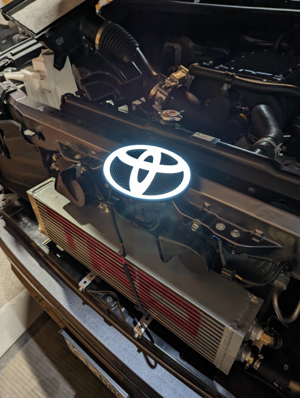

    Intercooler is in. Need to run the hoses that I have to pick up at Autozone. Pretty happy it fit there under the fan, less restriction up top to the radiator, condenser & engine bay& fully open to air!

    Looks like I need a third! Radiator drank up 1.5 gallons. Intercooler had the rest and still needs more.

    I left the fittings out to squeeze the IC in. Upper was worse, ordered a 22mm ratcheting pivoting wrench to get it in the rest of the way.

    How did you end up doing the mounting points down there? Can you take some wider pictures?

    Right now it's compressed under the center support, I need to pull the TRD PRO skid plate & add the supports you told me to get in the kit. I'll take pictures when I'm under there tomorrow.
    I can't find the relay did you use a generic fuel pump kit or how did you do that? I assume any 3/4" ID right angle radiator hose is fine for the return line?
    Here is one I found
    Deatschwerks Fuel Pump Hardwire Installation Kit

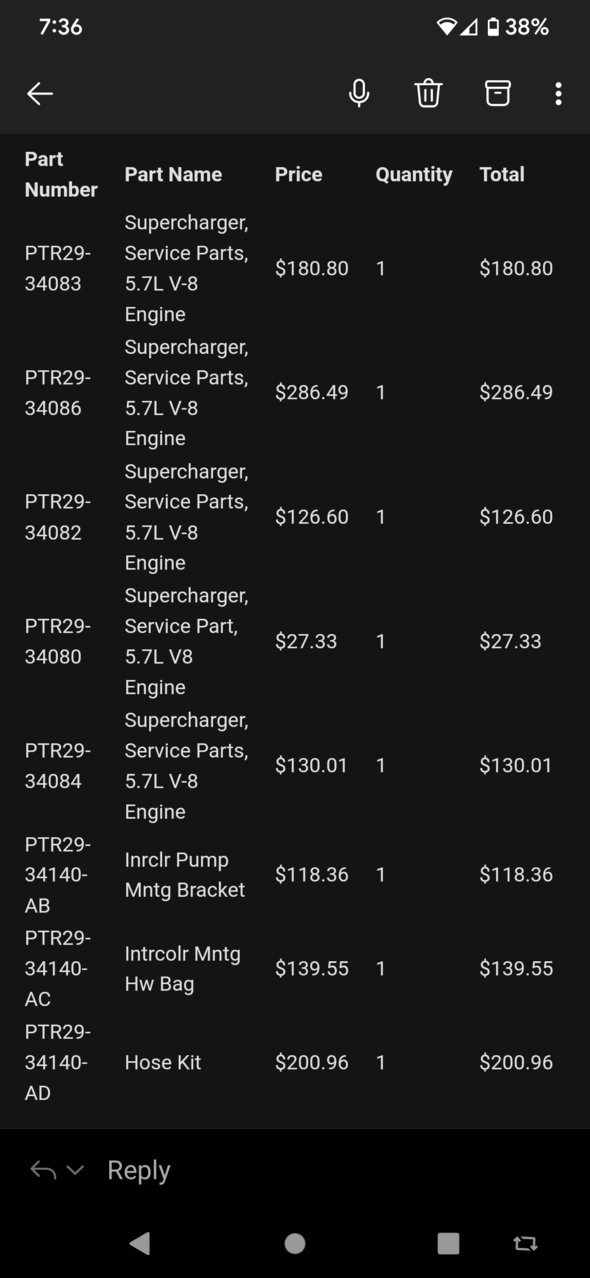

    I bought the wiring kit. It's one of the service parts from the screen shot. You'll have to search em but the description it pulles up should say wiring kit

    Hose Kit - Toyota (PTR29-34140-AD)
    Is the hose kit all the needed hoses for the IC?

    That is ever vacuum and intercooler hoses needed plus the shielding for the hoses. I messed up and ordered the new brake vacuum hose separately, but it was also included in the "hose kit"

    I searched, Toyota's descriptions & "pictures" suck. I decided it has to be what I need & ordered.
