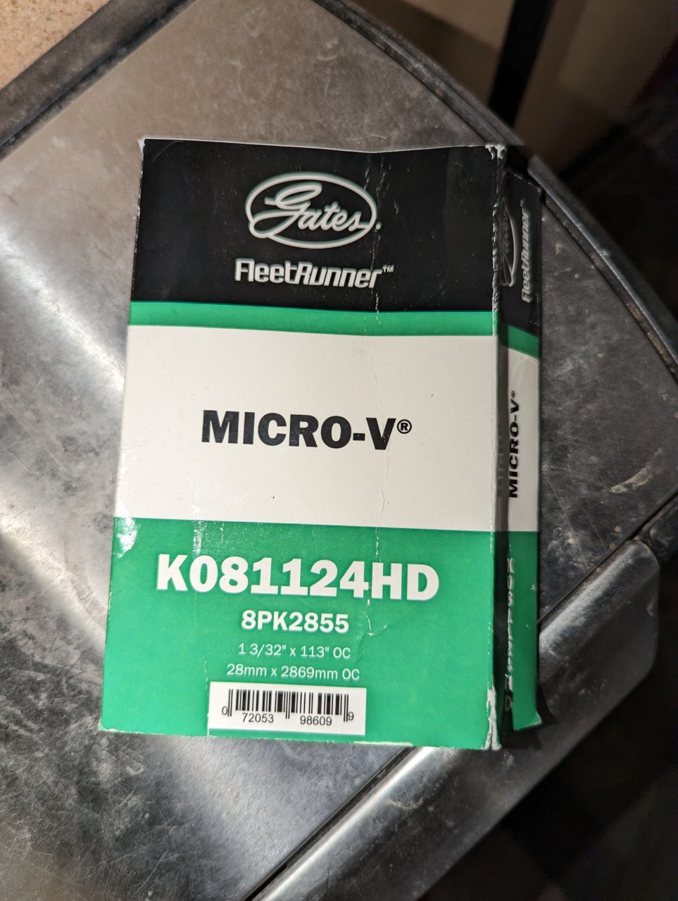

    Thanks, I messed up & ordered the one for Harrop in post 1.
    Gates doesn't make 112.6"?
    Will the Gates K081124HD force on the standard pulley?

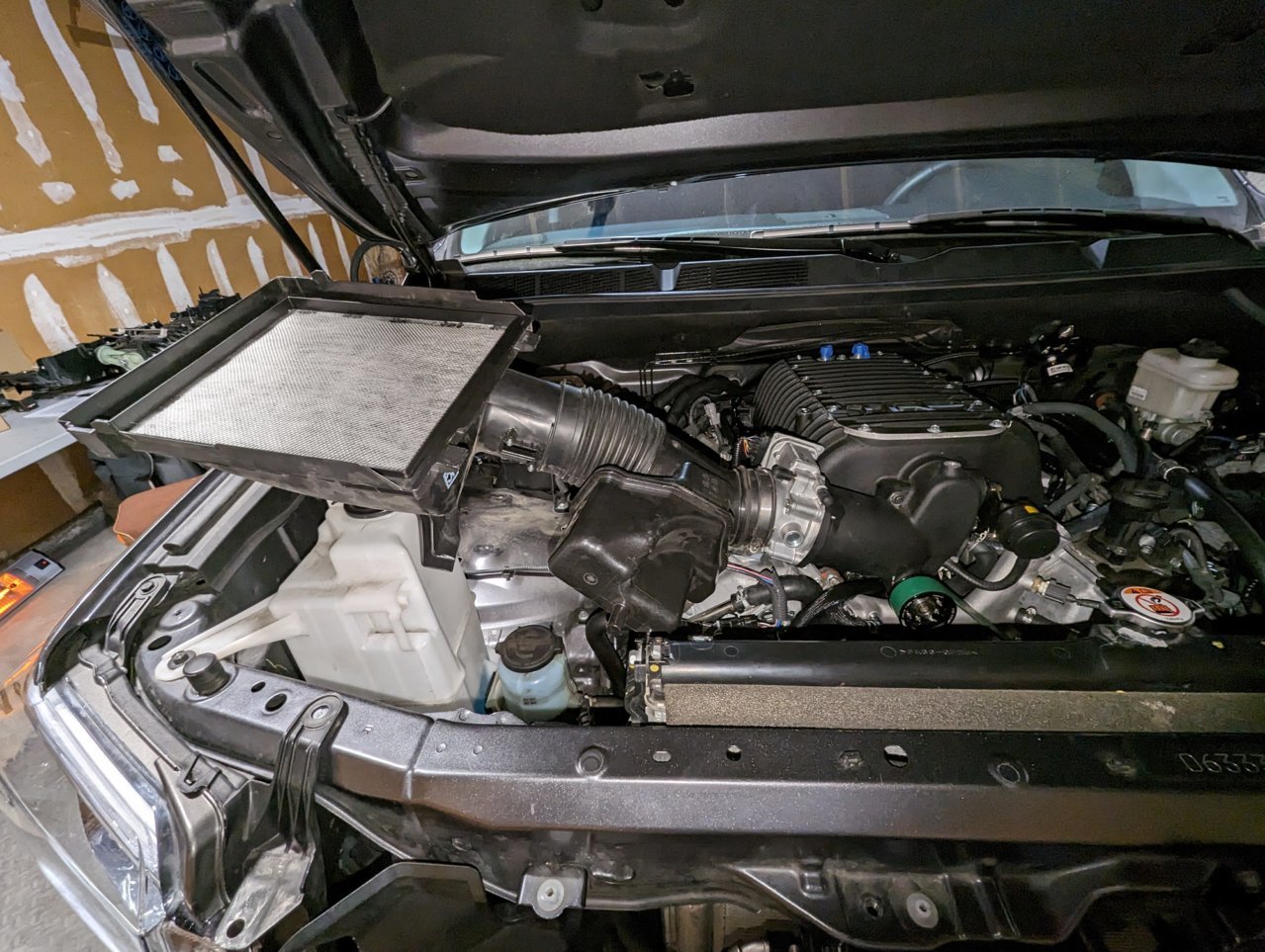

    So talking with OTT, they actually want my stock intake like pictured below, literally the only way it fits. So that they can dial in the injectors first and have a proper MAF curve or baseline. After the 750cc injectors are dialed in, they'll go back and retune the MAF for whatever intake I end up using.

    Whatever it takes. Same conversation I just had with him. I'm surprised, in your case since the Stillen has the same ID, at least on one end, as stock.

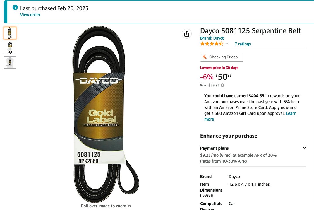

    Ordred the Dayco, prefer Gates :(
    Pretty sure the hood won't close.
    But I can't order the right belt so wtf do I know???

    I mentioned that but he had a good explanation against it. I took rough OD measurements and the Stillen does seem to be marginally larger at the start of the MAF mounting point
    Nope lol, but they only need it for the idle tuning. Can swap over for the driving around tuning.
    Here's the gates belt I ordered and installed. 113"

    Fair enough. It is 3.5" at center MAF. I don't know what effect if any the funnel shape has on accurate measurements though.

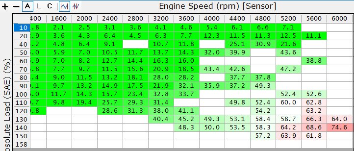

    @ZPhilip installed some 650cc injectors over the weekend and I sent him a new tune for them which appears perfect straight out the gate!
    He has a "stage 1" Harrop with the 85mm pulley, and even with 650cc injectors is seeing 75% duty cycle at 6000rpm! The stock injectors are 372cc--and I would argue that 650cc injectors are the optimal amount for the Harrop since ~80% duty cycle is the rule of thumb for injectors. Even the 535cc TRD Greens--a massive step up over stock--would be getting into the 90%+ range with a stage 1 Harrop. Food for thought anyone looking at injectors, you may want to go over 650cc if you want to step up in the future. This is not to say 650cc won't work with the smaller pulleys, but you might be closer to the limit than you think.
    Injector duty cycle chart:
    Saltyhero13, ZPhilip, Wynnded and 4 others like this.

    I’m at 86% duty cycle in the 650s and 80mm pulley. I’m comfortable with that, but if I added anymore air via pulley or larger intake I’d probably be going to 750s. It’s no wonder the early adopters of the tundra supercharger upgrades experienced a few engine failures, everyone was clearly under fueling.

    I'm at ~68% duty cycle on the PS 750's with an 80mm and afr's in the 10's. One maybe two more revisions left then ill be set with tuning

    Might you hint at how you're getting that particular table, so that one such as myself could see how their green injectors are coping with their setup/environment? :hattip:

    Tunes done. 69% injector duty cycle and the maf hit 5 volts just at redline. Excited to see how it runs
