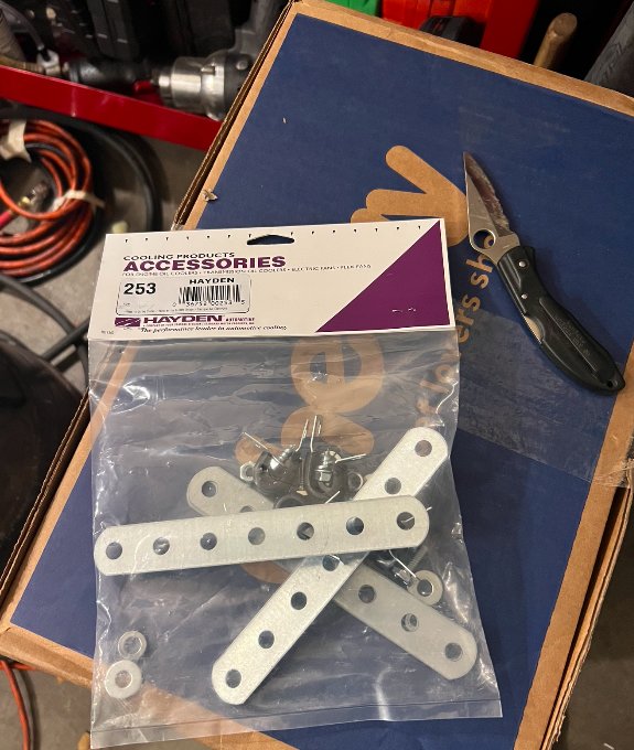

    These came.

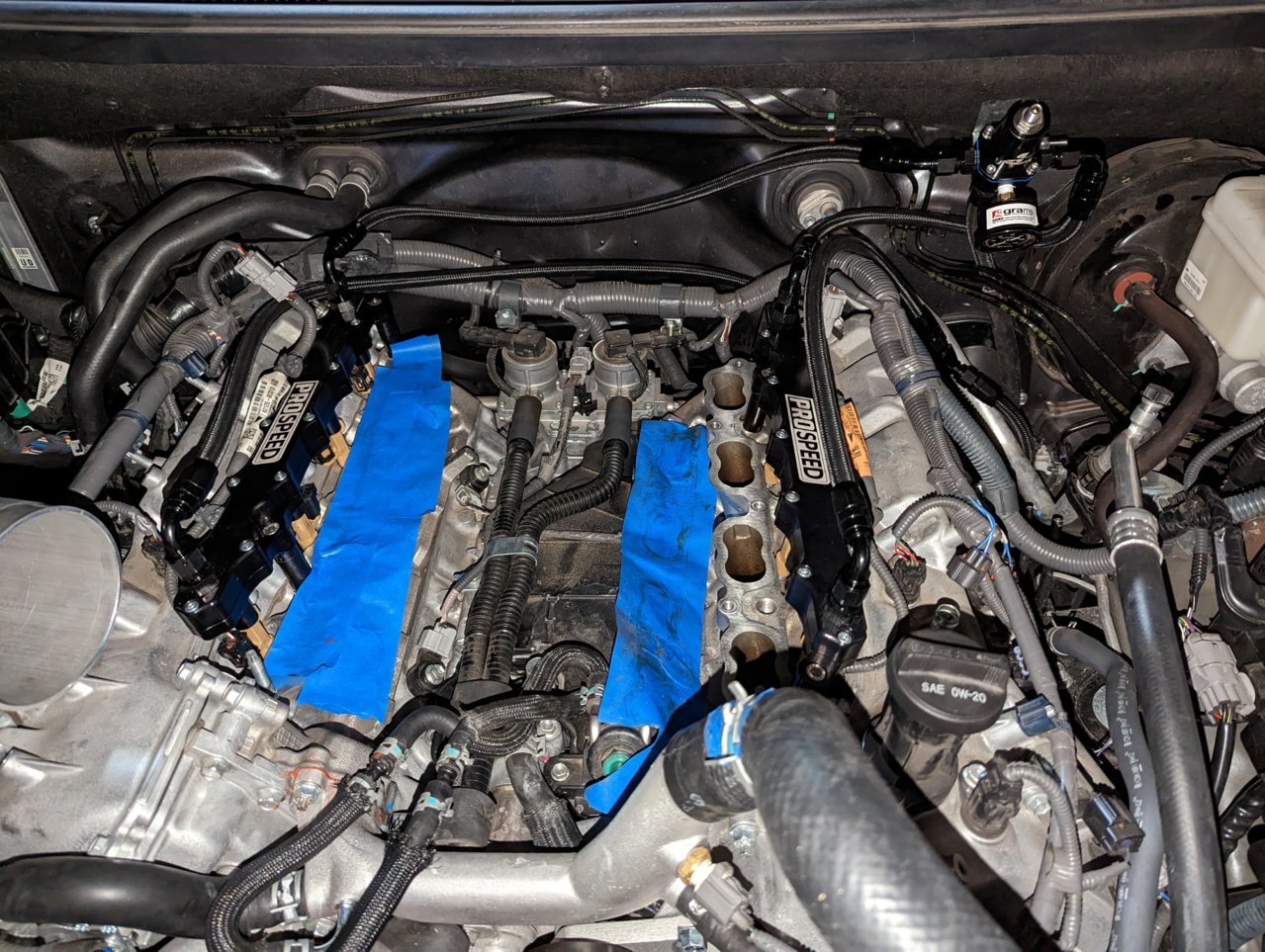

    Got the fuel rails and lines installed. Will work on mounting the s/c tomorrow

    Keep them loose until after you mount the SC, or you will have trouble getting the SC between them.
