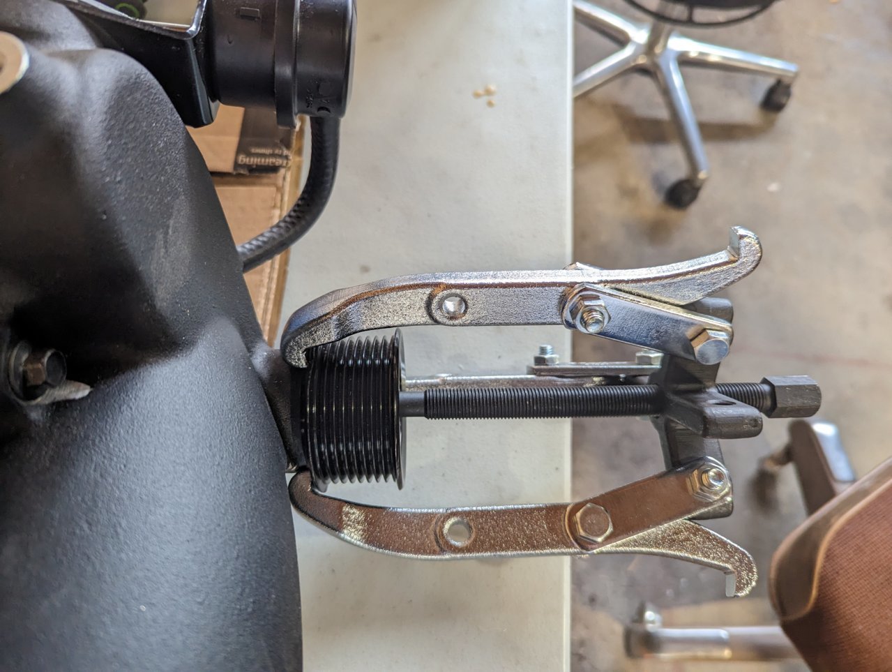

    How did you get the pulley off/did you need the press to install it?

    6 ton pulley puller is required. My 3 ton puller felt like it was gonna break.
    I actually tried the URD Pulley Press tool first, but just like when I did it on the Tacoma, it could only get it installed halfway. I heated up the Tacoma pulley in a toaster oven and that helped enough to get it installed. BUT the Griptec pulley says right on the hub DO NOT HEAT, so that plan was out. The 20 ton press was sooooo much easier and quicker way to do it for sure

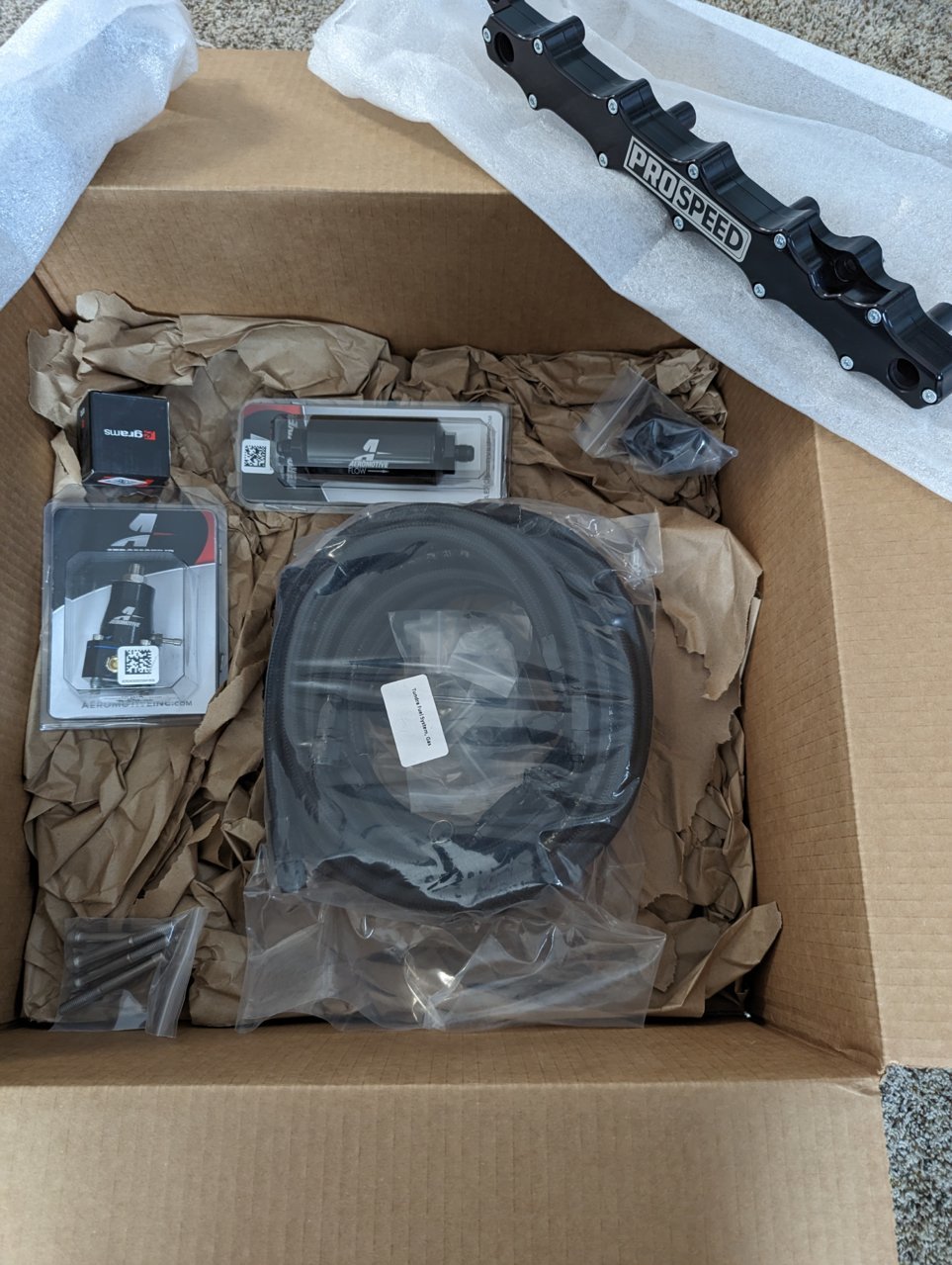

    I will have a used ProSpeed fuel system upgrade available for sale soon!

    New is $2000 without the pump, so I was thinking $1200 since it's been used 2.5 years, about 25K miles. I will include everything included from ProSpeed, the basket top fittings, lines w/y-block, filter (element washable/replaceable), fuel rails, 750cc injectors w/plug adapters, and the fuel pressure regulator. I blew out the lines and wrapped the ends in painters tape to keep them clean. It won't be available until I get the injectors installed and get a follow-up tune though, just FYI.

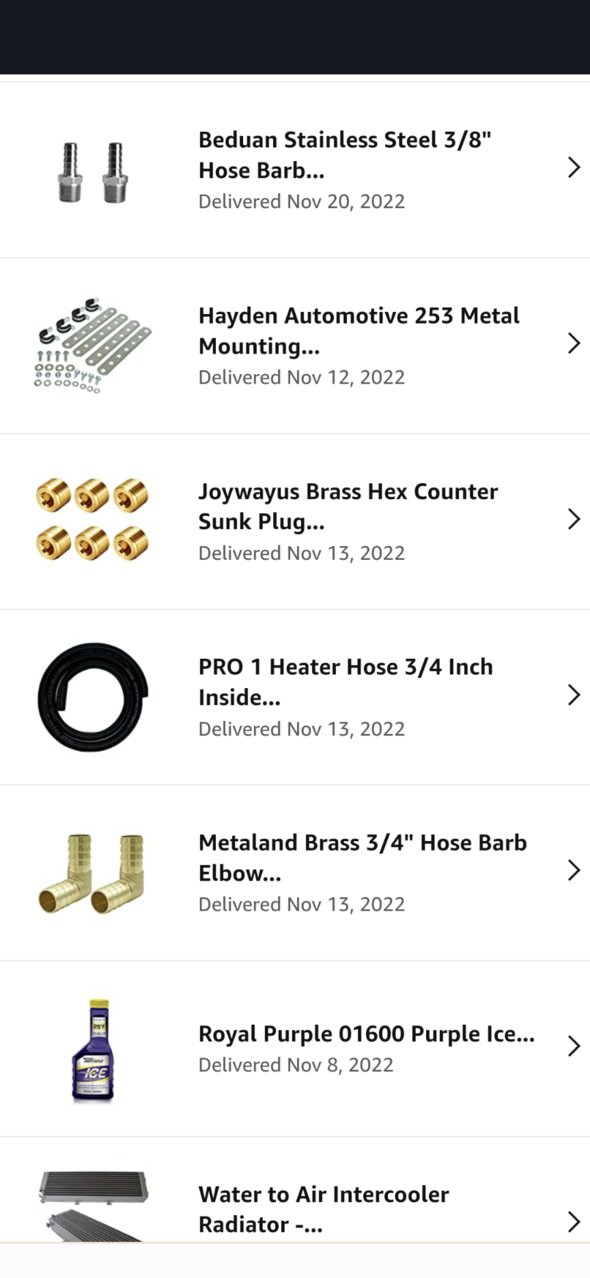

    Here is everything from frozen boost. I always order extra, just in case. Everything else I got from Amazon.

    These are what I need to route the coolant?
