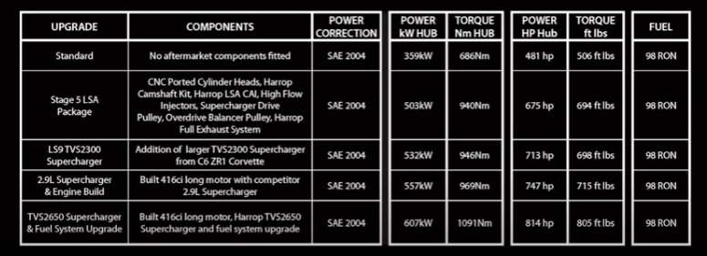

    I noticed at the end, they mention a fuel system upgrade for the 2650 and not for the "2.9L competitor". Wonder if that's what made the difference

    I did notice that. Both are running the same amount of boost, I thought lean was mean? :rofl:
    They made it sound as though the added airflow from the 2650 made it that it required additional fueling compared to the “2.9L competitor”. If the AFRs were safe at 14psi with the 2.9L, not sure what more fuel would really do other than adding additional cylinder/piston cooling. Those engines are generally tuned to run leaner than the 3UR.

    Very interesting that a "smaller" displacement blower is pushing more air through to necessitate adding another pump to feed the same injectors. The upgrade to the larger engine and larger blower didn't net as much as I thought it would, considering the effort and costs involved.

    The difference is efficiency, which is the reason the 2650 makes more power at the same boost level as compared to the 1900 and 2300. More of the energy is directly transferred to airflow without generating additional heat than the other designs.
