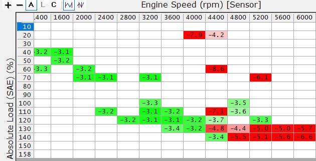

    Continuing the Stage 1 Harrop tuning saga. First datalog back from @ZPhilip and the knock retard is way better. To recap the stock tune:

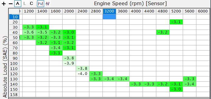

    Versus now:
    So one issue is off the table at least! Nothing else has changed on his truck yet. The injectors are running out of flow starting at 4000rpm and leaning out, by 5500rpm the AFR is creeping into the 12s, and nearing 13 at 6000rpm when the truck shifts. And the MAF is still hitting the ceiling at the top end.
