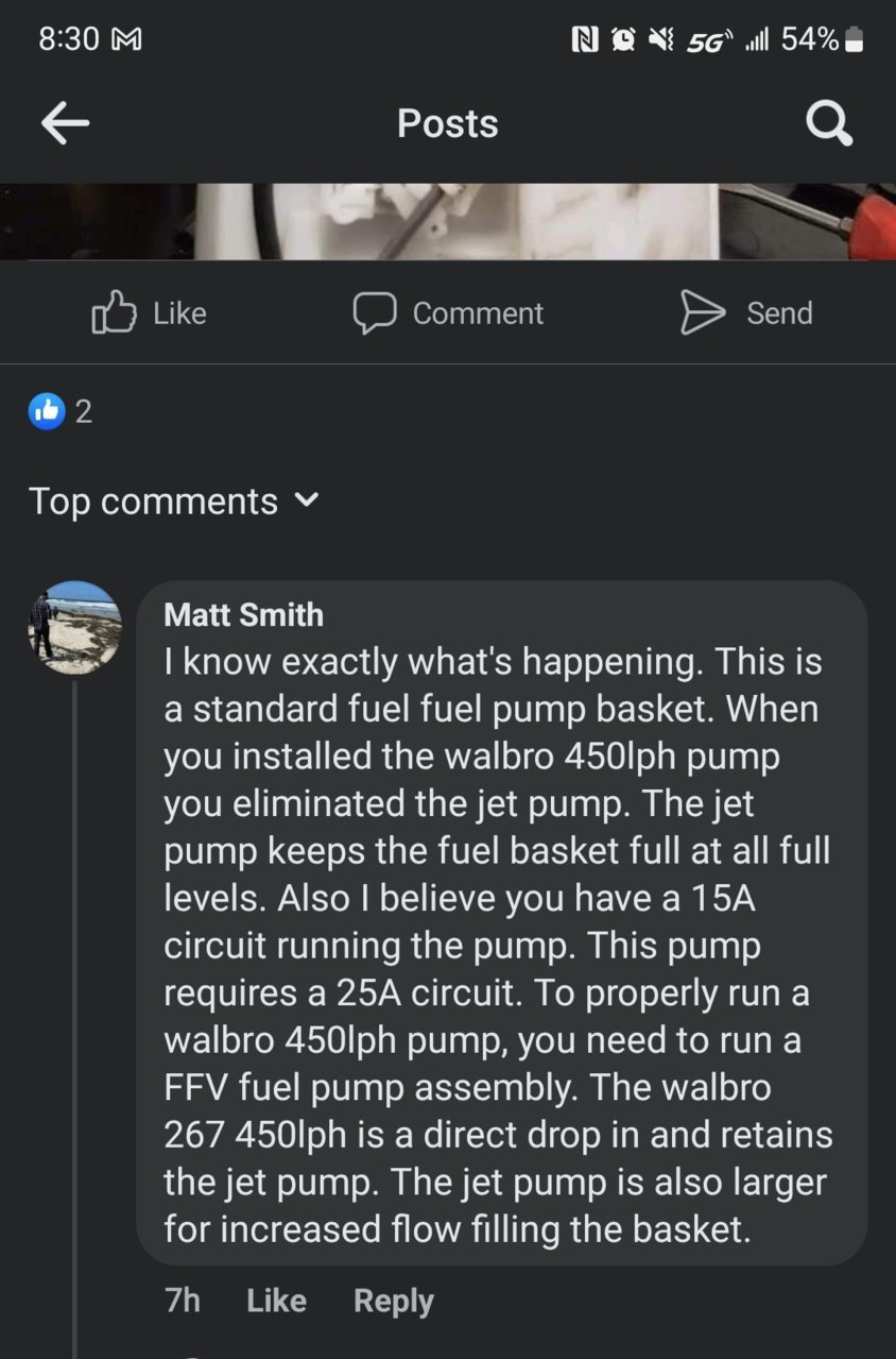

    Matt is definitely very knowledgeable with these trucks, he’s also super helpful. He has installed easily 100+ superchargers on tundras including installs with Prospeed products. I know he worked at SDHQ a while. I’m not familiar with what he’s talking about, but he’s probably right! He will probably help you out further if you message him as well.

    The plot thickens. Not only does PS have garbage customer service but they also don't sell you the correct shit it sounds like.

    Another reason why I wanted to stay away from ordering any parts from them. But as it turns out, their fuel line kit contains everything that the ViktorG cheap fuel lines mod list contains. Except you have to buy their fuel rail to get the line kit. But it does come out cheaper in the end -- would be more expensive for me after buying a separate fuel rail. Fingers crossed that kit come in quickly and correctly...

    Going off what guys have posted in here, including yourself, I'll be fine with the non FFV basket with some modifications to allow more flow. Regarding the 15v vs 25v circuit.. that hasn't been brought up at all anywhere else besides Matt in my findings. That leads me to believe majority are running off a 15v circuit. PS advertises the pump I received as a direct drop in with no mention of a jet pump.

    If you’re able to find a way to, I’d just skip the fuel rails and try and incorporate the aftermarket fuel lines and run them in parallel. I truly don’t think the rails themselves are necessary at stock engine power levels, but I guess that’s just my opinion which I do believe is shared by some other well respected tundra experts. I’ve seen Matt Smith put OEM FFV FPRs on each rail which are 60psi FPRs.

    I feel youd be blowing fuses if your circuit was insufficient.

    Agreed...the best and only value in what I received from them...it was superior to my original TRD tune and I just haven't bothered in buying another tuning cable, credits, paitence-training to have another tune for me...however, there is a LOT more everything with HPt in terms of tuning...if anything, just the ease to do it...when pulley comes in and injectors are on order, I'll be updating my tune with a larger smile!

    I agree that they aren't necessary. I'm just done ordering different parts to make the ViktorG mod work in my application when it seems some needed connections changed. Also I didn't realize the ps line kit is all pre-assembled and has the same components. Learning as I go still
