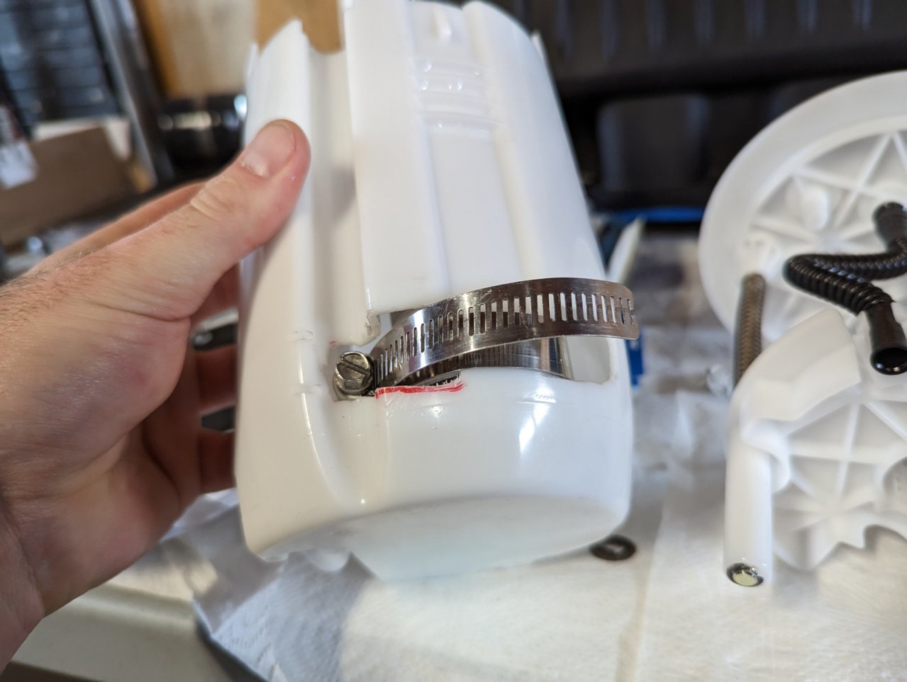

    Here's how holes look (SFW!)
    Had to recess the hose clamp a little so it clears the fuel tank opening on reinstall
    I suggest people use the Tacoma URD fuel pump instructions, they're better than ProSpeed and it's literally the exact same job
