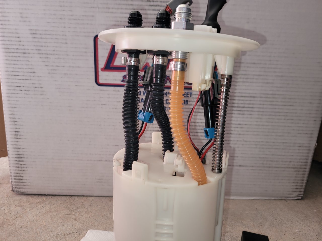

    Pump's out.. They're going to replace this plastic crap with fuel rated rubber hose and see what that gets us.

    Nice, those "hoses" remind me of big gulp straws that sound like elk bugles when you blow thru them! Ahhh, memory lane...actual rubber hose will be better...glad they're acknowledging your despair!

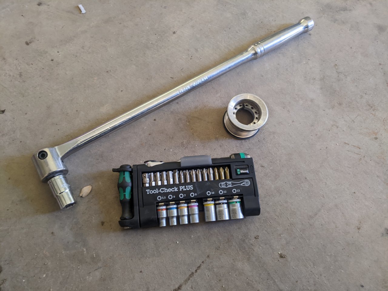

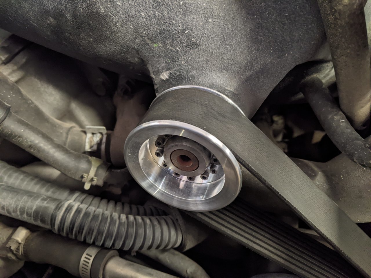

    12 minutes and 45 seconds later and we are back to a 2.30" pulley! I'll run this for the next two weeks since I'm driving to LA this weekend and then back near Barstow with a trailer for an off-road event next week.

    OK, who was holding the stopwatch? Lol
    Looks good.. Enjoy your trip!

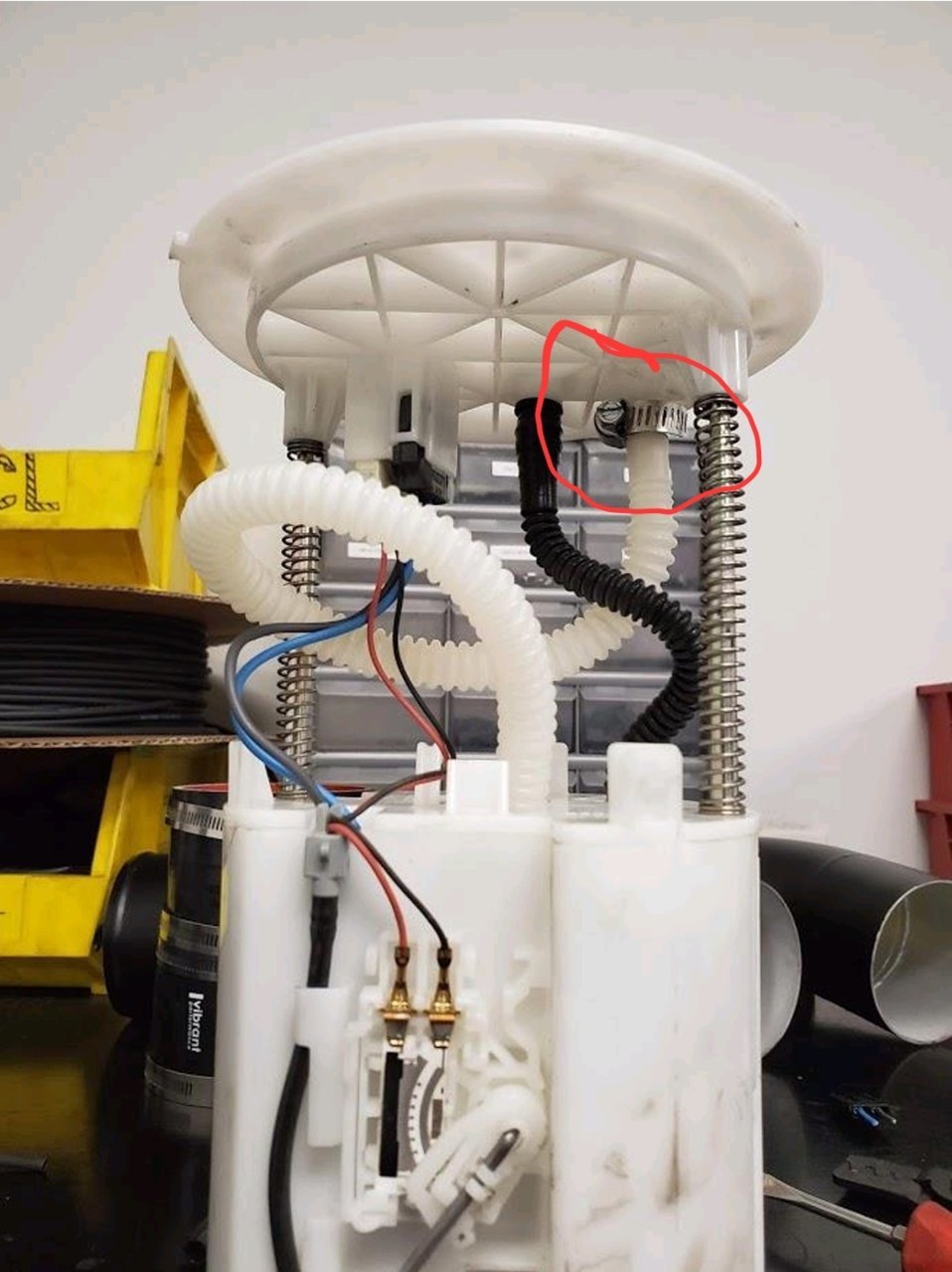

    That is actually PTFE tubing, it's preferred over fuel-safe rubber for in tank plumbing as it's ethanol safe. Your connection looks good, see a little bulge from the barb fitting under the clamp, shouldn't be leaking past that.
    I actually tested mine, I put the assembly in a 5 gal bucket of gas and pumped it through my regulator and back into the bucket, cranked it up to 80PSI with no leaks from fittings. I had two 2x4s across the top of the bucket with the assembly hanging between it, zip tied down for safety of course, and return going back through the top as it would have in the truck
    Here's mine:

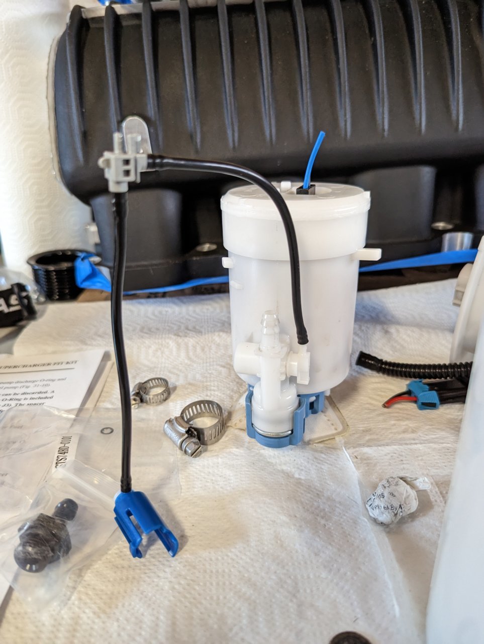

    They can remove that tiny black hose with the tiny grey connector at the top. It doesn't do anything anymore. It also connects down to a blue thingie that slips over the bottom fuel inlet. Doubt it makes any difference, really, but it's unnecessary after removing the factory pump housing

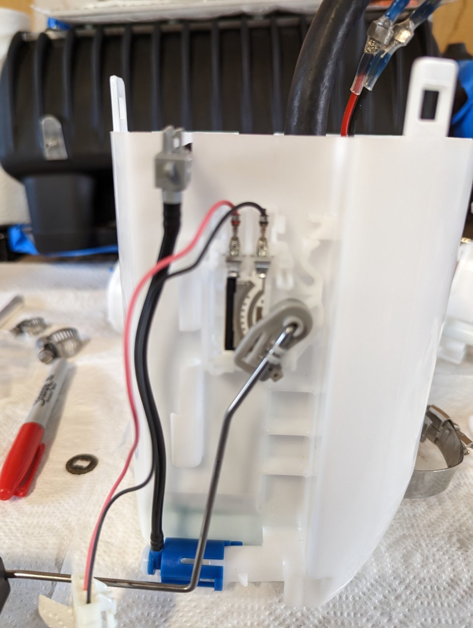

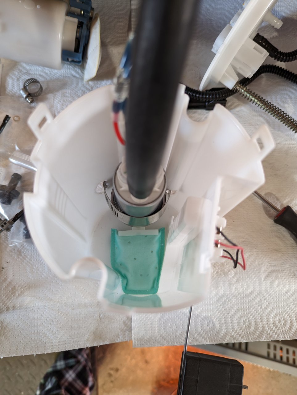

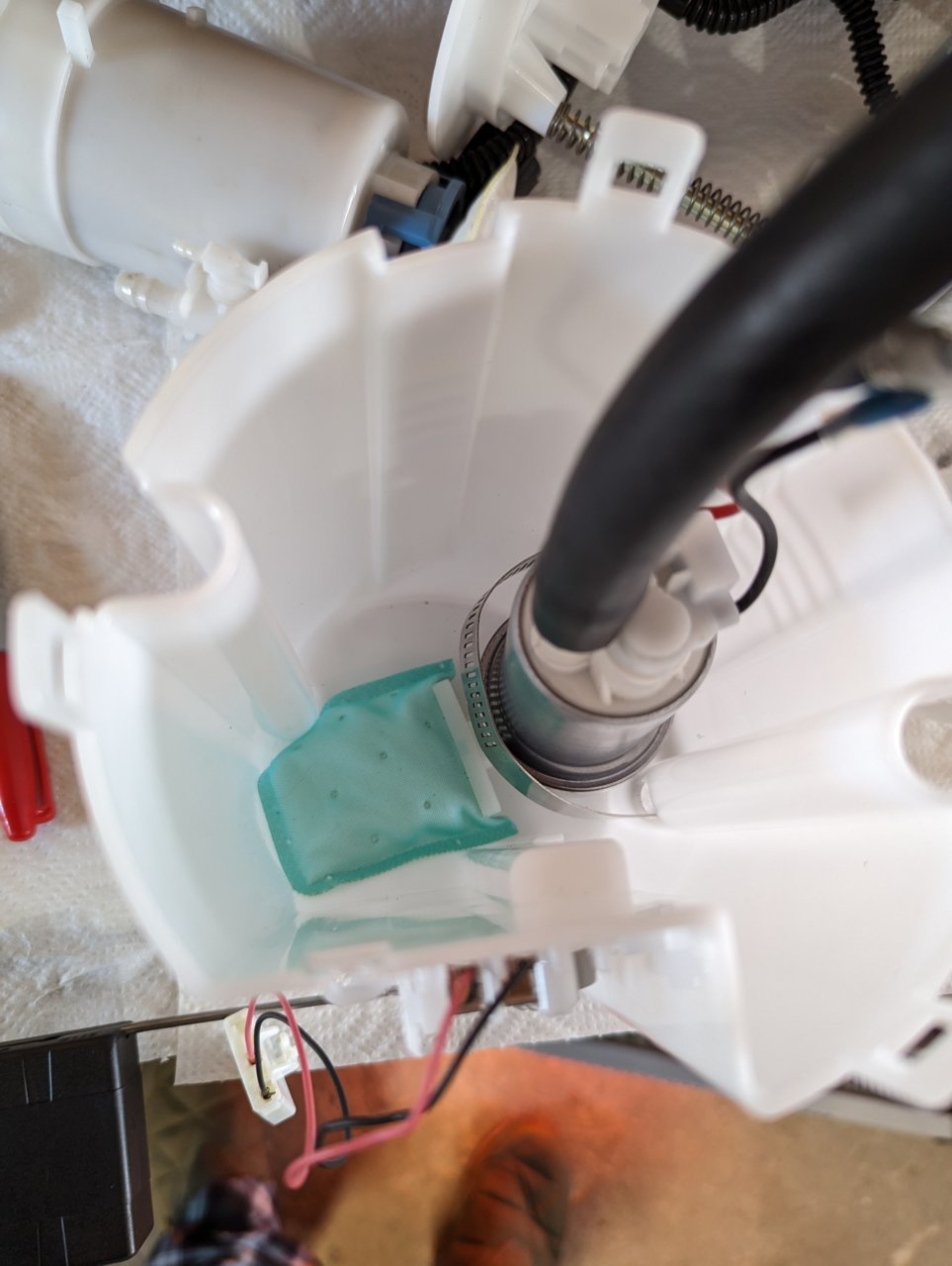

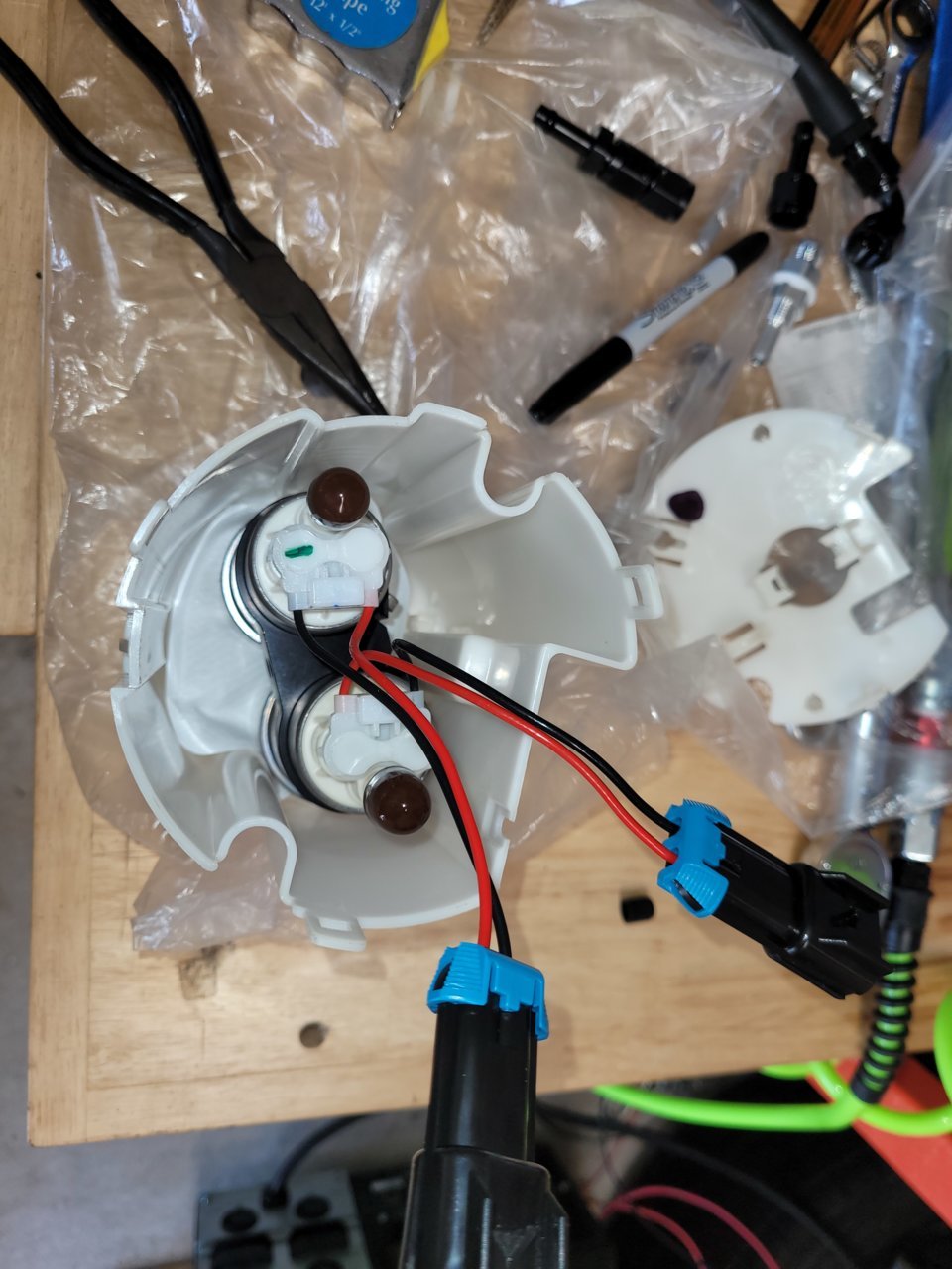

    Here's mine, and picks of the tiny line to remove
    I'm trying to finish up the tank stuff today and get it reinstalled tomorrow
