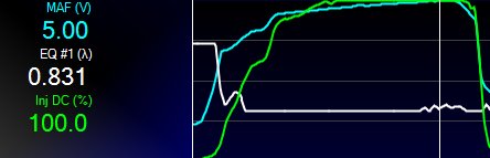

    Added money to it.
    You’d think with all their engineering wisdom that the TRD tune wouldn’t be crap. Might be a while but I’d like to see some logs on a gen 3. Maybe forced induction isn’t Toyota’s strong suit

    Thanks for showing some hard data! Looks like if you’re supercharged and running anything other than a custom tune you are doing yourself and your engine a disservice. It’s amazing Even Prospeed pushes selling the stage1 so hard as they should know better. The delayed throttle enrichment is also super sketchy on the stock tune with boost. As much as two trucks with the same mods should be the same when it comes to the tune there’s obviously a lot of variables and a cookie cutter tune just can’t work that well. If you’re really getting into more tuning for others @snivilous I may hit you up to work on mine soon. I can’t see starting from scratch with an all new tune from someone else just to address my intake swap, but if DAP doesn’t respond to me I have to reconsider options.

    Yea I was shocked when I opened the file. One of those issues I could understand, but issues with fuel/air/spark all occurring simultaneously makes me think it's not a fluke of his truck. And agreed on the delayed enrichment, the stock tune ZPhilip has doesn't start enrichment until 70deg of throttle. Compare that to the TRD tune which starts fueling at 40deg (my personal tune starts fueling at 30deg). So the TRD/Magnuson is richening the engine out almost twice as early as the stock tune!
    I think tuning vehicle's is fun, as I told ZPhilip, this is a small side hobby and I'm not trying to make money or spend a lot of time on this. But I know him and lots of others have issues finding people locally (or even remotely) that will tune their vehicle. I think I can cheaply get a tune that is at 90-95% of what a professional tuning house will do and make someone very happy, and certainly set them up with a much better tune than what they currently have, if nothing else then to use as a bridge until they can get a professional tuner to work with them. I was talking to someone earlier this week that it was like $750 for a tune from OTT. I'm not trying to compete with that, I'm just happy to provide a better-than-stock alternative for like $200 or less.

    Good to see the actual data. This was an early "finding" discussed in this thread buried several pages back. Now we have the data to support the conclusion. Thanks for sharing this.

    I just finished my first tune with John at OTT and my stock magnuson setup was also leaning out up top. My innovate wideband was showing 12.6-12.7 in the upper rpm ranges. He was able to make some changes and get me down to the 11.5 range. I will be changing the pump, injectors and pulley and then making adjustments after that

    Its leaning out too much under WOT.. afr's in the 12's when it should be in the 9's super rich with Chris @ PS initial tune. Chris said to pull pump back out and check for loose connections. Hopefully today we'll get it out.

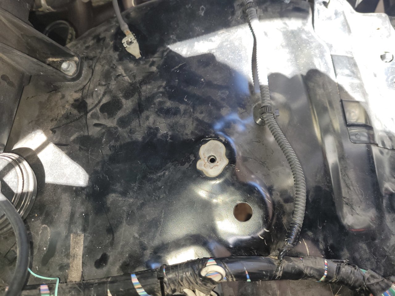

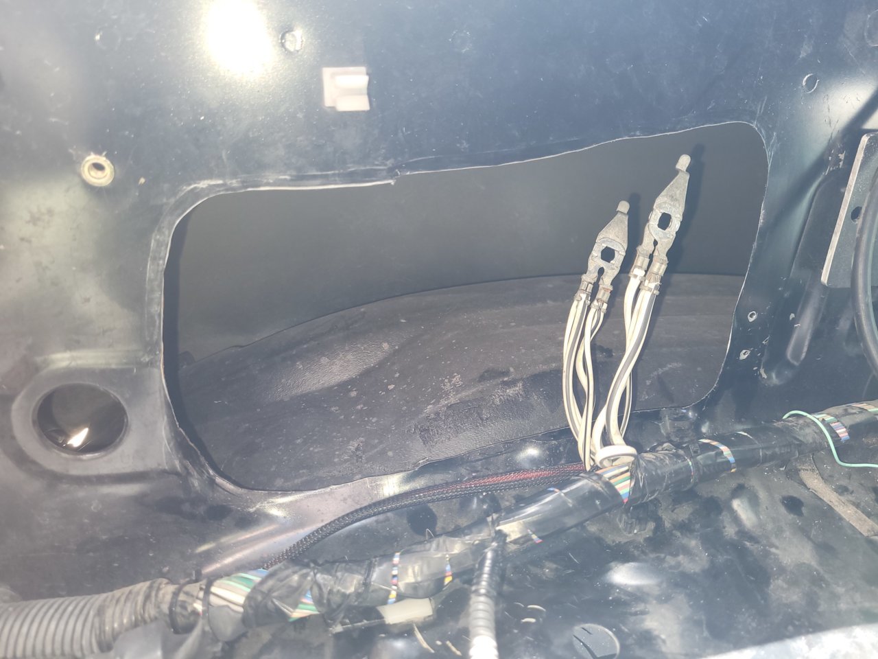

    Check if they moved your grounds from the inner fender to under the air filter...according to the wiring diagram, that is where the fuel pump voltage regulator grounds and when they did mine they did a shit job relocating and it wasn't sitting flush. I suspected this as causing the pressure drop they were seeing, since it regulates voltage to the pump based on engine load, so I moved the grounds back to the inner fender and then I ran dedicated pump wiring just to be sure I always had 12v.

    Big shout out to @snivilous for helping me in my situation! I am hoping getting this data out there will help others in the future. I would have made getting the tune done a priority and not waited. No local tuners and finding a remote tuner has been a challenge!
    Let's hope I haven't done permanent engine damage while driving untuned for 8000 miles. :(

    These grounds
    Were moved to here
