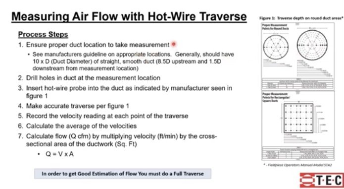

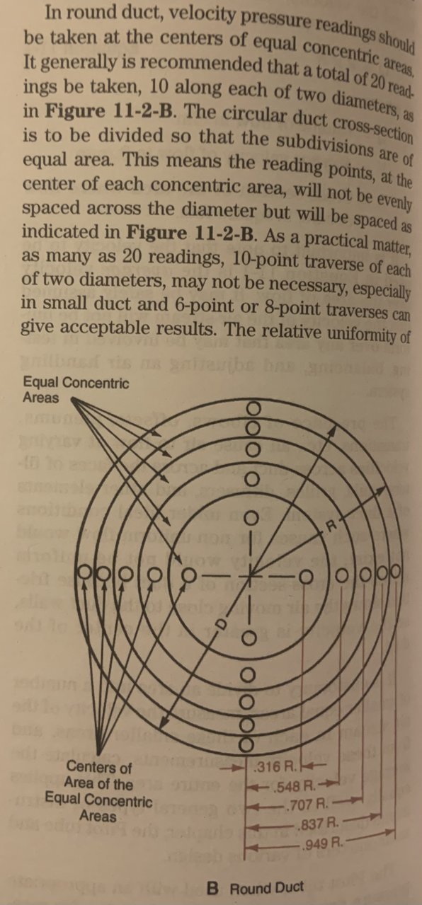

    It was covered above but the supercharger has nothing to do with it. The air straighteners are solely about improving the laminar flow across the MAF for more accurate measurement of the air, and subsequently more accurate fueling. A straightener becomes more important when there is minimal length of straight tubing before the MAF sensor which is exactly how these OEM intake boxes are set up. Air flow through a MAF tube is very similar to air through a duct or water through a pipe. I’m not claiming to have an engineer level of understanding, but I’m familiar with the concepts from prior education. I’ve seen similar devices in my field that serve essentially the same purpose (pump suction diffusers to straighten the water flow into centrifugal pumps, perforated diffuser plates in air handlers to get even airflow across evaporator coils, etc.) This is not a made up concept by someone in their basement who likes to play with aluminum honeycomb, it is employed in real life mechanical applications.
    Attached is from one of my air balance books. It shows how many different pressure readings need to be taken in a round duct with a pitot tube to get the true average pressure in the duct due to turbulence which can then be averaged to determine the CFM. Even a small duct requires at least 8 different measurements to be accurate. The same test can also be done with an alternate tool called a hot wire anemometer. A MAF sensor IS a hot wire manometer.

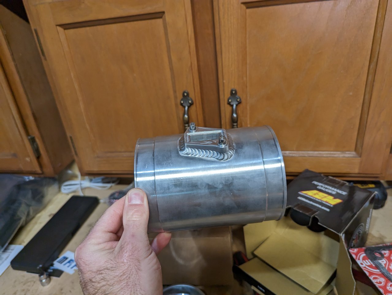

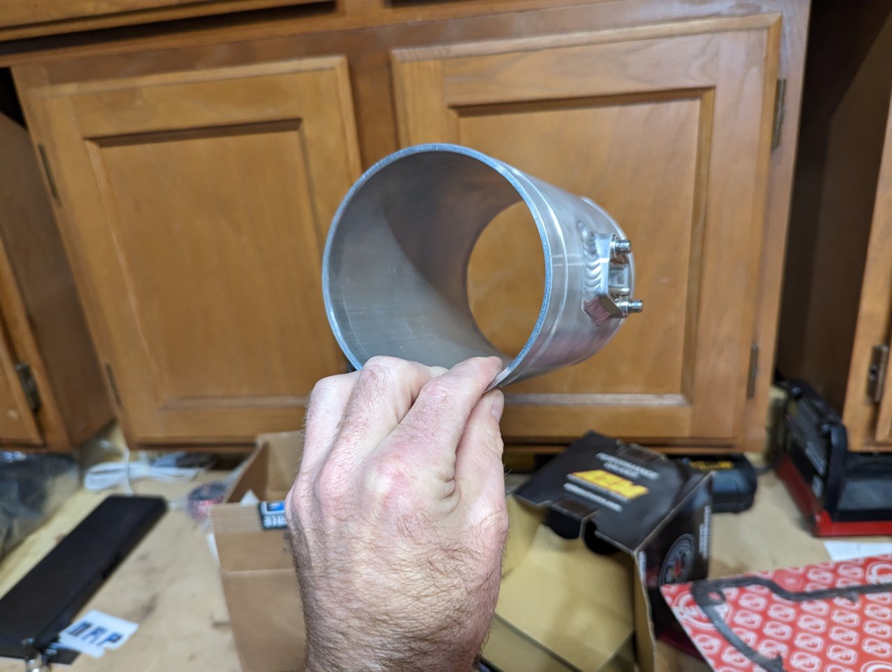

    fwiw, the original tube I ordered didn't come with a straightener. Still waiting on the 3d printed stillen adapter to order a custom tube from MRP

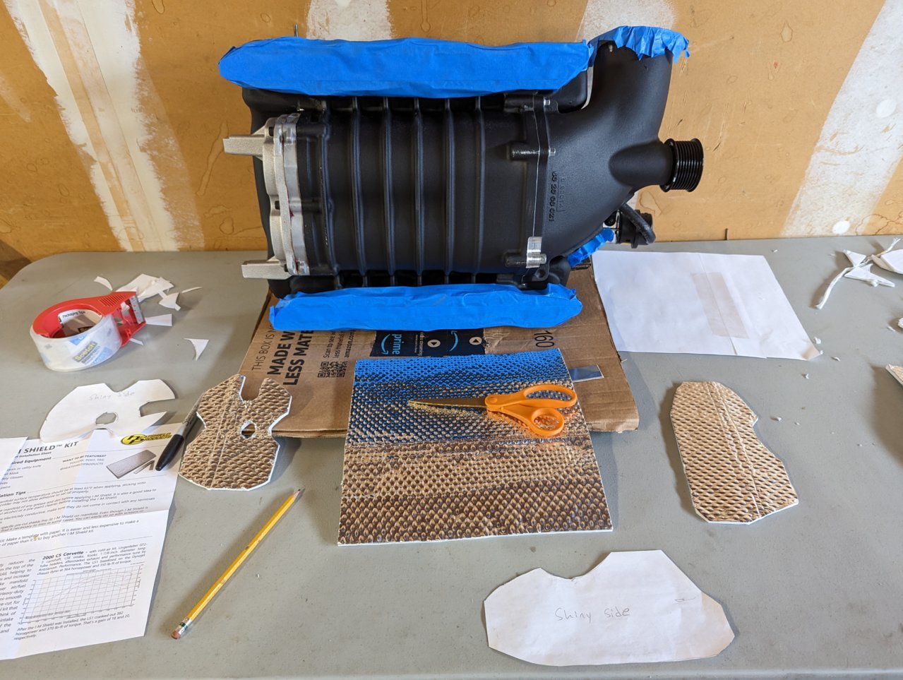

    Working shiny stuff today

    4.5" straight through

    Turning out pretty good. Have plenty left over still
