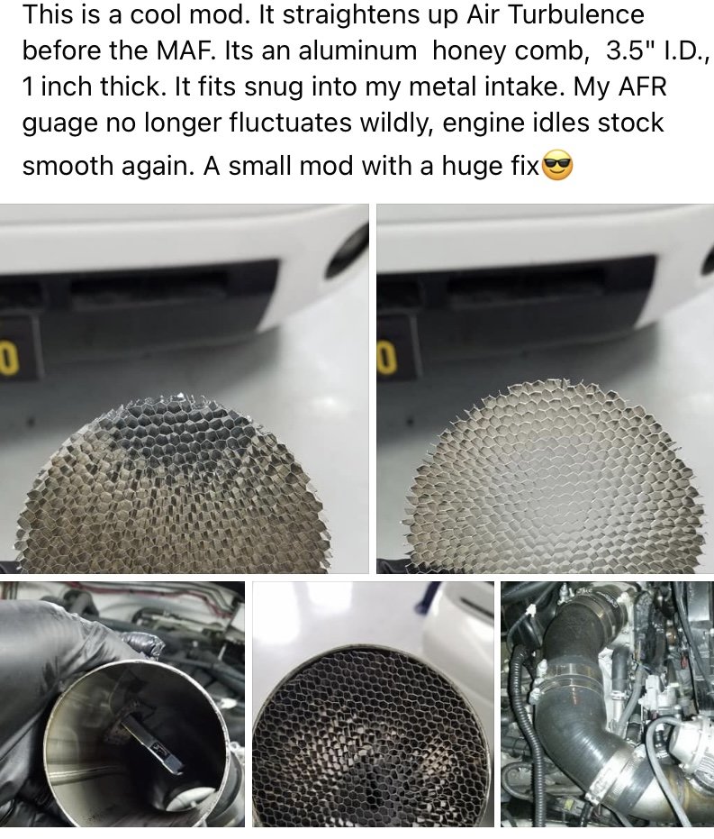

    Also, this has me wanting to try some of this honeycomb stuff. You can buy a sheet of it and cut it to whatever size you need. This was on a remote turbo tundra. My AFR gauge fluctuates wildly as well and I think it’s partially related to my 3.5” intake moving so much more air and causing turbulence (which will soon be replaced with the 4”). I’d be curious if it would fix it.

    When I see that honeycomb stuff...my first thought is air restriction.

    No doubt it is a sacrifice of some total flow for a more uniform flow and a better MAF reading. This same concept is applied across many industries including refrigeration. Next time you’re at the grocery story look in the top of the fridge/freezer case and you will often see honeycomb air straighteners. They improve the performance quite a bit in that application.

    yes. but maximum flow is not the goal of those examples.
    I doubt uniform flow is a material variable in the intake side of the motor. its too darn short to matter.
    What evidence do we have to support the theory of turbulence creating a faulty MAF reading? are your MAF reading really faulty?

    I don’t know that we do have evidence, other than the 1 example I cited above that resolved the rapidly fluctuation AFR that I am currently experiencing. My thought was perhaps it’s worth a try for $35 to resolve that issue and have greater confidence in my AFR reading and thereby safety of my engine. The MRP website shows Short term fuel trim variance improvement with the honeycomb installed, going from about 25% +/- variance to 12% +/- variance. You haven’t even had eyes on your AFR on a wideband yet, so yours may be doing the same thing as mine with the 3.5” intake.

    could be. my AFR drops to minimum (11.9 - still on OBD narrow band) as soon as I give it the beans.
    I could see how this could be an issue, but not a huge issue....I think the blower negates all the turbulence issues by yanking all that air in. The turbulence goes away once it gets all skwished under the blower.
    and, my guess, it's only going to be an issue at the top end of the RPM range.
    and, what are the effects of the added resistance to our already anemic 3.5" inlet?

    No doubt, the blower does nothing but create turbulence lol. The turbulence for the sake of the blower inlet and combustion is not the concern though, it’s the effect the turbulence has on the MAF to properly do it’s job. Considering the MAF is in control of reading all of the airflow accurately, which the computer then uses to accurately control the fueling it is worth talking about. I probably won’t bother with it on the 3.5” intake anyway since I’m changing it out but I’d be curious if it would help with a larger 4-4.5” intake as well. I’ll see how the AFR looks once it’s installed.

    I see now.
    if this turbulence is mucking the MAF then fueling will be wrong.
    and I agree..make the intake bigger before jacking with any perceived turbulence issues.

    I’ve been doing some more MAF research. Sounds like there’s a good chance a straightener screen may also fix the occasional P0101 code that pops up especially when I’m towing. There must be a reason that a majority of OEM’s use a MAF sensor that is a one piece tube with an integrated honeycomb built in. The Toyota setup is frankly more crude than a lot of other MAFs. Here’s a good video that shows how even the air washing over the filter from the radiator fan can effect the MAF sensor reading. Air stratifies quite a bit when flowing fast through a tube, the inner most air will travel faster than the air on the outside edge. It makes total sense to straighten it out and get a better average reading in the one little spot the sensor is reading. To measure the airflow in ducts for example, you can’t get an accurate measurement by just taking one static pressure measurement. You have to break the duct up into a grid type pattern and take a ton of readings (called traversing the duct) and average the static pressure to figure out the CFM. After some research I intend to use the straightener screen personally.

    Just glue a bunch of straws together :D
