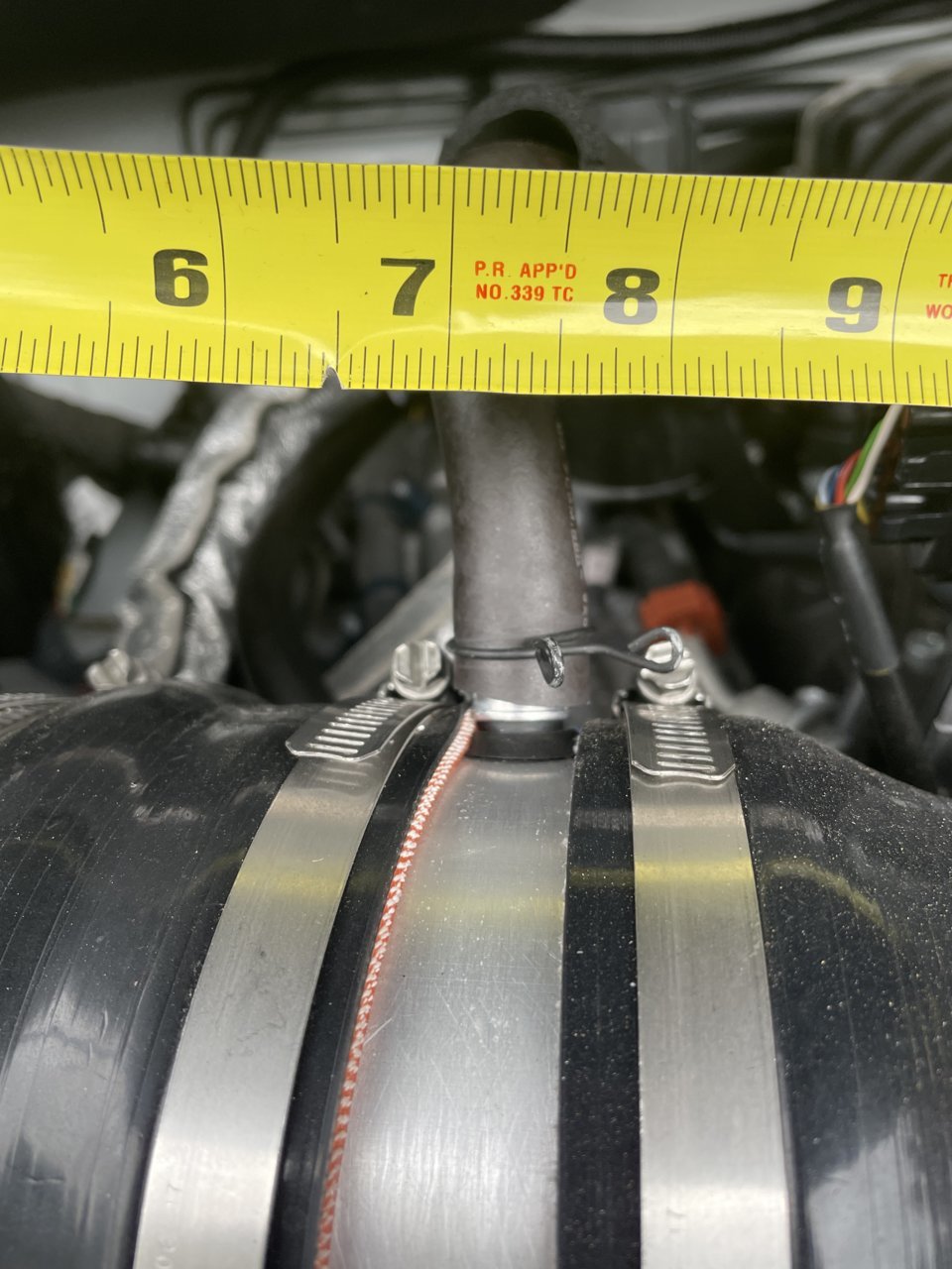

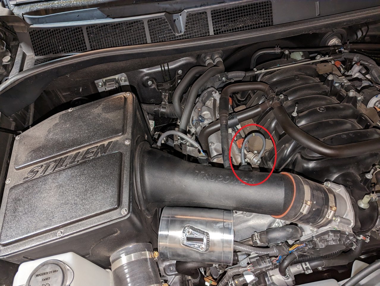

    More curious about this little guy. If I can get MRP to install both line fittings that'd be ideal. Just couldn't tell what that is used for/if it's used on the s/c'd applications

    Not sure but great question. Would have to review install instructions on Harrop to see where that gets fitted.

    On the Harrop they have you run that to the boost port to boost reference the fuel pressure regulator. Not sure where that goes as per the magnuson install. You may benefit from running it the same way? Harrop also provides a different FPR with the kit though that I think it’s main function is to run a higher pressure.

    For the maggy it goes to the fpr. Haven’t seen a size for it listed in the install manuals of TRD intake or maggy lol

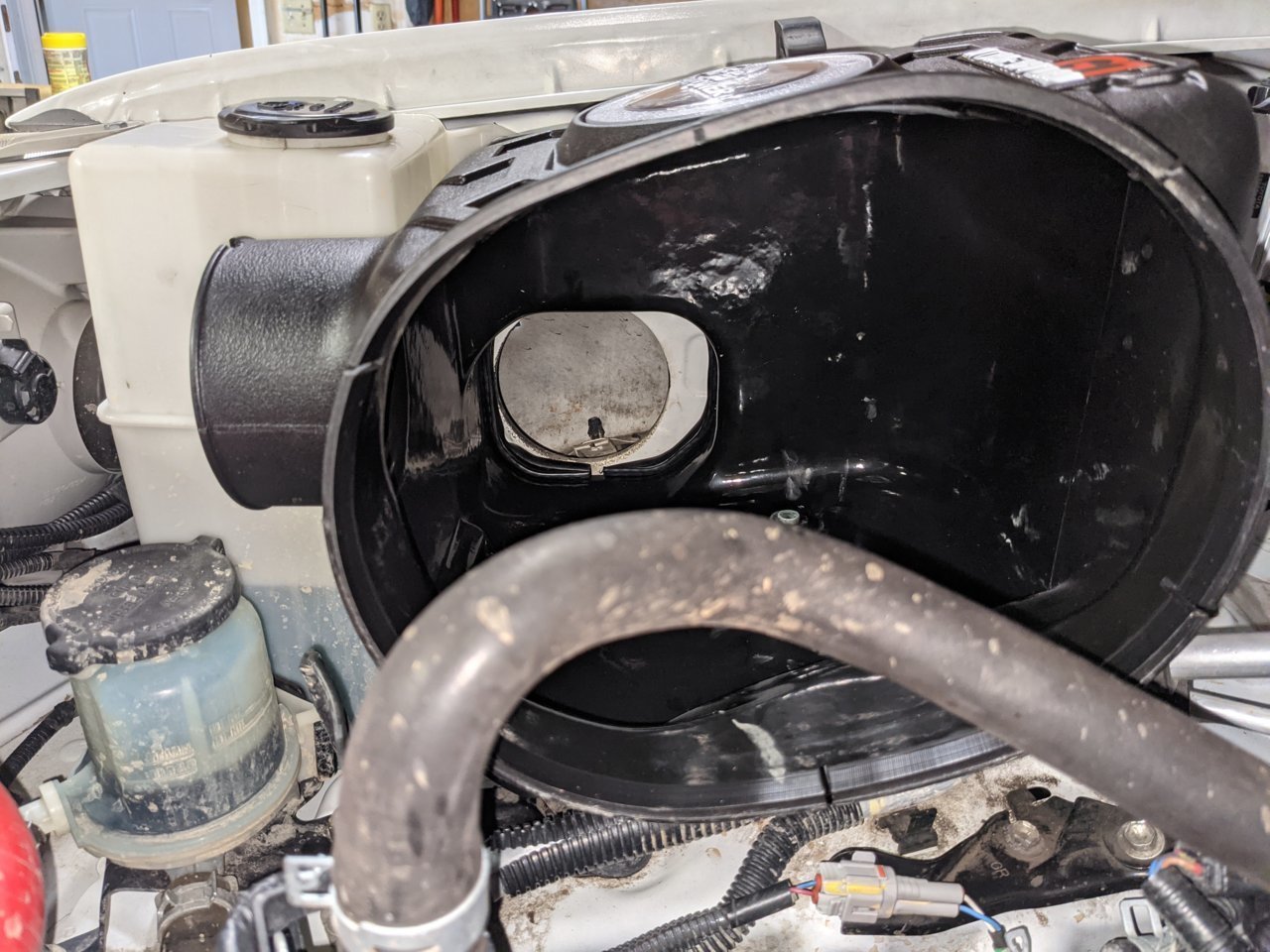

    Just linked this on the other thread, but ya AFE would definitely be the way to go. You can see how much better/larger the SABM is that they make. And the fender hole area seals up completely tight. Could even enlarge the fender side

    The enlargement alone wont be enough but I see it has an option for a front facing inlet. Finding room for the front inlet will be interesting.

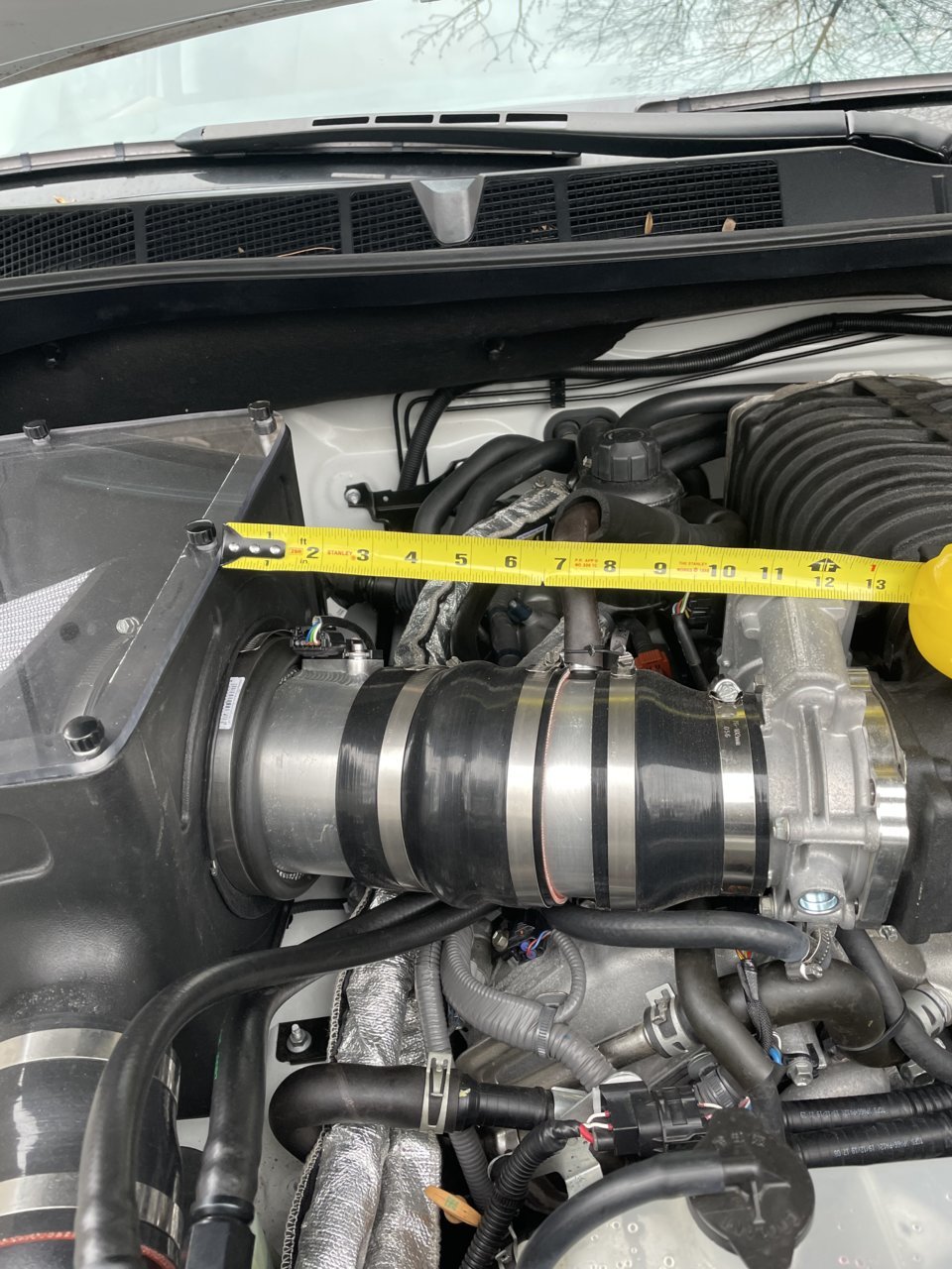

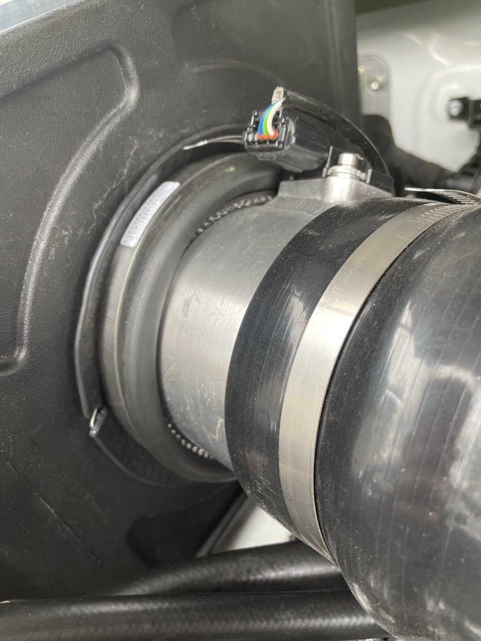

    Took some measurements and it looks like both the stillen and throttle body angle upwards at a total of around 40*. Hopefully the hump connection on maf/airbox side gives it that extra little bend needed and i can use a 45* 4.5" reducer to the tb. Ooorrr loosen the screws holding down the airbix a tad?

    Humps are only good for 10 to 15 degrees from what I understand.
    If it is around 40 you'll likely benefit from the 45 degree reducer you have in your parts. I tried using two 45 degree elbows, even when I cut them down to just the elbows and leaving enough material to clamp I was over length by 5 or 6 inches; the only option would have been to have a shorter filter which I don't think they make. Your part is a two in one reducer and elbow so it may actually save you space. You might even be able to go adapter -> hump -> MAF -> reducer elbow -> TB and put your fitting on the MAF tube after the MAF sensor.
    Another option could be to redesign the adapter to the Stillen box and give it some angle and/or extend it.
