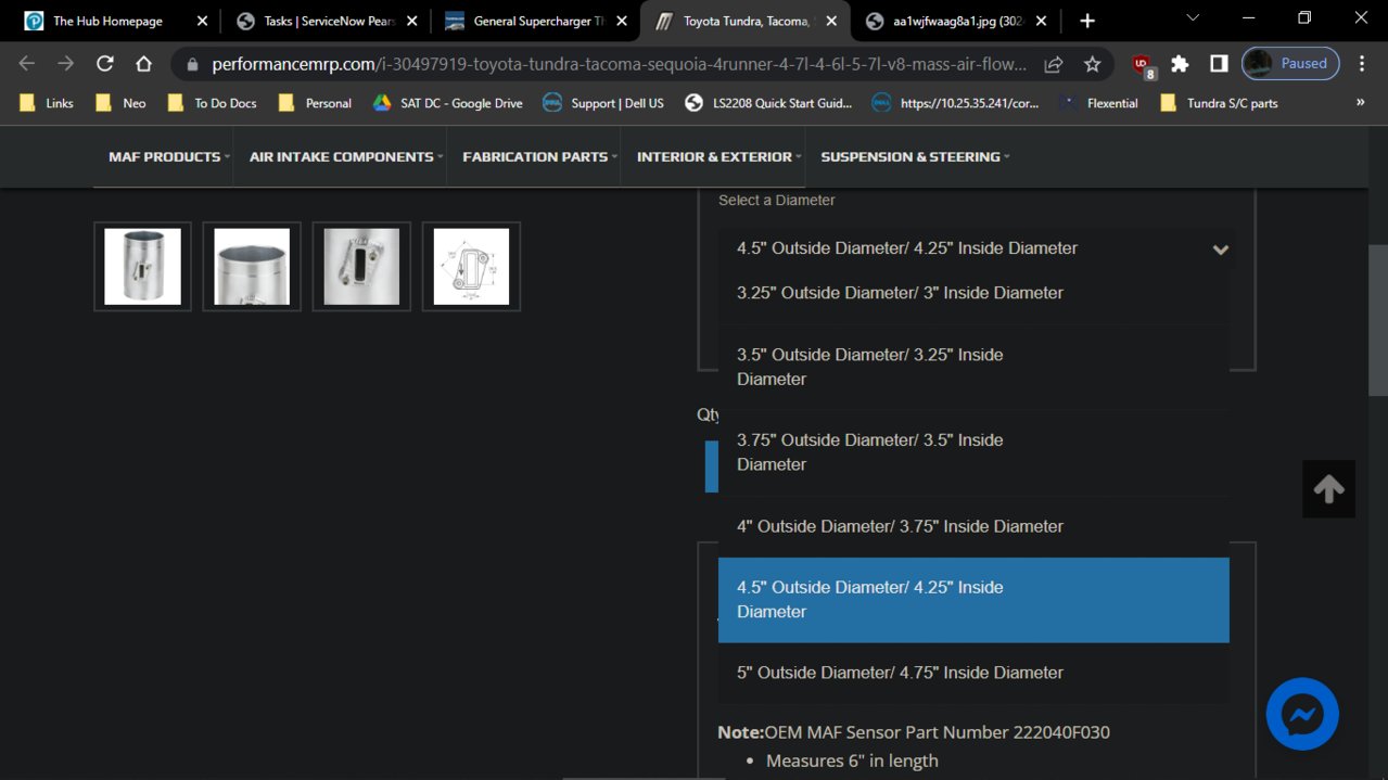

    Is the Prospeed a 4.5" INSIDE diameter or OUTSIDE?

    Outside I believe

    MRP and PS are both fairly close ID. Within an 1/16th or less; MRP is larger than the 4.25" they state on the site.
    Unless you get the PS airbox I think you'll have fitment issues since it the PS tube is curved at the filter end.

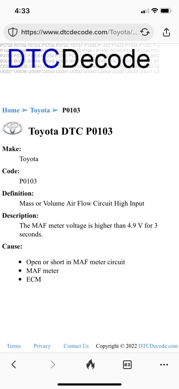

    In my data logging its at 4.97V, so one argument is do it since I'll inevitably trigger it one day. Other argument is get part of the $700 back and keep the superior albeit smaller Magnuson intake and if it trips the code it's once in a blue moon so who gives a shit.
    Which spelling it out the choice is rather obvious :D
