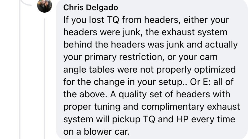

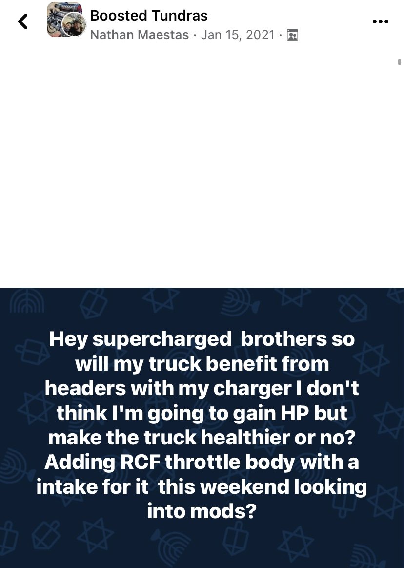

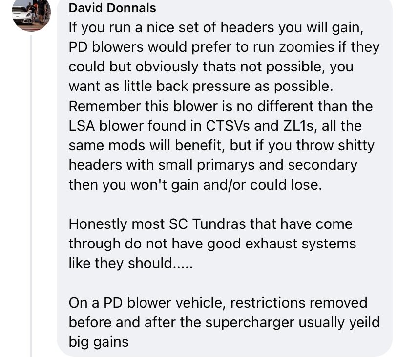

    So how does one gain with the headers? I got headers way before the sc kit, as I wasn't sure if there was ever going to be a kit for the 2020+ .

    It would seem to be that to get the most benefit you need to have good headers which you do, and then better flowing midpipes than stock as well as a free flowing catback. Lastly sounds like you need someone to tune it who knows how to properly set up the cam timing to optimize everything. I’ve read the peak gain isn't that huge but the gains are better other places throughout the curve with headers.

    Optimal exhaust wise I would think would be to get rid of the stock midpipes that neck down to 2” diameter inside. I know the one guy who just finished up his Prospeed build has ARH headers, midpipes with high flow cats, and just a regular TRD dual exhaust and he made 700+ hp and torque on 14.7psi with a Harrop. Fully built engine on E85 I believe. Tuner wise, I personally don’t really know anything about any tuners that have claimed to gain consistent power on LTs other than Prospeed and DAP.

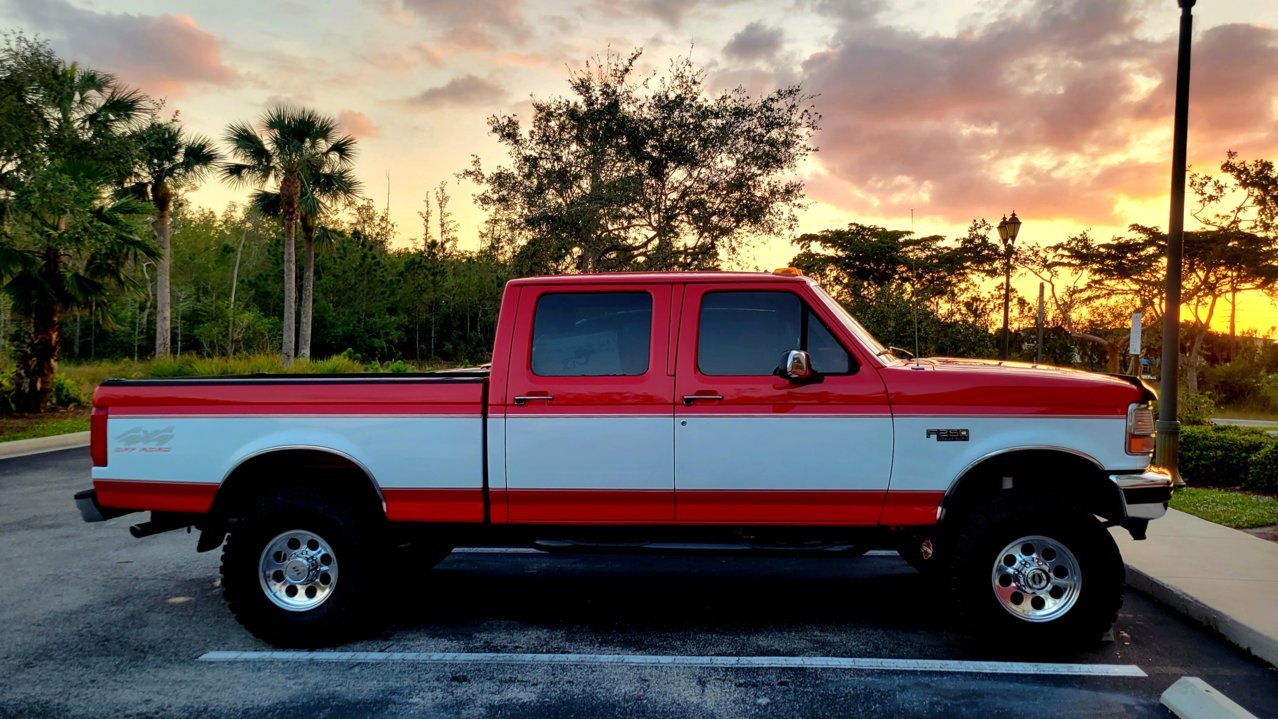

    I'll attach a pic of "our dearly departed" and my new pride and joy.
    It's a 97 F250 4x4 with the 460. Y'all think Tundras get bad mileage! This make them look like economy cars.

    First six mins of video confirms LTH should make more power:
    https://youtu.be/cxWl6WnUOAc
    other restrictions can rob them of their benefits
    B.Ross, Silver17 and M3Tundra-JK like this.
