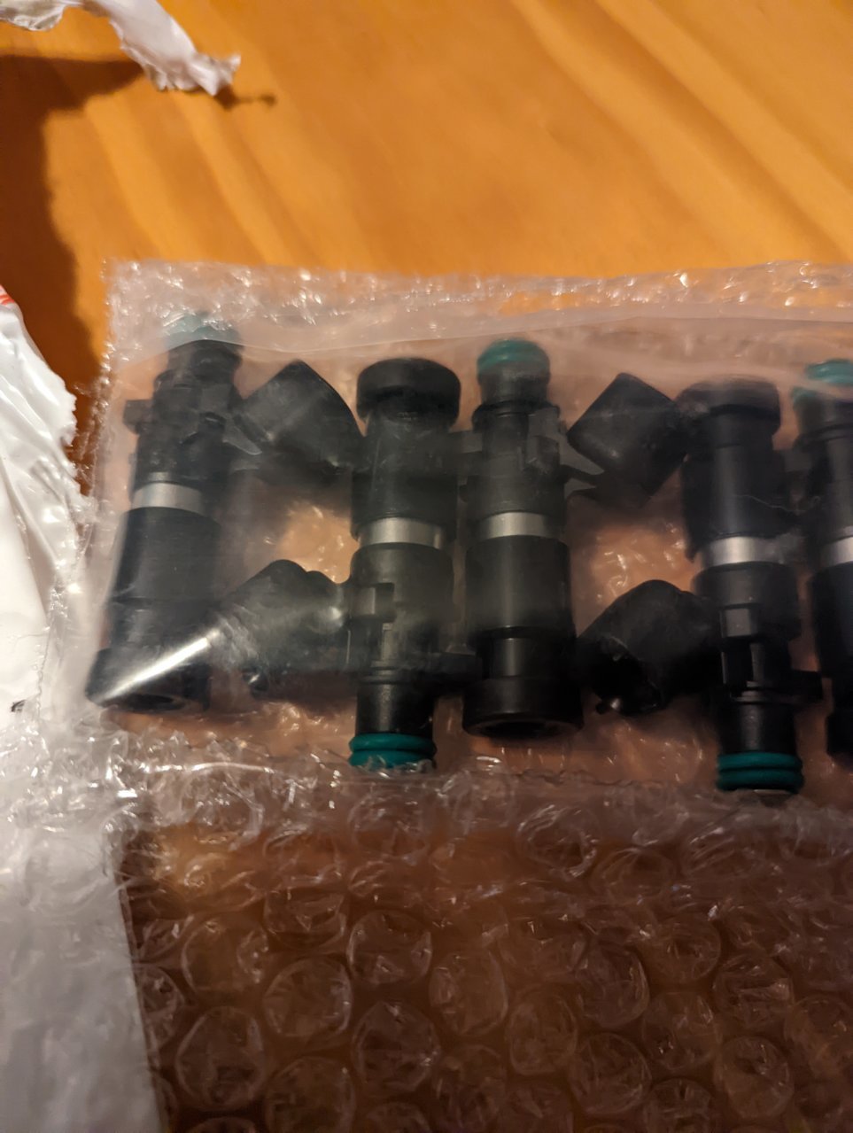

    I don’t like the looks of those PS injectors from the O rings, to the funky adapters, to the falsified flow rating. Seems like they don’t belong in the fuel rails but were made to work with some dubious modifications.

    What did you change? Might have to go backwards on installation until you hit a configuration that runs right, then reinstall things to isolate where the issue is coming from.

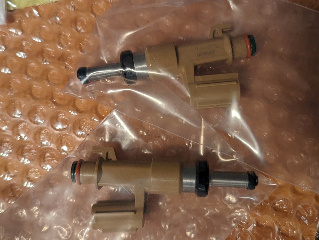

    Installed Harrop and Prospeed's fuel system and 4.5" intake. We're suspecting maybe an injector and/or rail is leaking somewhere. I'm assuming the shop did a leak test but they're going to put the oem injectors and air intake back in today and go from there.

    They found my injectors need to be rotated different ways to fit, also found one of the pins back out on the connector on cylinder one.

    Install of parts was smooth from the get-go. Turns out the local tuner who said he knew how to tune it actually doesn't and was pointing fingers at the installer. Hopefully next week it'll be finished up via Prospeed's remote service.
    Installer said he drove it and it was running without any issues but felt there's more power on the table after ~50% throttle at 60mph and the truck going sideways. That's exciting at least.

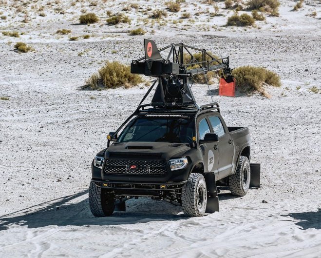

    Exciting news! A guy in Salt Lake City who had his long travel Tundra suspension tuned by my friend was told to call me if they wanted engine tuning; it's a super cool rig, all long traveled and has a giant camera crane and gimbal setup mounted on the roof. They also have a RZR that's similarly setup that my friend tuned the suspension on. Anyways, dude called me yesterday and I had no idea this was going to be a thing but it sounds like I'll be tuning their truck in the coming weeks :eek2: It's a stock magnuson and they have the TRD tune, so we all know how shitty that is. No AFR gauge so I told him I didn't want to fuck with it until they got that, even though I think if I just gave them my small injector tune they'd be ready to go. I told them about OTT and other tuning shops, and I'm just a dude with a garage, but for some reason he seems to want me to do it :confused: maybe it'll fall through and he'll go with someone else, but would be cool if I ended up tuning someone's truck :D
  12. Dec 16, 2022 at 8:29 AM
    #4572
    Downytide
    Downytide New Member
    Sep 3, 2020
    #51715
    1,900
    GTA
    Lunar Rock that whines
    we need more pix of that rig, asap.
    tell us what he runs, does he film while the truck jumps? how do they keep the ladies at bay?

    Pix: https://www.instagram.com/riot.motion/

    Awesome!
    Killer mudflaps too

    Dude! That’d be sweet. Awesome rig setup. That camera is more than that truck lol. Looks like a camburg front LT kit

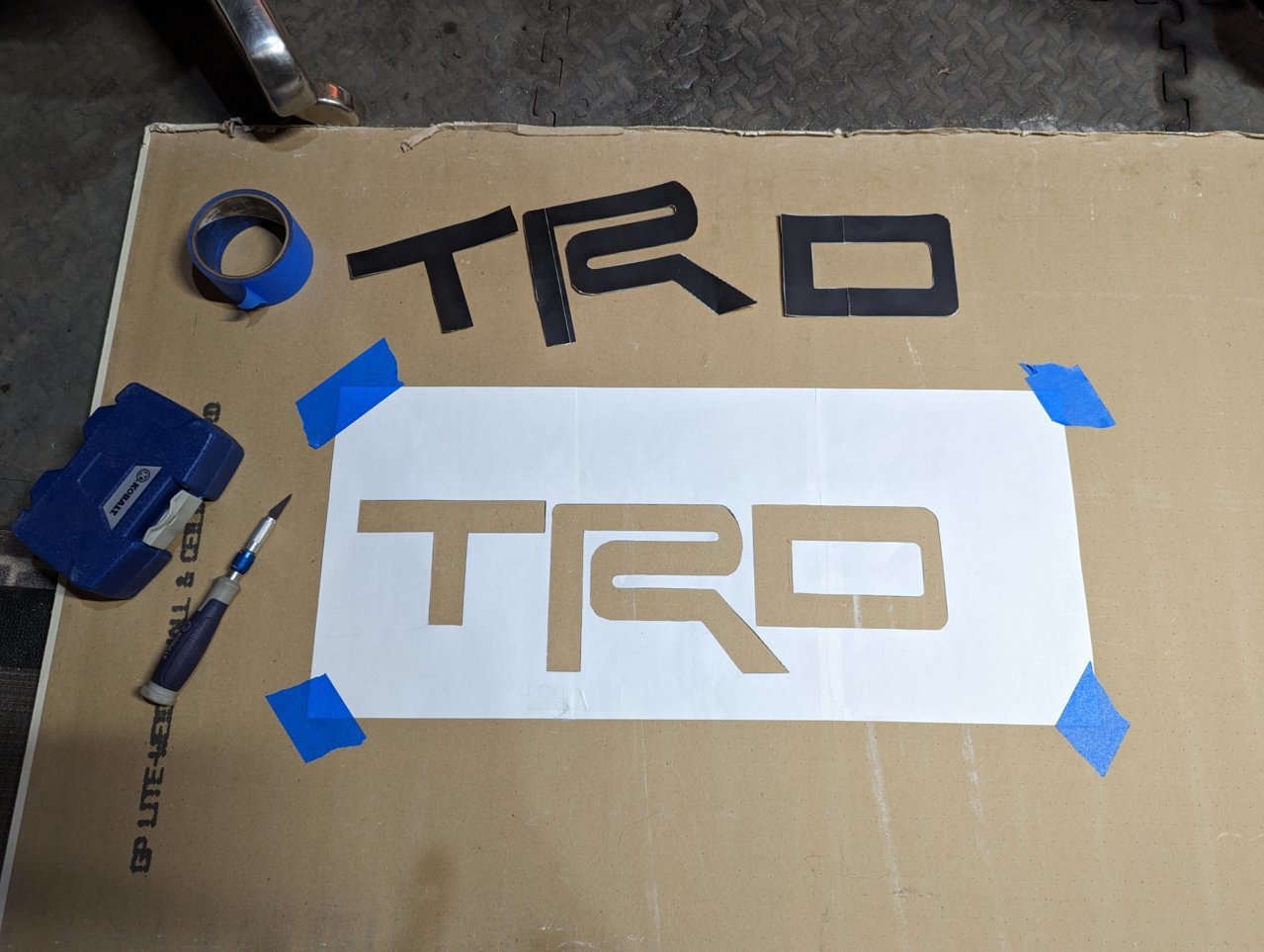

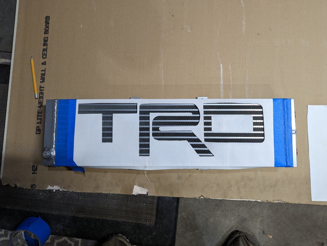

    Arts and crafts with the intercooler. Just gotta go get the paint

    This is going to be SIIIIICK!! Nice work Scott!!
