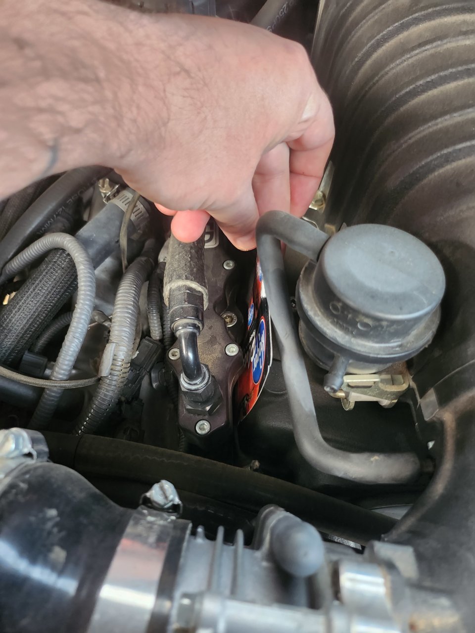

    Anyone else on here running Prospeed's billet fuel rails? Truck runs great with no CEL but we're seeing low knock sensor values and we noticed the fuel rails are contacting the supercharger. Thinking maybe it's causing feedback into the block via the rails and messing with the knock sensor. Hopefully hear back from Prospeed tomorrow.

    No, they just aren't seeded in the intake properly. Not tight enough, hopefully an easy fix.

    I am also running them with no issues...I'm wondering if something isn't lined up correctly, or a injector insulator is squished in the hole wrong (those are tough to get lined up)? The rails should only be making contact with the nylon spacers and the injectors, not the SC.

    Are you running a Harrop? Anyway you can take a pic of your clearance? Thank you sir!

    I am, I'll see if I can get a pic this evening.

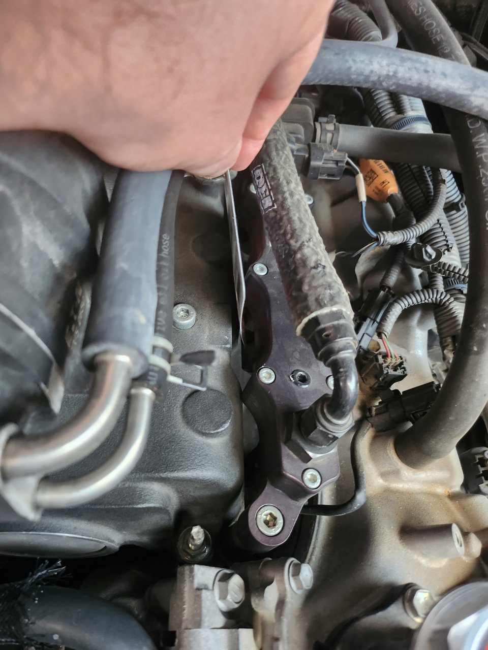

    It's tight, no more than a credit card's thickness everywhere it bulges (yes, I checked them all), but it's not touching. I can slide the card in without resistance and it holds like a feeler gauge.
    Left side:

    Great, now if you could just try a few different credit cards, and show us them front and back so we can get a better idea. Details matter.

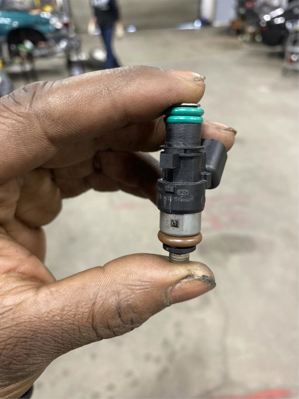

    If you make more of the assembly's, send me 1 (one) and Cerakoat it black for you, pay return shipping. You won't need to worry about corrosion

    I could be wrong, but I don't think the ProSpeed 750 injectors get two o rings at the factory fuel rail. I think they were installed wrong, that's why I'm having an issue with cylinder one.8f1108f1f274ceca7c468dc1ecabe3b98e4d1835cbef21d4cbb9ca2e81c6b236.jpg

    That's how mine were too. It seemed a bit janky but I sprayed them with WD-40 and sent it.

    That's how your injectors came? Looks like only two total on my set and not that third one on the other end. Five-O's look a lot different

    The spacers at the bottom of the injectors are in the intake, I believe the o ring is under that.
