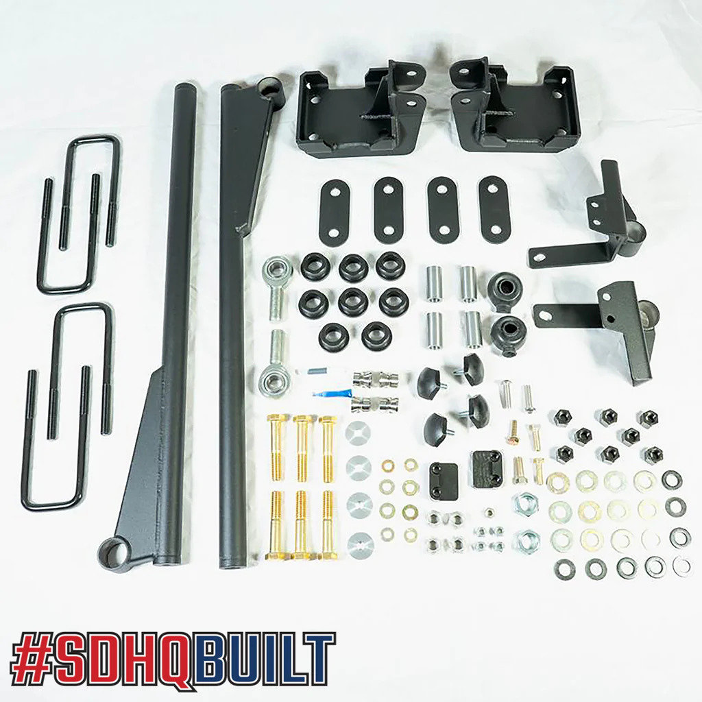

    Caltracs traction bars are NOT made to be constantly driven on rough roads.
    Both sides constantly clatter now.
    I've tightened them so many times it's gotten old.
    I will now move to SDHQ's.
    here's the deal now...when I turn right into my driveway, i get a big clunk from the right Caltrac. I think it's that damn front leaf spring bushing mount thing. Caltracs has you remove the urethane bushing and press in an aluminum bushing. I think I hammered it out of shape by daily driving in our warehouse yard (working rail yard).
    It's comical how rough our yard is.
    driving on a smooth road is great.
    nags likes this.

    SDHQs also do this we just had the old man’s rebuilt after a couple years of use. The ends needed replacing they’re a Currie Jonny joint style.

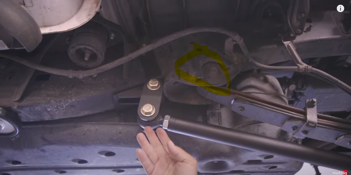

    I circled where my Caltacs mount. I think that joint is shot.
    This is from the MOTOIq youtube.
    That SDHQ mount look rightous.

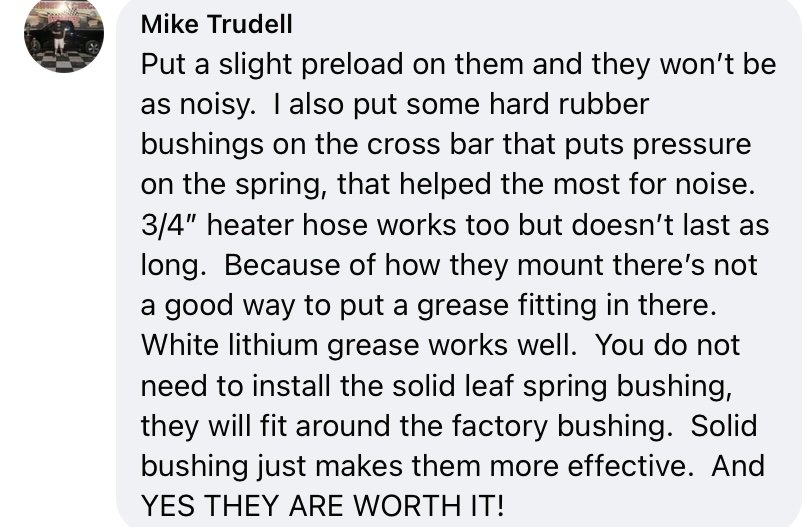

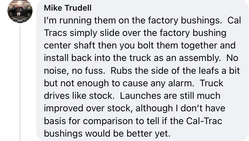

    Some these comments from a guy who has done so on Facebook. If you’re on here, thanks for the tips Mr. Trudell lol
    nobodyintexas[QUOTED] likes this.

    Looks like a combo of different ends bushing,heim,jonny joint. He had a some annoying creaking etc We tried tightening all the leaf areas etc. Ended swapping all the traction bar joints and no more noises.
