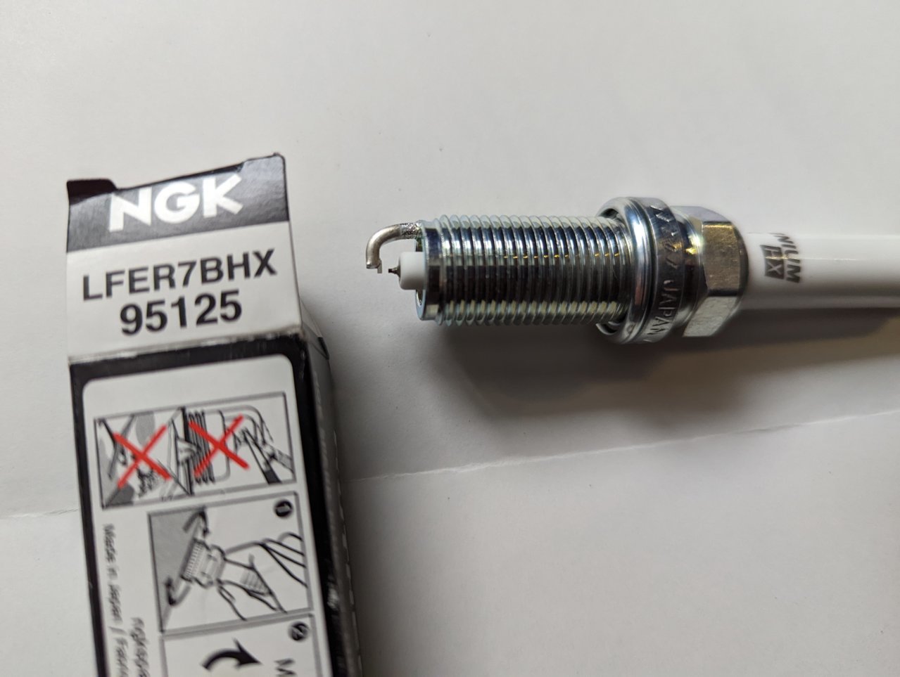

    They said the compression blows out the spark and causes a misfire. But no they came gapped at .029. Figured that was already on the lower side so trying plugs for forced induction might be worth a try. It feels exactly like when I maxed out the air. Real violent and jerky.
    Silver17[QUOTED] likes this.

    Nvm NGK doesn’t make a ruthenium for our truck in the required heat range. Their ruthenium plug would be equivalent to IKH 20 according to denso’s heat range comparison chart. So I’m going to gap these 24’s down to .021 and see what happens.
    snivilous[OP] likes this.

    What about the NGK TR6? We used to run those in the lightnings and cobras zero issues. Not apple to apples but similar boosted applications

    @HonorNotInner this is the Ruthenium part number you want, with the extended tang thingy. the forced induction specific verions. the other version has no extended tangy
    HulkSmurf14 likes this.

    Never looked into it before but checked on the part number I ordered and it's NGK7, equivalent to the IHK 22

    NGK told me that P/N wouldn’t work for my truck. He said something about something being hollow shell I think. There’s another part number that they have that matches the tundra but it’s for heat range 6 on their site and he told me that plug would be too hot.

    I guess we'll find out! I have them waiting to go into my Tundra. I've no idea about the hollow shell thing...I just know that the Tundra and Tacoma use the same spark plug for boosted apps, and that this is the Ruthenium part number myself and others on Tacomaworld swapped over to with beneficial results.
