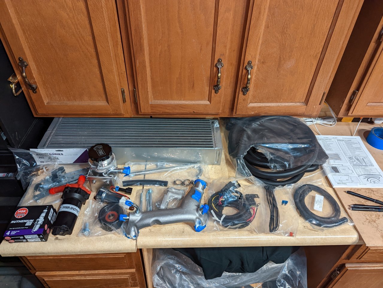

    Fit kit inventory check in. Soooo close I'm drooling
    Jcmf52, nags, Black@Blue19 and 6 others like this.
