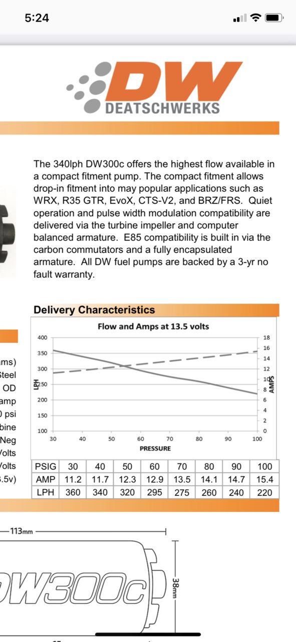

    Viktor told me to go to the 450 since I had a 340 and he said it wasn't enough with the Magnuson equivalent pulley you have. Though making the fuel lines parallel certainly won't hurt anything.

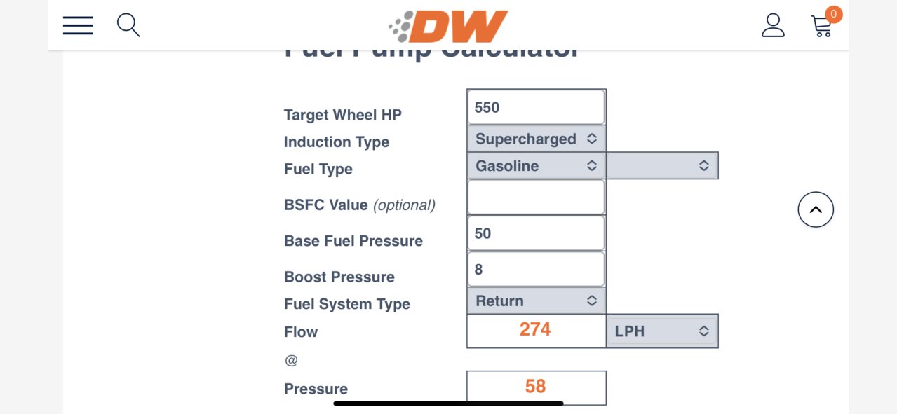

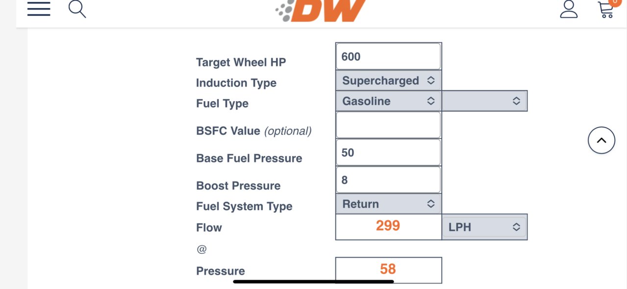

    If you skip the fuel lines and only change the fuel pump to a 450 and try it again please report back if that got you where you need to be. With the Harrop kit using a boost referenced FPR that runs around 50psi at the max it would seem the DW 340LPH would be right at the max of its rated capabilities at 600Whp if I’m looking at this calculator and chart correctly, with a little buffer at 550Whp.
    Edit: not sure how to interpret the “Boost” portion of the calculator though. Not sure if that’s referencing the boost from the turbo/blower which honestly doesn’t make sense that it would need that, or a boost pump which in that case I am using the calculator wrong on the calculations.

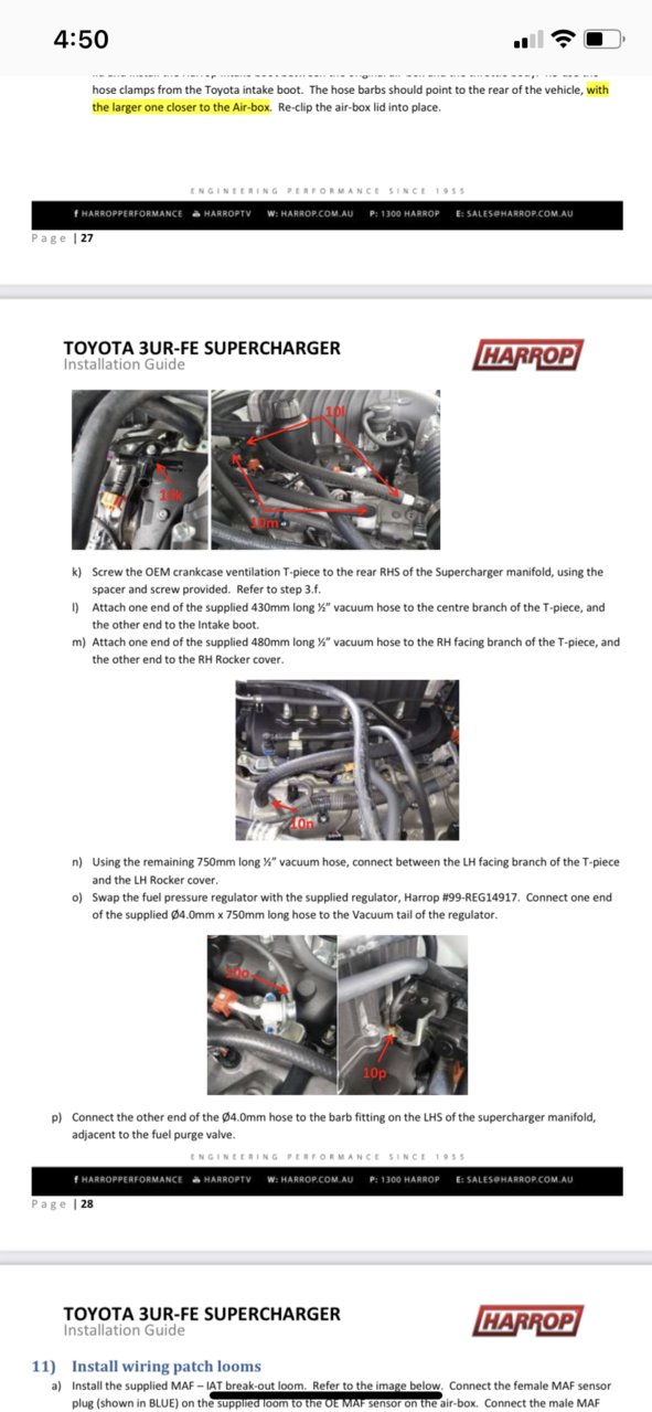

    The Harrop kit comes with a factory style FPR that is modified to increases the fuel pressure and when hooked up as per the install directions for stage 1 is boost referenced. I left it that way going to stage 2 as well.
    Edit: reference steps O and P from the install guide shown here.

    I’ve got the 650’s and I think it’s going to be cutting it kind of close. Been seeing 90% duty cycle. I tried doing a log yesterday with the new 450 pump but when I got into WOT the truck did some weird shit where it felt like it cut fuel. So I told OTT we should wait till I get the fuel lines and pressure regulator hooked up today or tomorrow. I’m not 100% sure which line that boost/vacuum line on the regulator connects to.
